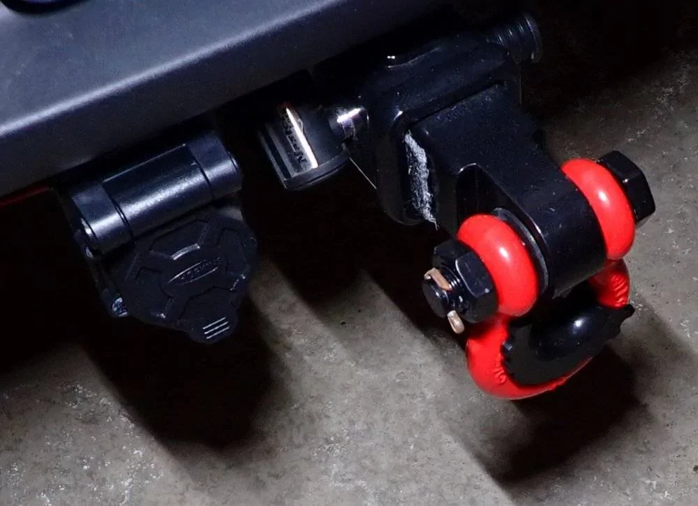

Before I would buy a camper, thinking of renting off Outdoorsy. I noticed that some of the teardrops within the weight limit require a 7 pin plug, so they have brakes. Anyone have a great solution for that? I have factory tow but it’s only 4 pin.
I used this from etrailer https://www.etrailer.com/Trailer-Wiring/Tow-Ready/30717.html as it uses the existing 4 pin for brakes and lights and added the 12 volt charge line up to the battery to charge my teardrop's battery. Works fine with my Curt wireless controller.

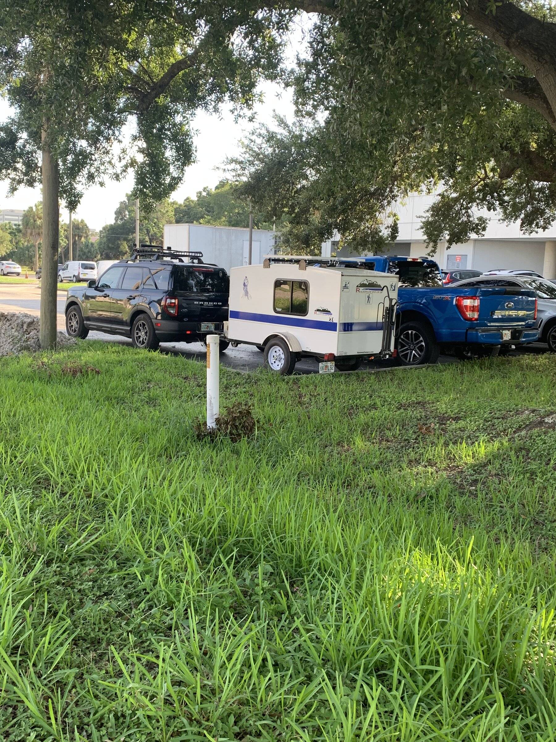

what is everyone pulling? Would like to find something that can handle 2 adults and 2 Young Kids that has a bathroom. Not many options that are light enough .
Pulling a Runaway 4x8. They make a larger version 6x8 that has plenty of room for multiple people. I use a shower/ potty tent and a porta potty. Watch your weight. These babies only come with a class II HITCH. And sway will be your undoing with an overweight camper. Only 4pin electrical, so the Bronco brakes are used to stop both.

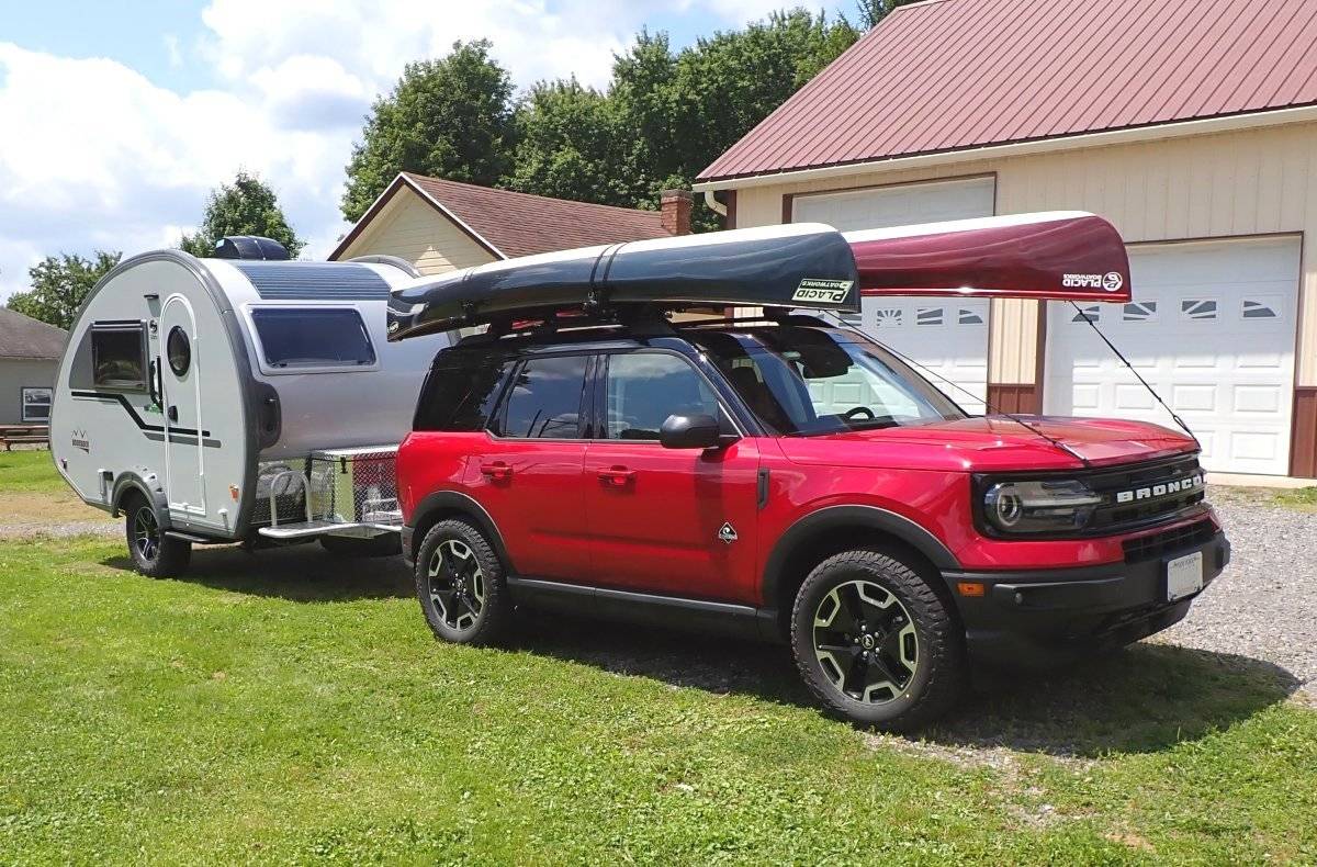

Wound up with this teardrop last year at 1,850+ Lbs so packing light and towing at max keeping it under 65. Does just fine in the hills but wouldn't tow it in the Rockies. Added a gauge for monitoring engine and tranny temp.
