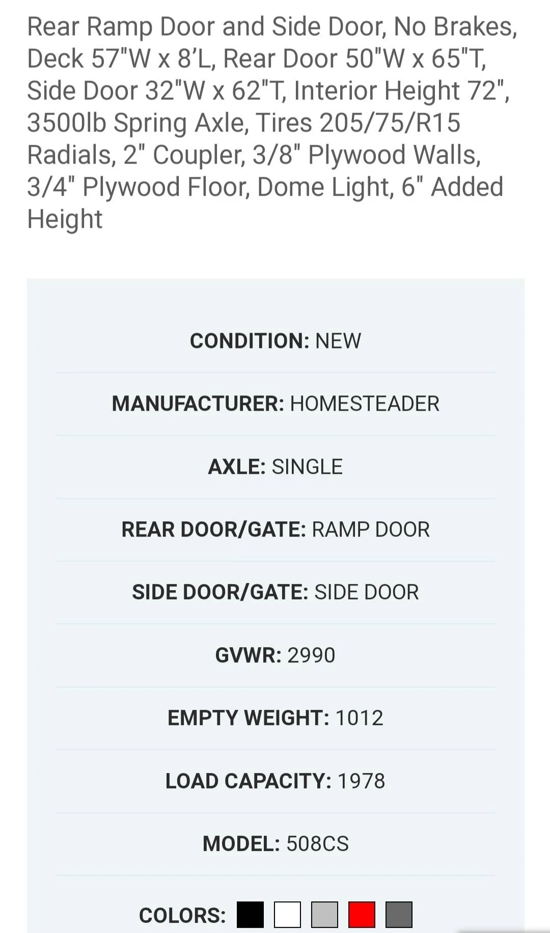

It's not a camper but this cargo trailer pulls very nicely behind the Badlands. Recently bought and glad we went with this size.
Before anything is said, yes for the Bronco Sport we can only add a little over 1,000 lbs to keep it at the 2200 lb limit. We will tow this with our truck for a heavier load.
It was a 2 hour drive pulling home behind the Badlands.

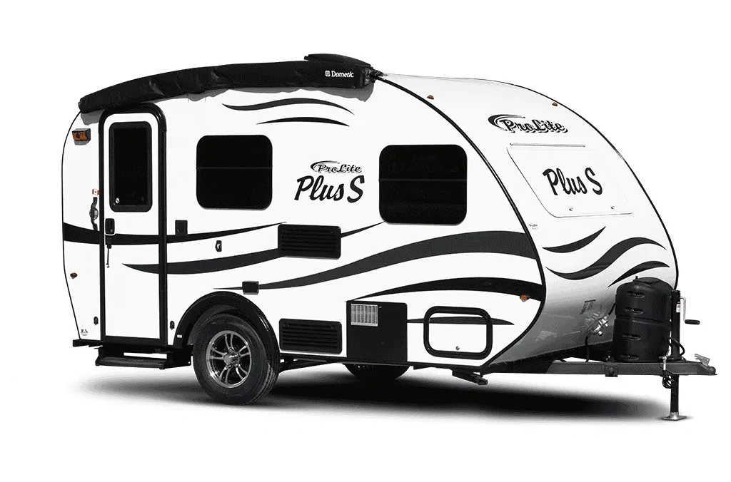

ProLite PlusS (1390 lbs) Sleeps 2
Ford Bronco Sport Anyone pulling camper? 1647003632994

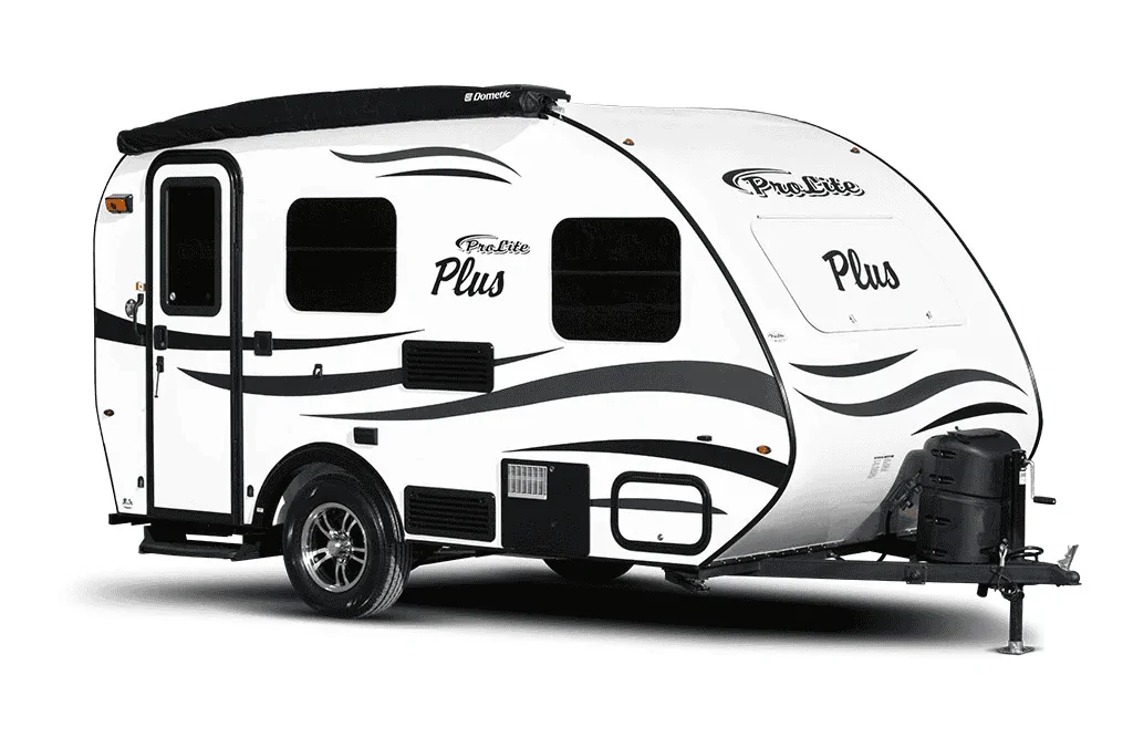

ProLite PLUS (1590 lbs) Sleeps 2
Ford Bronco Sport Anyone pulling camper? 1647003722599

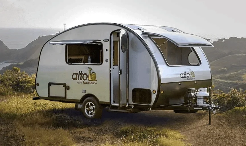

And, Alto Safari Condo F1743 (1765lbs) Sleeps 3-4
Ford Bronco Sport Anyone pulling camper? 1647004228865

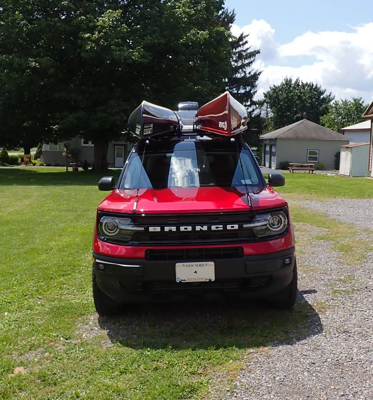

Bronco Sport OB, Maverick 2.0 XLT
We travel light. Don't carry water when towing. Battery is moved inside so not on tongue. Tongue weight is at 180 lbs. Tows just fine. Have gauge for both engine temp, transmission temp and horsepower. Factory tow package is required as the transmission is the weak point, not the engines and needs the larger cooler. No problems towing in the East. Wouldn't tow it in the Rockies. Been packing and towing trailers of all sorts for many years. 2,000# trailer on the Sport is not a problem as long as it's packed correctly, you keep it under 65, has a properly adjusted brake controller, and is not a large profile above the Sport.
