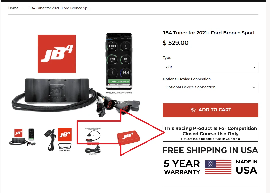

Ford Bronco Sport Anyone install a tuning kit? Screenshot 2023-05-02 135229
There are several places for turners. I have run cobb for years. This place has covered itself with the racing box.
