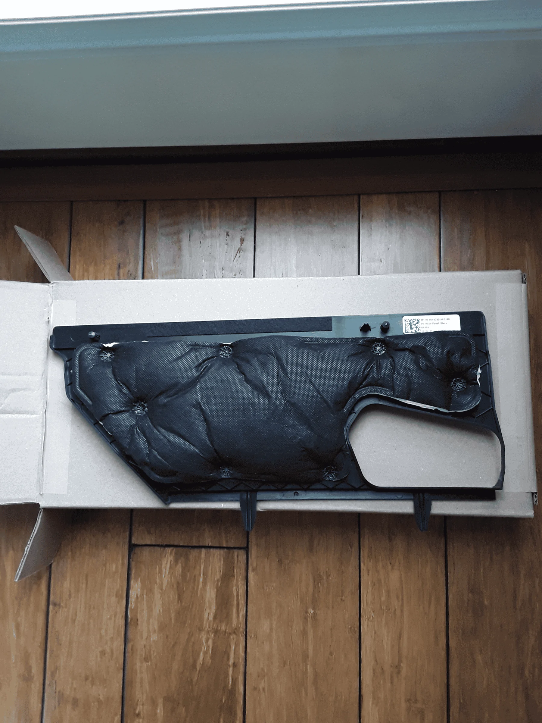

Dealer provided replacement today
pics included for parts no. and description

Thank you for providing pics with part #'s. Major Kong. I got my panel today from Danvers Ford in Massachusetts. I called my salesman a couple weeks ago and texted him the pics posted by Major Kong. He said he was going on vacation but said he'd follow up when he got back. During the week he was out I got a postcard from the dealership service dept telling me my panel was in. So he obviously got it taken care of before he left.
I picked it up today and had zero problems. It was covered under warranty and they were 110% helpful rather than resistant like some others' experiences with the dealers they went through. The funny part was that the parts counter rep told me that in order to give me the new part under warranty I'd have to give him the old part. I said "It never came with the old part! That's why I'm here!" He laughed and handed the package over to me.

Sales rep called me last week to let me know the dash panel part had finally arrived after two months. We worked out a deal where the part would be installed when I bring the car in for an oil change/routine check. I have over 6500 miles in 3 months of driving the BS Big Bend (lots of 3-5 hr trips and a long trek over to Memphis and back). Oil change and dash panel part installed today. No charge for the part as the dealership covered it under warranty. That's the way this situation should be handled at all dealerships!!! Since Ford Motor Company has never mentioned this issue to the purchasing customers, FMC knows they tried to screw the customers. The squeaky wheel gets the grease on this issue. I suggest all BS owners push their respective dealerships to obtain and install this dash panel part!!!
Wow... this part is definitely supposed to be there, and there is a HUGE difference between using the vehicle with the part and using the vehicle without the part. The dash panel muffles the sound of the A/C system to the point where I can now listen to the radio at level 8 with the A/C running on max air at highest fan speed. Without the part I had to turn up the volume level to 15-16.
