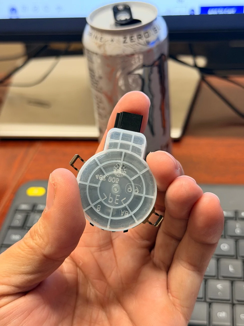

Interesting. Because your writing on the sensor is also at an angle, whereas mine is straight across.
Ford Bronco Sport Add Auto-wipers?  "WORKED!" IMG_3971
they are different part numbers also yours is a Lu5t the black one is a Lt7T (thats what it looks like for my eyes.)

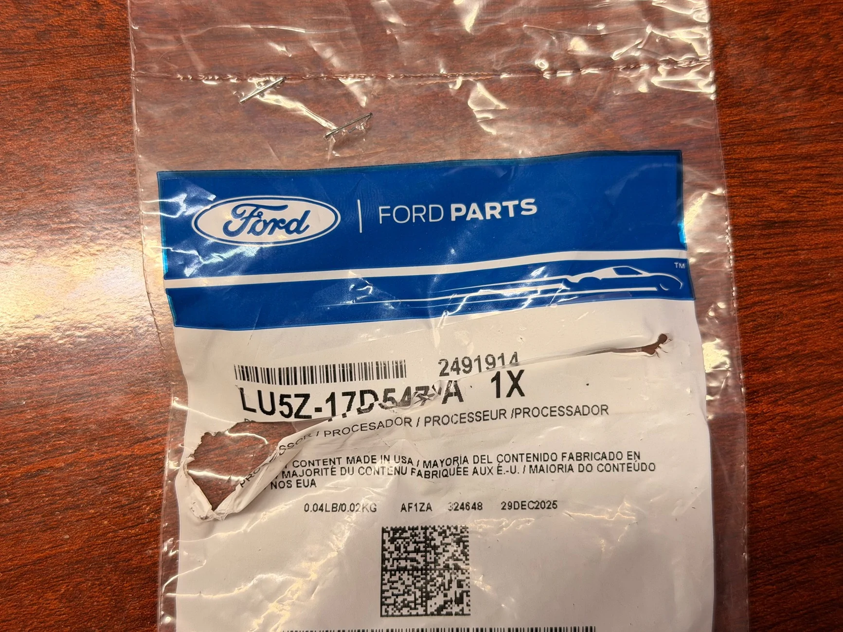

The correct part number is LU5Z-17D547-A.
The clips are loose!
Take it out and put it back in crooked. :muscle: :muscle: :muscle: :muscle:
I decided to keep this as OEM as possible. I ordered the proper electrical connector (which cost more than the sensor) as well as the wiper stalk.

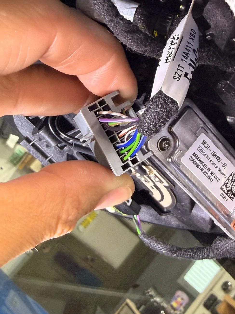

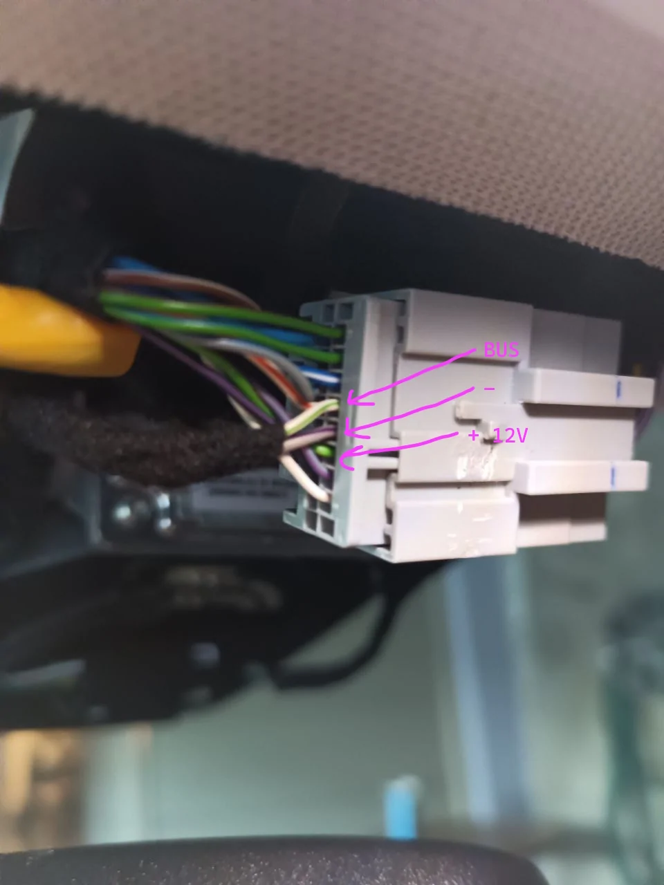

I’m finally getting around to finishing this up… my overhead connector only has two spaces in between the blue and white stripe wire and the green and brown wire. According to your photo, the green and brown one was added for supplying 12v.
I do have, on the other row, and blank opening, with a corresponding pin on the male side.
Ford Bronco Sport Add Auto-wipers?  "WORKED!" IMG_5283
I think the correct photo is the one of the other connector, :crackup: . The one on the other side.
You need to put the 3 new wires into that connector and connect them to the sensor.
We understand by "another connector" that one is the male and the other the female.
