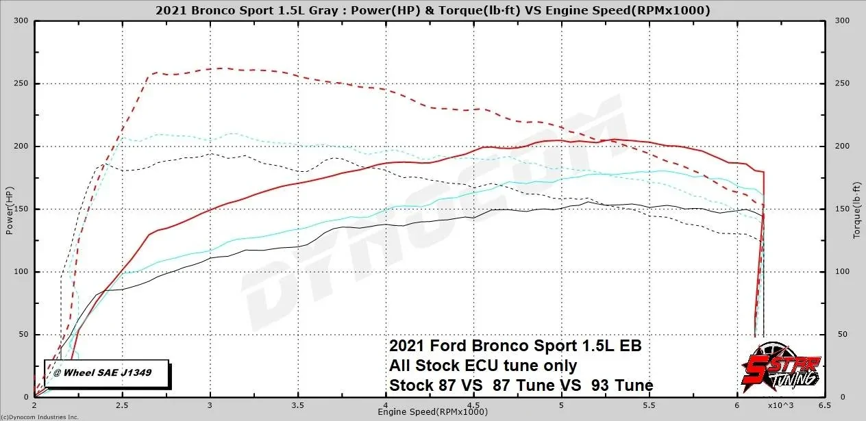

I emailed 5 star about tunes for my SCT BDX tuner to use on my BS and they emailed me this dyno sheet. Very impressive. Stock is about 150hp and 195lb ft to the wheels and the 93 octane is 205hp and about 260lb ft. That is incredibly impressive. Even the 87 tune gave gains of about 25hp and 30lb ft. I'll be ordering a few tunes including the 93 in the near future and I will report back here with my impressions.

Very interesting?
I actually got around to plugging in the BDX and getting the strategy info the other day. Will be ordering the tunes within the next month and will report here on the results.

Awesome. Keep us posted :)
I'm okay with getting premium gas to make this happen.

Ok I got the tunes. Had a couple issues initially with the tunes not actually loading into the vehicle. 5 star was awesome and worked with me and got it fixed. First tried the 87 tune yesterday. Immediately noticeable change. Feels kind of like sport mode performance wise but does not hold the gears like sport mode does. Another thing I notice is that it doesn't lug as much, meaning it does not get to such a low rpm while cruising that it has that vibration. Idle at stoplights seems to be a little higher to prevent the same vibration. Downshifts seem a little easer to achieve too. This morning I loaded the 89 octane tune but haven't driven it. I will run this tank down and then fill with 91 and try the 91 tune in a couple weeks.

Currently running the 91 octane tune since early summer. Kind of a bad time to run premium all the time but I have had it for 10 months now and only have 6000 miles so I don't really drive a lot. For some reason I had it in my head that premium around here was 91 octane so that's what I chose. It is actually 92 at most places so I am going to see if they can revise this one for 92. Not sure if it will make much of a difference though. I can say that the gains are very noticeable. Particularly torque off the line and the general availability of torque when you need it. It always feels like the turbo is spooled up and ready to go. I wish I had the ability to drive a badlands as a comparison to see how close these tunes get it to the feel of the 2.0's performance. It is definitely faster than our Passport which is a 280hp V6 but it has 4200 pounds to haul around. Gas mileage is about the same, 24-25 around town. Last weekend did about a 400 mile round trip to Auburn and got 29 mpg for the trip at about 77mph most of the time. Even the 87 octane tune had noticeable gains but I am going to just keep the 91/92 tune on for the forseeable future.
