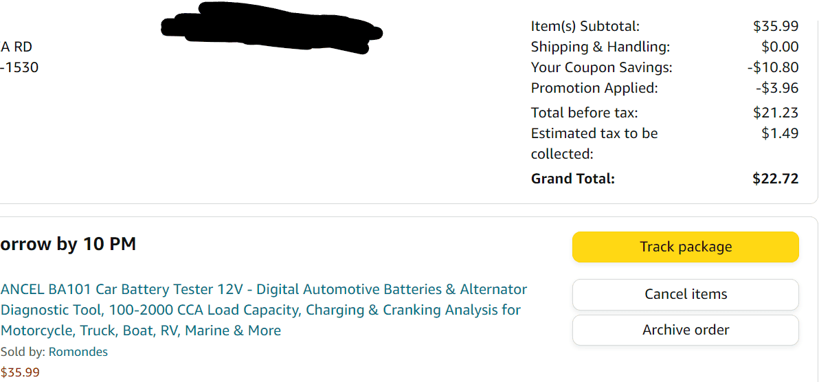

Was about to choose one of your amazon rec's here, when this flashed across the bottom of the screen. For $22, I thought maybe it will do the trick. We'll see.

I have compared voltage readings from these with my Fluke VOM and they generally agree. I saw some comparisons of these with load testers on YouTube and noted that load testers sometimes were giving different results but the load testers were wrong. These will not work with lithium batteries but there are other models that can test lithium batteries.
