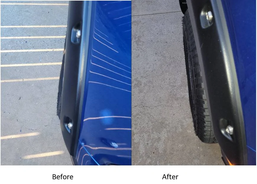

Alright, figured I would share my before and after pics.
Here's my pony with 25 mm Titan Wheel Spacers that I referenced above:
Ford Bronco Sport 20mm wheel spacers installed Titan Wheel Accessories 25mm Spacer Before and After 1-13-23
Bad camera work, but I think you can see that the tire protrudes abit now where as before it was about an inch in. The overall look is much more aggressive.
For me, I didn't notice a change driving, but the car has under 250 miles on it and I am still getting used to it so maybe there is and I just can't tell a difference.
Thanks to everyone here for the advice and feedback, am loving this community.
RR
RR
Thanks for the before and after shot! I ordered my Titan 1" spacers and they arrive tomorrow. They were on sale. :) Discount Tire will be installing them Saturday with no problems. The rims ordered from Discount Tire I wanted to have more of a negative offset since I too have the Bushwacker flares. I'd rather have the wheels stick out some, rather than in. I'll try and post my pictures too once done.
