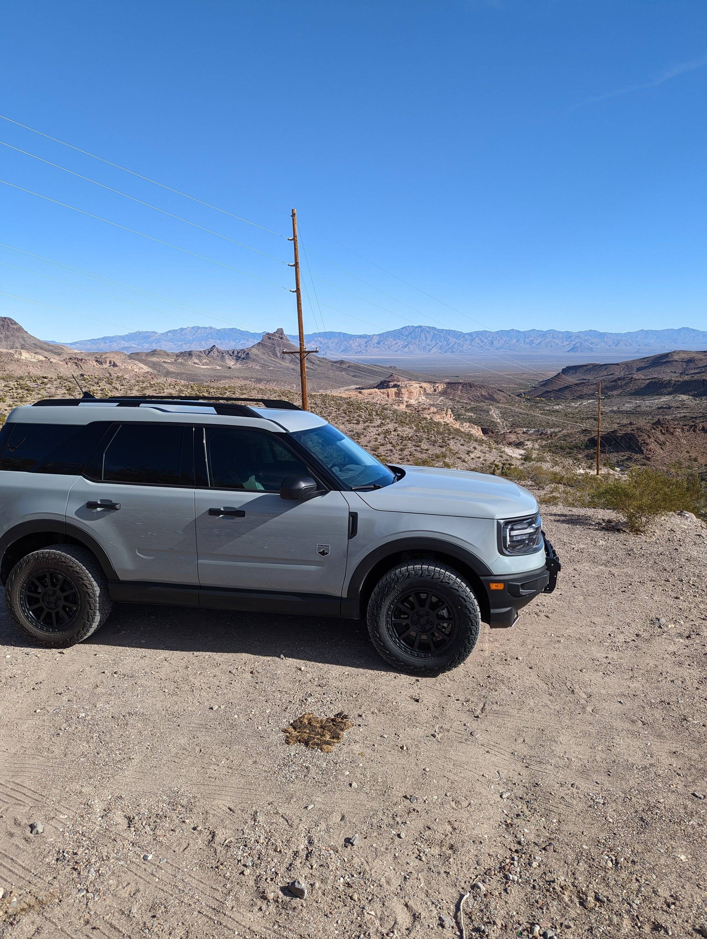

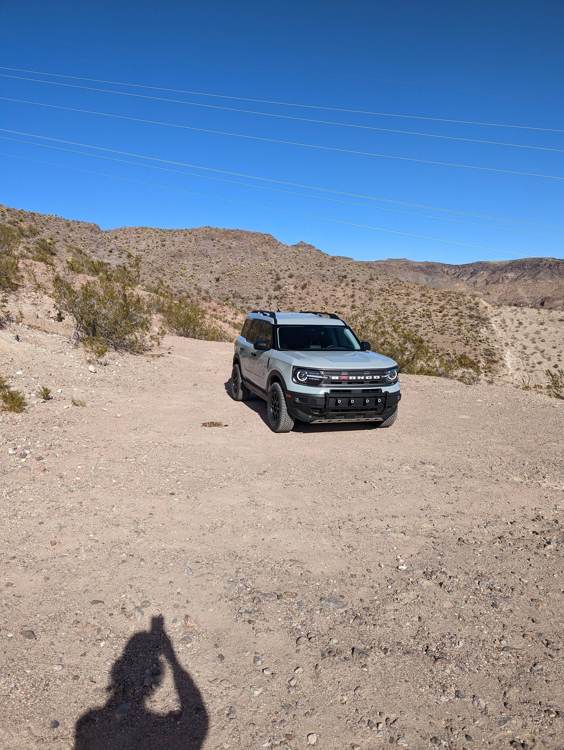

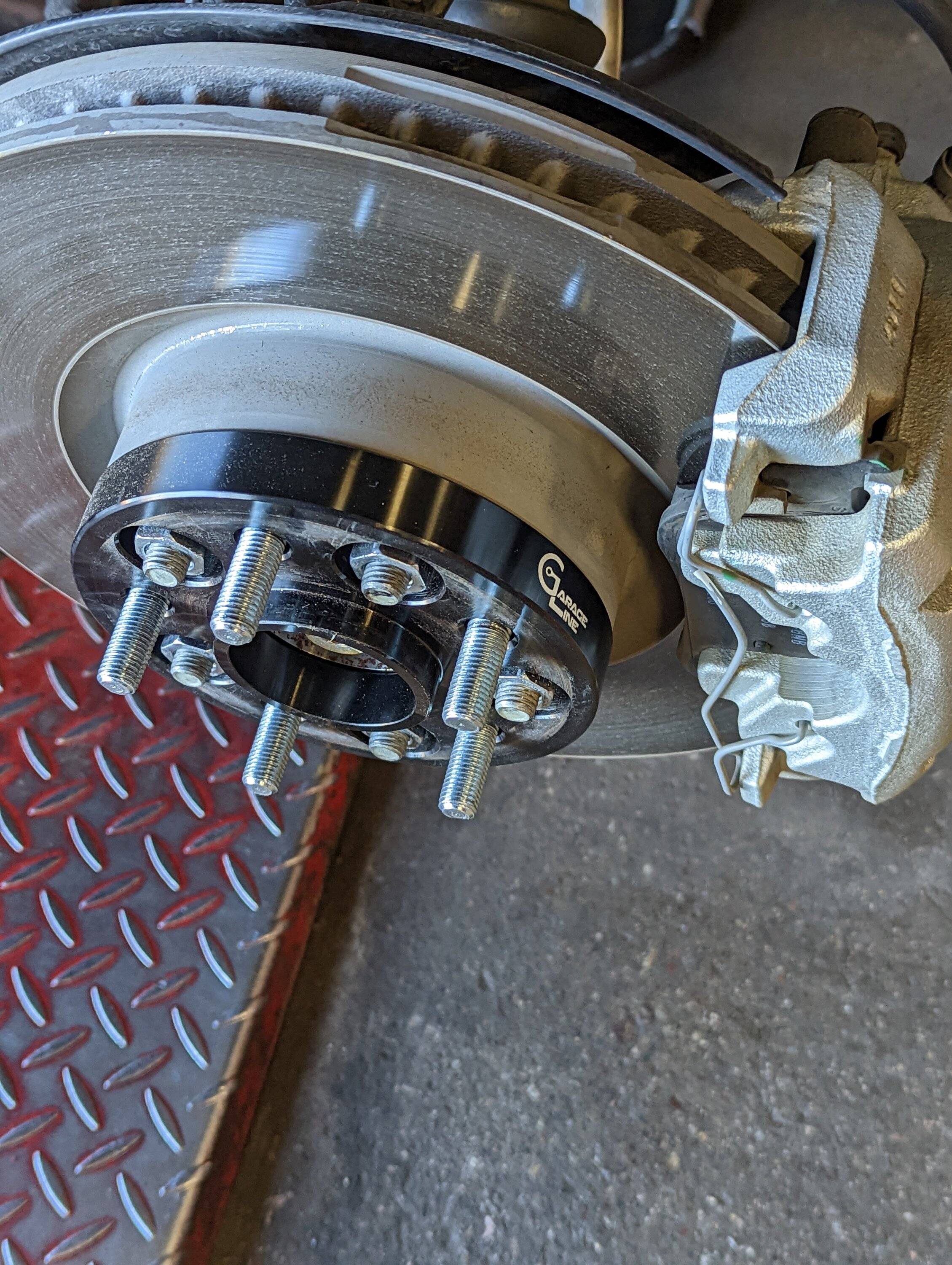

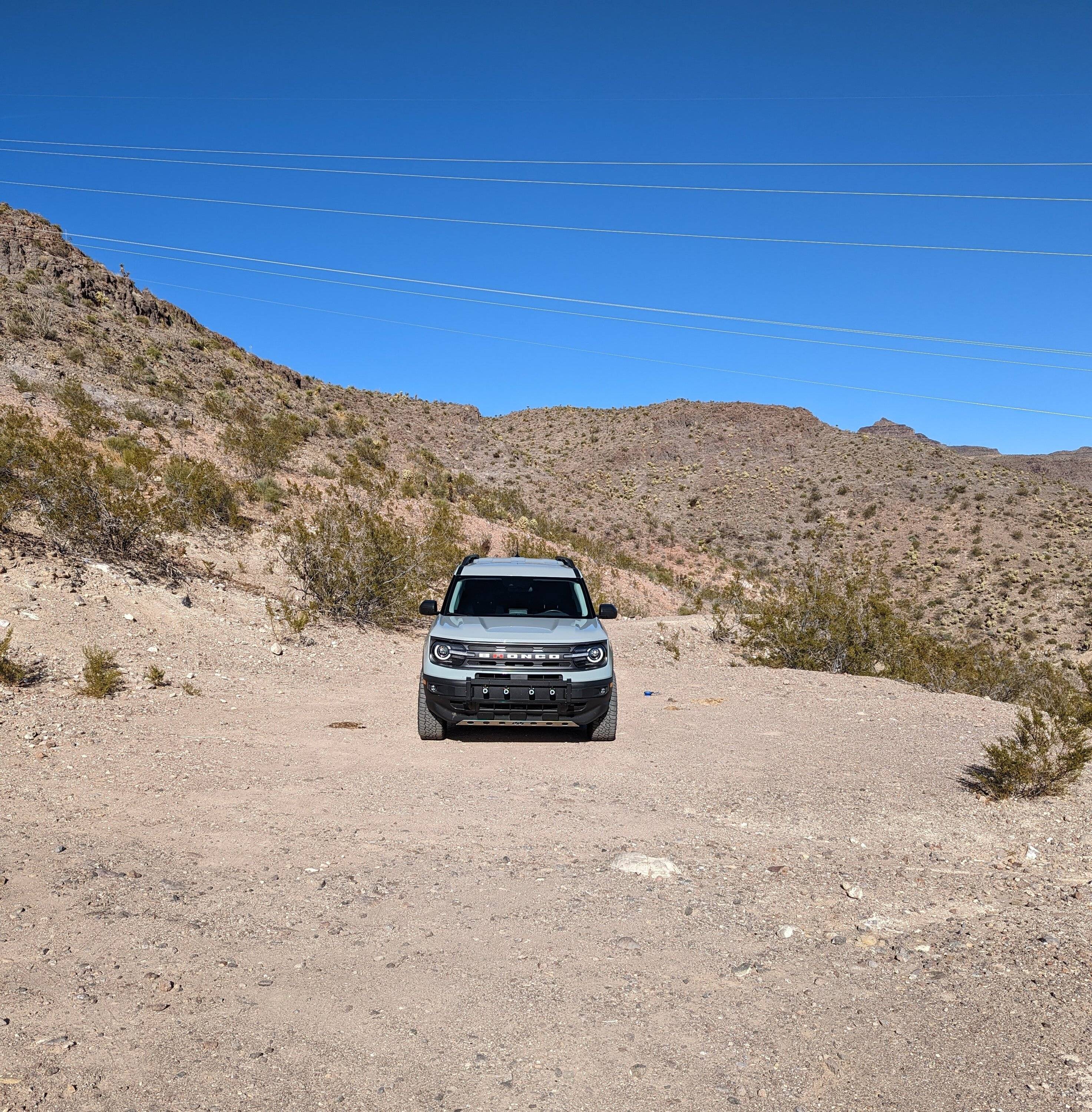

When I purchased my BB the first thing I knew was it needed different wheels and bigger tires. Being such a new vehicle the wheel options were short and out of stocks were normal because of supply issues. I like the wheels I got but they were fourth or 5th on my want list. Everything was backordered for like 6 months I couldn't wait. I settled for a 7.5" rim with 35mm offset. I don't want my tires sticking way out but wanted just a little more. Before buying new rims I picked up some 20mm(3/4") hub centric spacers. I drove my BB for a week with spacers and stock 18" 225 tires. Looked way better but it improved the handling tremendously. With my other wheels and 245's it's awesome. I may see if I can find a real lightweight wheel I like since I plan on no hardcore wheeling and get rid of the spacers. I would now be looking for a 8-9" wide wheel with a 30 mm offset which should put about where I'm at without the spacers.

What’s your brother! I believe I’m going to run the same spacer you are it looks great.
I was just curious as to what your front bumper mods are? I love the skid plate on the bottom curious where I could find one myself.
Thanks, a lot!

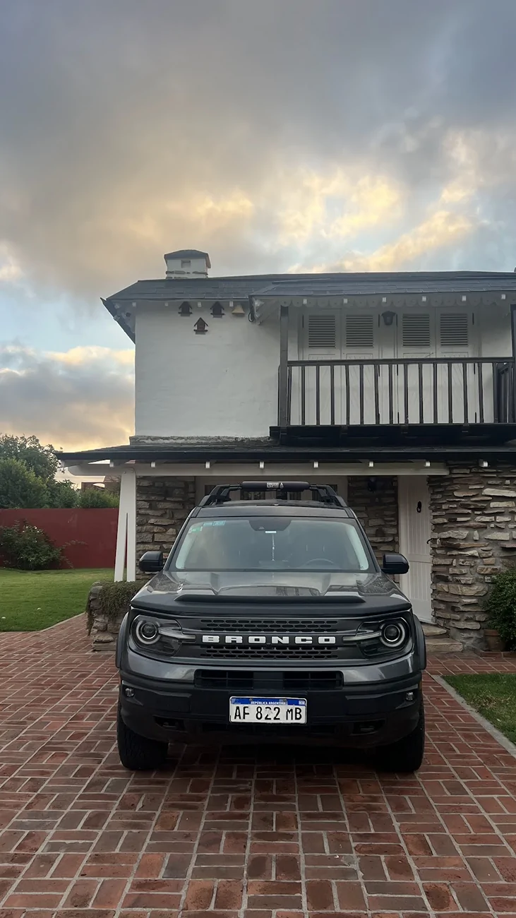

Hey, my friend. I have Bilstein B8 Terrasport shocks that give 1.25' of lift to my Bronquito, plus 235/65 R17 BFG Trail Terrain and ERG Fender Flares. Do you recommend installing 30mm wheel spacers?
