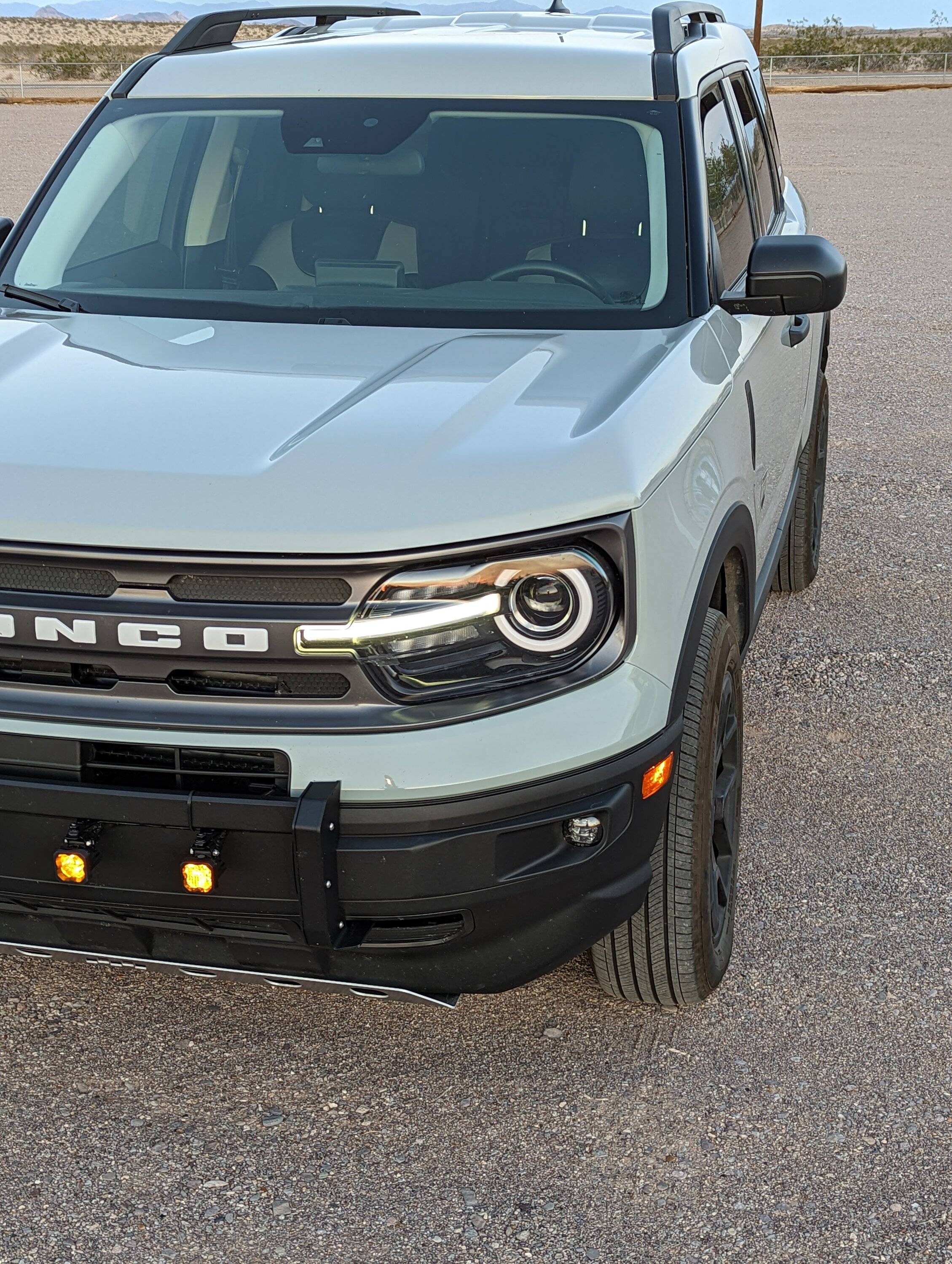

When I purchased my BB the first thing I knew was it needed different wheels and bigger tires. Being such a new vehicle the wheel options were short and out of stocks were normal because of supply issues. I like the wheels I got but they were fourth or 5th on my want list. Everything was backordered for like 6 months I couldn't wait. I settled for a 7.5" rim with 35mm offset. I don't want my tires sticking way out but wanted just a little more. Before buying new rims I picked up some 20mm(3/4") hub centric spacers. I drove my BB for a week with spacers and stock 18" 225 tires. Looked way better but it improved the handling tremendously. With my other wheels and 245's it's awesome. I may see if I can find a real lightweight wheel I like since I plan on no hardcore wheeling and get rid of the spacers. I would now be looking for a 8-9" wide wheel with a 30 mm offset which should put about where I'm at without the spacers.

Mostly on road. Feels more planted, stable just going down the highway and all around. I felt it a lot with the 225 tires. 1 1/2 " more stance front and back. I don't 4wheel a lot but did some desert driving yesterday and had no problem sliding this thing sideways in turns and donuts, sand mode is fun.

It looks really good, I gotta say. Any rub (offroad)?

No signs of any rubbing. I'd like to try a 255 tire(without spacer)
but its very close and would prob hit with a slightly larger tire.

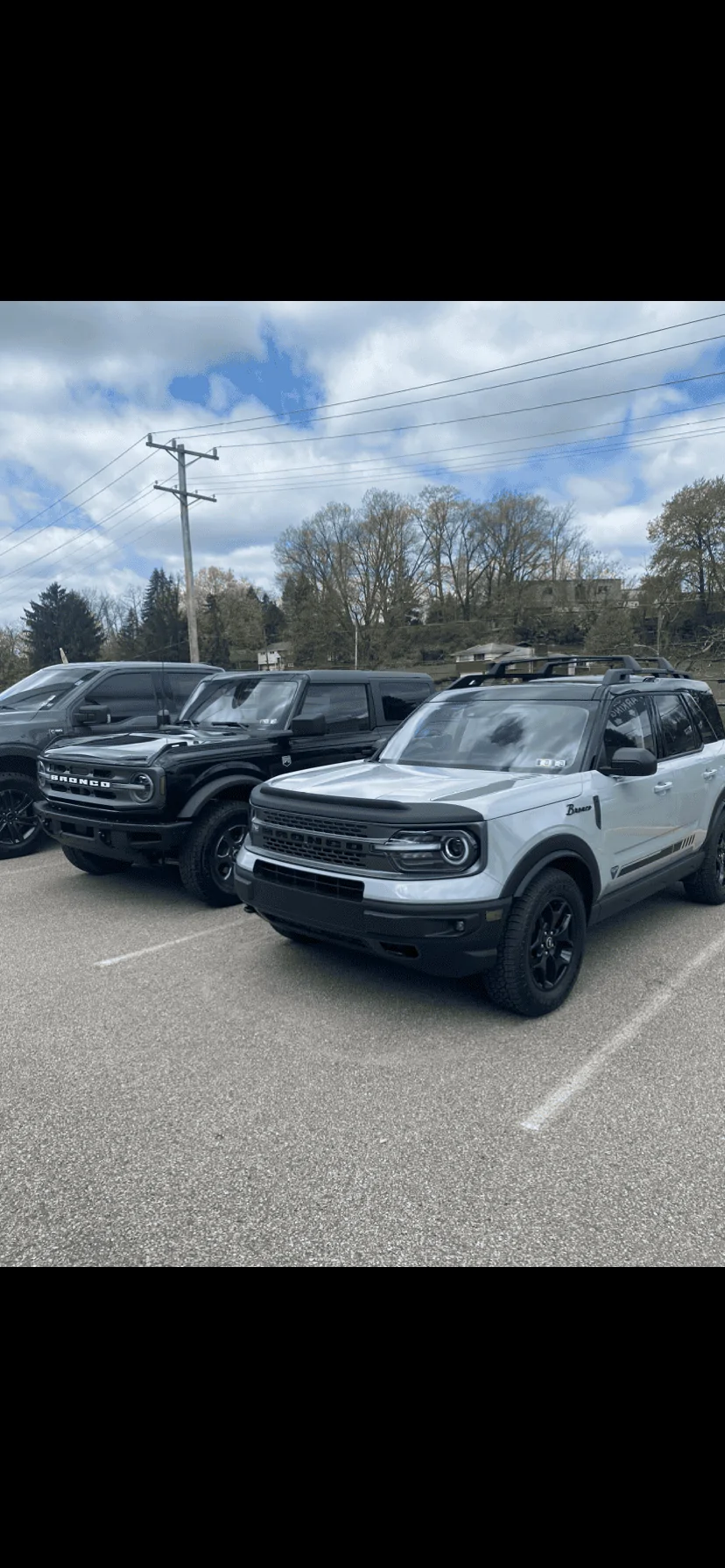

Why not try a 245/70/17 tires on factory rims with spacers?

I actually just had my factory rims on for a couple months. I was deciding if I liked them or not, if they were worth putting nicer bigger tires on. I even painted them black. Putting the spacers on real improved the overall driving feeling and look but I'm personally just not liking the 18" factory rims. I'm fine with 65 series tires for what I use my BB for just wanted a little wider.
