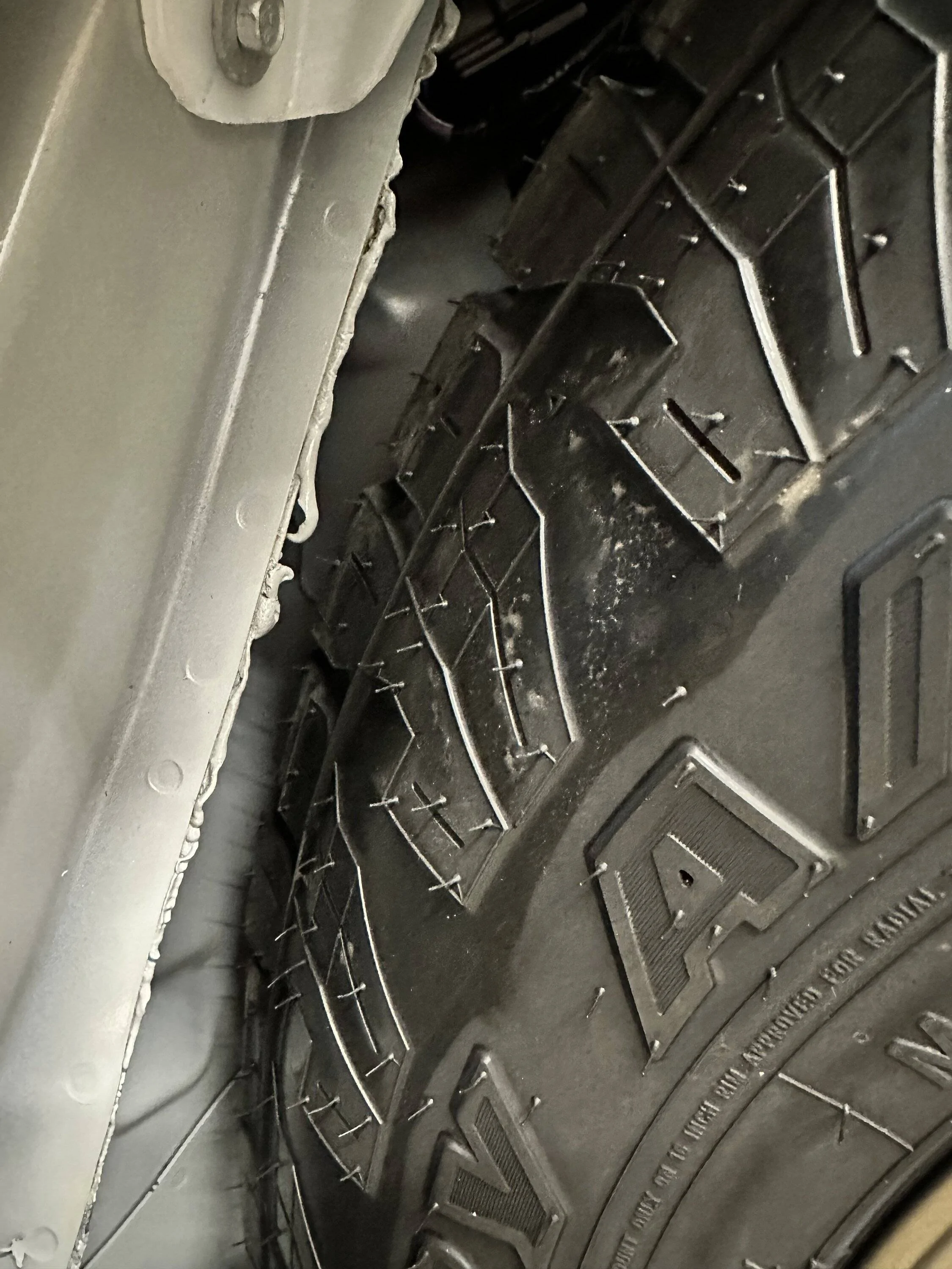

Here is a picture I took with the suspension compressed (spring removed) and wheel turned. This picture doesn’t really show where the rub happens. I just didn’t know at the time where the rub would happen but you can see that if the face of the tire is further back, it will move away from the pinch weld.
Ford Bronco Sport 20mm wheel spacers installed 1673392156355

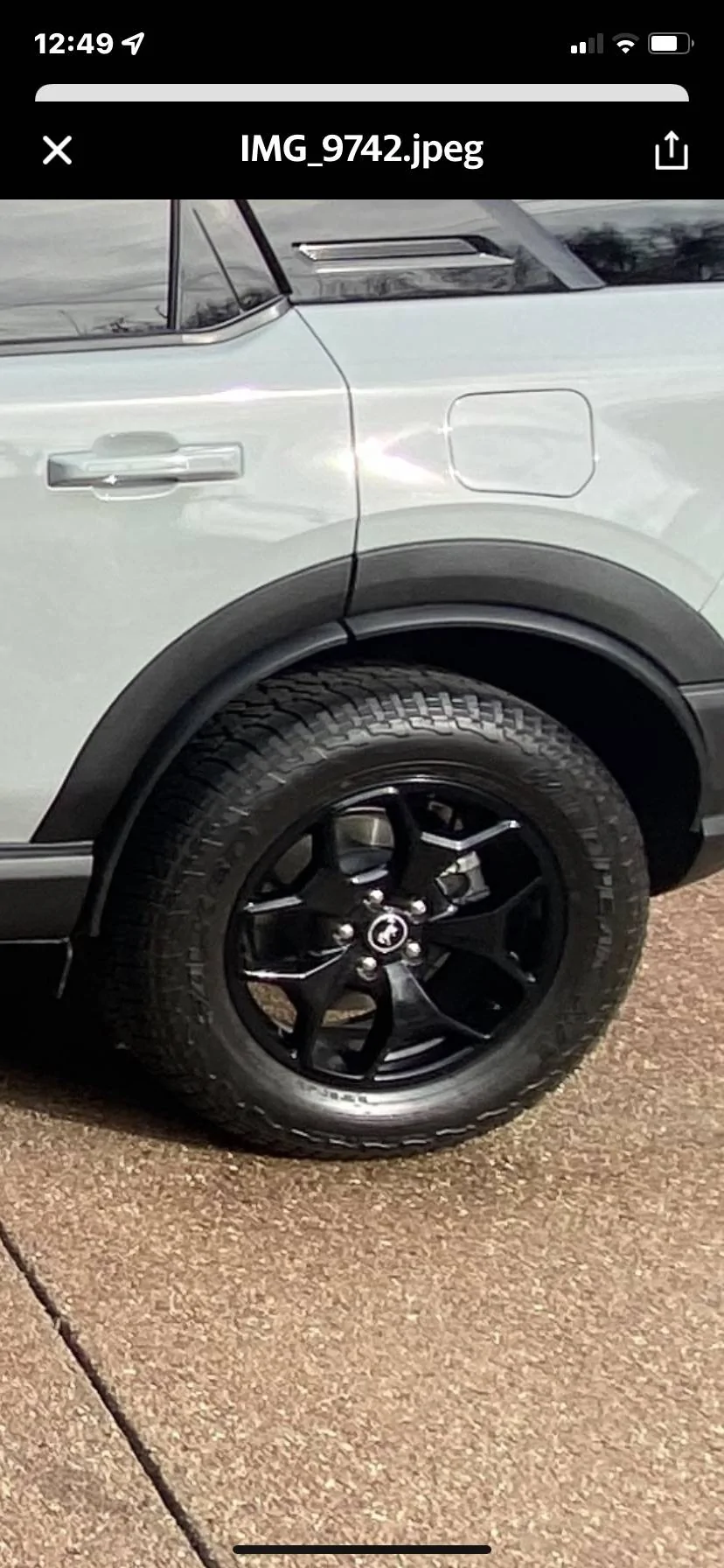

Jrl: That is a sweet ride, the rims and wheels look great with the color of your horse. Did you just paint the normal rims black? If so it came out very well. The Bronco script also looks good on your ride.
I'm riding currently on the 236/65/R17 Falkens, and agree they are a good tire. They are more "aggressive looking" in person than I thought they would be. Just looking at some options for when they wear down.
Mine is called a first edition, it is all stock from factory as you see it . I did add running lites upfront and a 1 1/2 inch flares the badges are all factory. And the black rims are factory.
