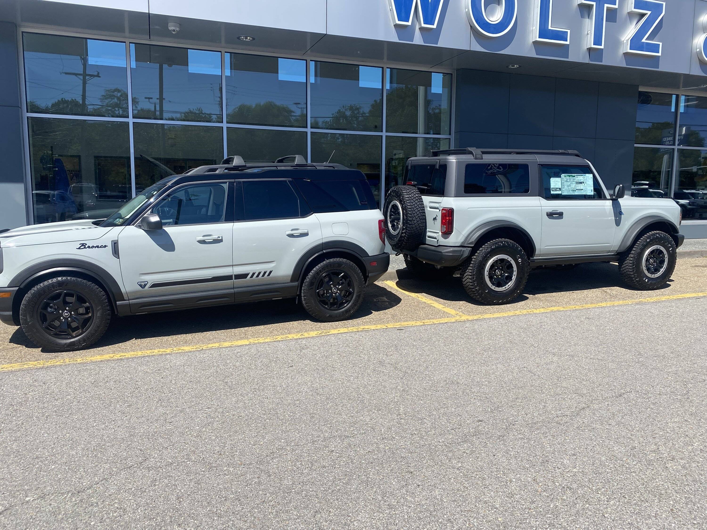

You might want to look at 235/)65/17
Take a look , that’s what I run , a very good tire . They are Falken wild peak

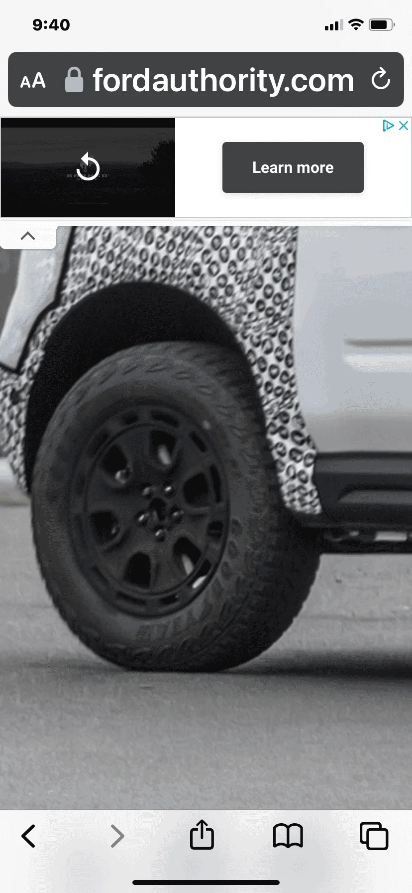

You might be better off with 235/70/17 with no lift and no spacer. Check my posts the , tires I used are exactly 30 inch Goodyear wrangler workhorse.
Ford Bronco Sport 20mm wheel spacers installed IMG_1199
I thought I read they will rub in that size? Or, was it 245/70/17 that rub? Also, how much is your speedo off? Got any close up photos? THANKS!
1,426
1,480
Yes it is the 245/70/17 that might rub , that 10 mm does the trick.Maybe 2/3 mph at 60mph . Not an issue for myself. I have clearance of my pinky , is it close hell yes but rides and looks perfect for me , I like the full wheel well look . Check out my other pictures for a better look see . That Goodyear is a few lbs lighter than the ko2 and I think only a couple lbs more than my stock 235/65/17 wildpecks .A lot of people are using 245/65/17 wildpecks , I think the true size on them are 29 1/4 and my Goodyear workhorse are a actual 30 inch tall . Enjoy the picture below is a 2025 bronco sport that is proposed . Notice it also is a Goodyear and it appears to be a 30 inch .not fact just my thoughts.

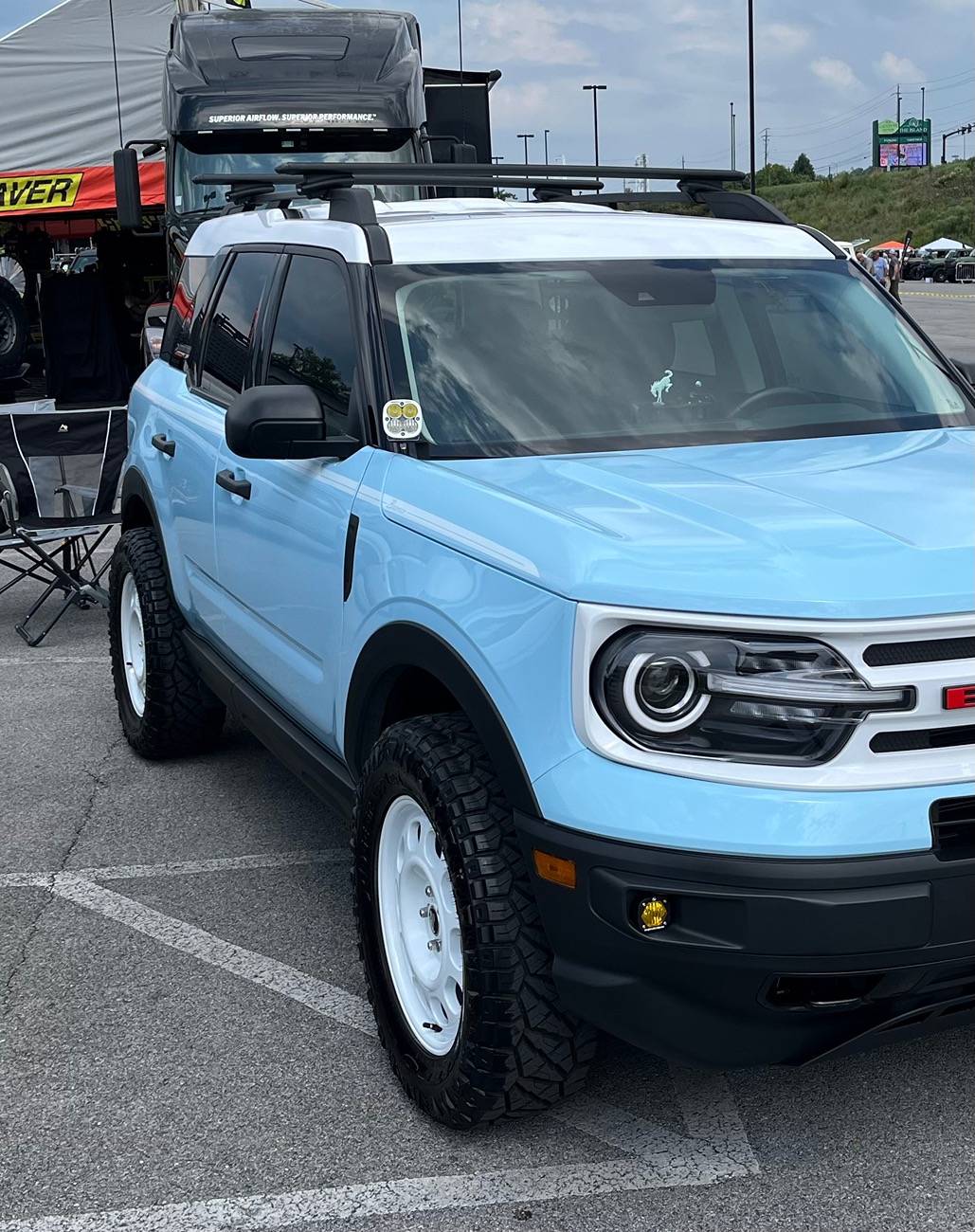

When I purchased my BB the first thing I knew was it needed different wheels and bigger tires. Being such a new vehicle the wheel options were short and out of stocks were normal because of supply issues. I like the wheels I got but they were fourth or 5th on my want list. Everything was backordered for like 6 months I couldn't wait. I settled for a 7.5" rim with 35mm offset. I don't want my tires sticking way out but wanted just a little more. Before buying new rims I picked up some 20mm(3/4") hub centric spacers. I drove my BB for a week with spacers and stock 18" 225 tires. Looked way better but it improved the handling tremendously. With my other wheels and 245's it's awesome. I may see if I can find a real lightweight wheel I like since I plan on no hardcore wheeling and get rid of the spacers. I would now be looking for a 8-9" wide wheel with a 30 mm offset which should put about where I'm at without the spacers.

This looks AWESOME! Question for you...if my wheels are a 30mm offset...and I wanted mine to look exactly like this...should I go for some 15mm wheel spacers then?
(Yours are 35mm offset wheels + 20mm wheel spacers correct?)
Also...do you have fender flares on this?
