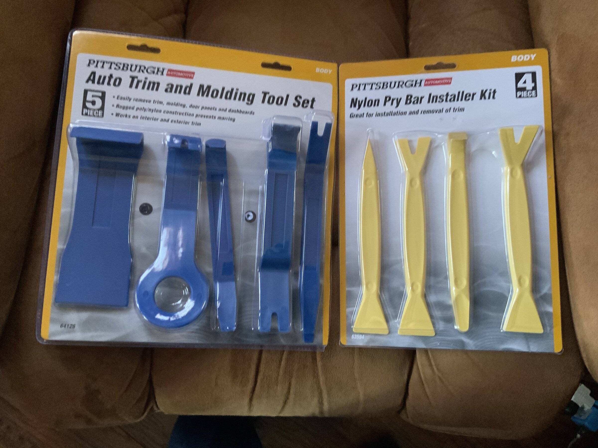

Would this set have what I would need? Thanks
Yes, but to be honest I just pulled it up with my hands. I grabbed it from the edge and cup holder area and pulled out the right side a bit first then once it popped out a bit I did the whole front part and came out easy.
It's well worth it to buy a set. I bought a similar set many years ago and am still using it. Taking off door panels, plastic rivets, trim pieces, etc. It'll save you a ton of headaches, scratches, and perhaps money.

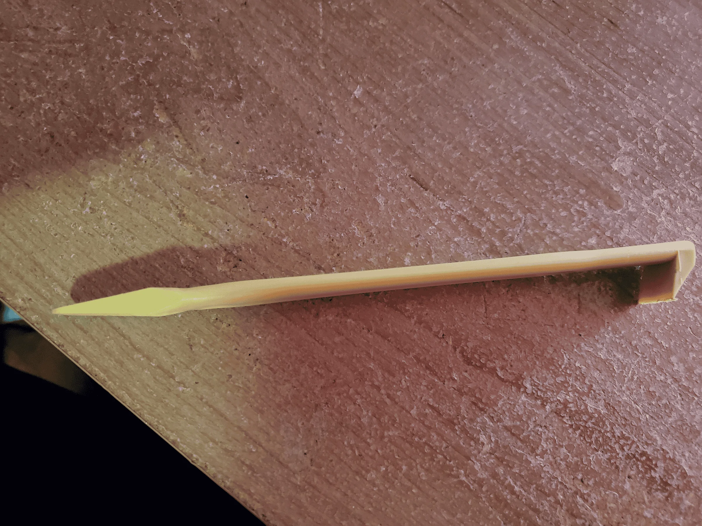

I appreciate the help but looking at the plethora of trim tools available, it doesn't help with knowing which to use and how to use it.. They're all easy to use once you know where and how.
harbor freight sells the plastic trim remover tools cheap
Ford Bronco Sport Cup Holder Ambient Lighting 1649519918109

Ya I spent a little over $ 20.00 bucks on these 2 kits from Harbor Freight
