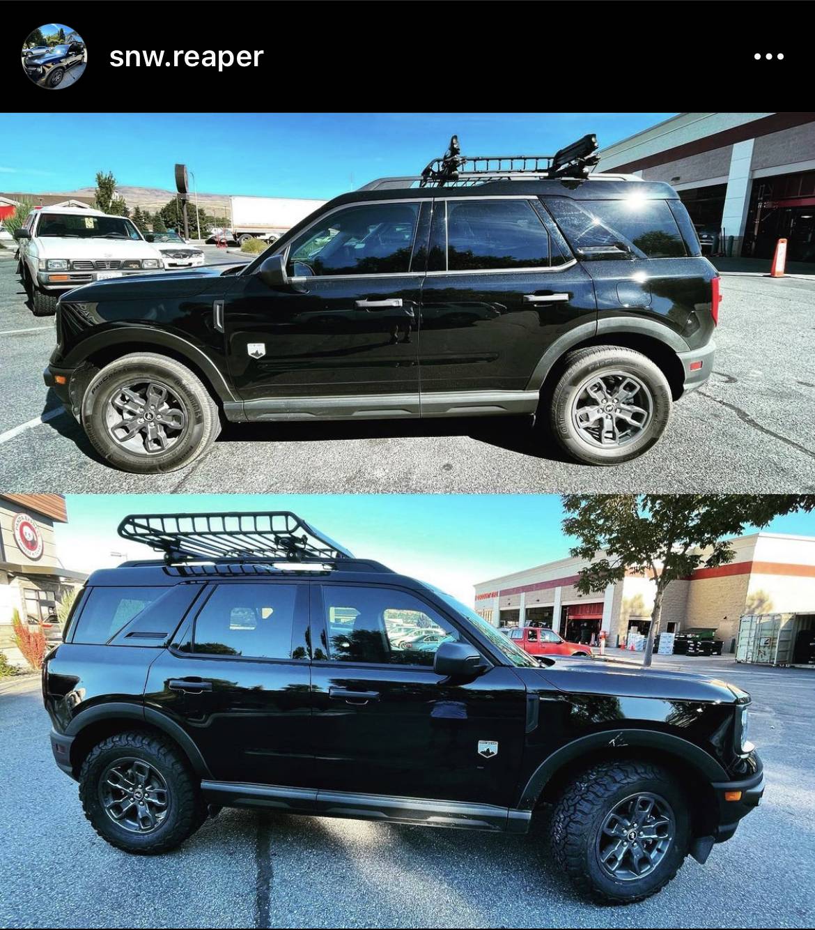

AndyMac204
Andy
Jun 27, 2021
889
1,565
what goat mode are you in, going up and down hills? i had mine in normal, popped it in sport and it seemed to help mileage (somewhat).
i have the KO2s, but kept it at factory size just so i didnt have to mess with anything.
but - the pic of yours with the 245 KO2's ...... looks awesome.
