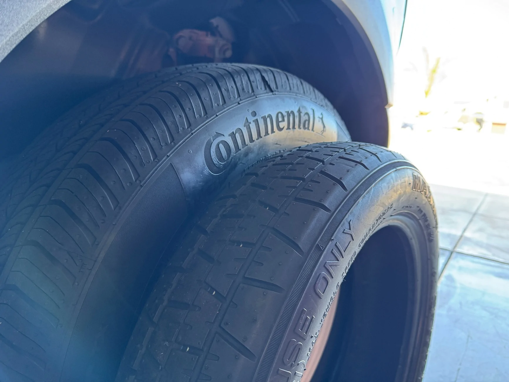

My Wife's 2025 Heritage has a stock tire diameter of 29 inches. Given that the owner's manual makes such a big deal about matching tire diameters on all four corners, it's crazy that the stock donut spare on the '21-'24 models is 25.25 inches. See photo below, it's crazy.
I installed a Falken 165/90-17 tire on a '21-'24 rim, the diameter is just where we'd like it to be... at 28.9 inches. No photo required, it matches her normal tires in terms of diameter.
We've gone from a 13% mismatch to half a percent mismatch. Hope this helps others.
