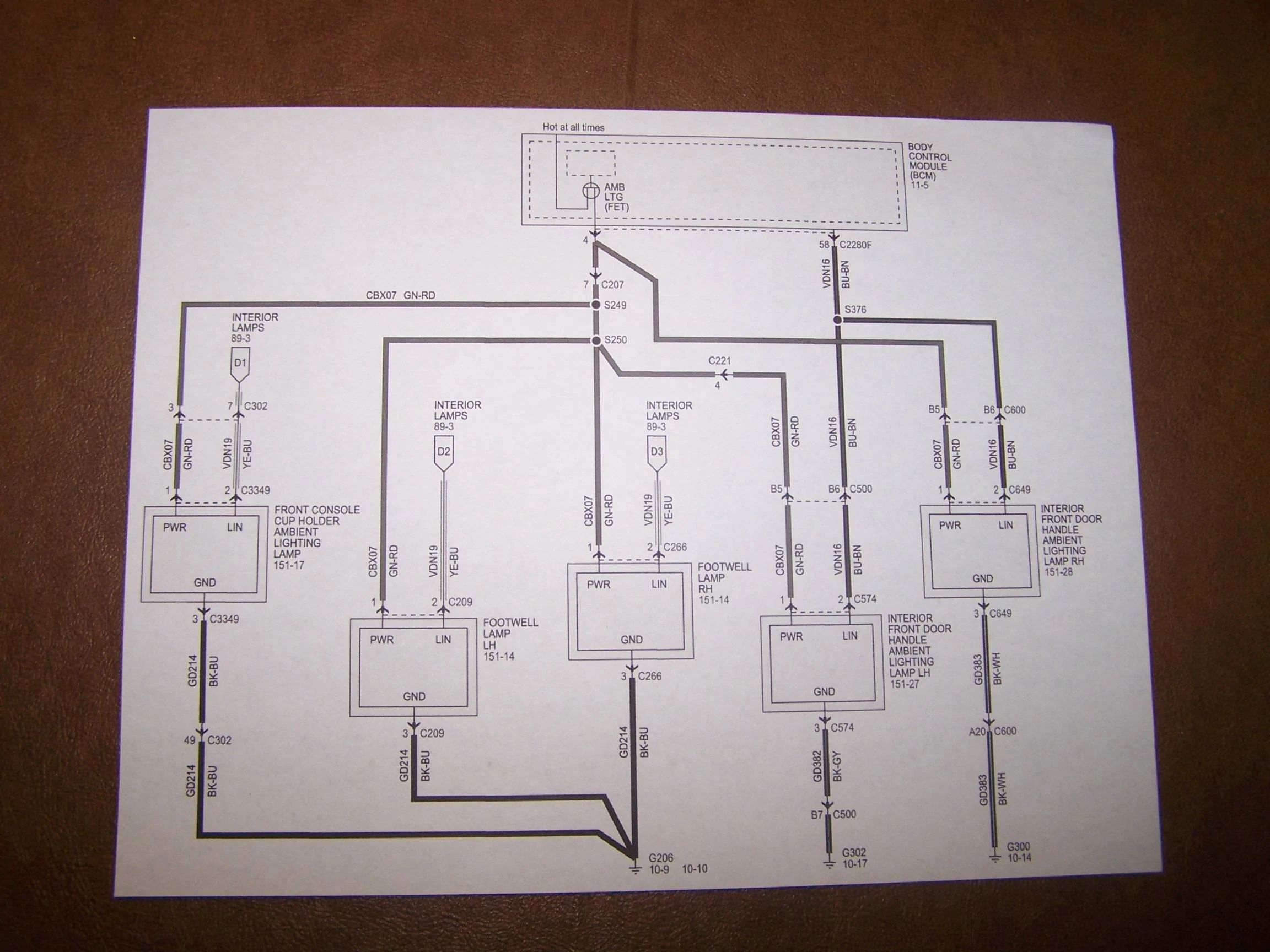

I've been following this thread from the start. I have a '23 OBX with unlight cup holders. I purchased an Escape cupholder from a member of this forum. I just sent for and received a service manual with wiring diagrams. After looking over the wiring diagrams I think the best approach would be to splice into the passenger side footwell light. It has the same three-color coded wires (black/blue(ground), green/red, and yellow/blue). Just splice color to color and you should be good to go. I think you can just pull the glove box to get access to the footwell light wiring. You just have to fish the wiring from the cupholder to the footwell. The advantage to doing it this way is that all the lights would be on at the same time and with the same brightness. This is the way I will attempt this mod. Unfortunately, I live in Syracuse, NY and it's quite cold. My garage is heated but only maintains about 50 degrees. I won't be doing this mod, my Tectico side marker mod, or my rear bumper protector until we get much warmer weather. I'll let everyone know how it works out.

Here is a picture of the wiring diagram from the Service Manual. The footwell wires (3) are the same color for the cup holders and footwell. It should be just a matter of splicing them. I hope the passenger side footwell light will be accessible once the glove box is removed. I'm not sure why there are 3 wires. If it were just power and ground it would be easy to tap into one of the existing lighted dials in the console. This wouldn't be the ambient lighting, but rather just normal dash and instrument lighting. I tried with a battery to get the cup holder lights to work with no luck. There must be something about that third wire I'm not understanding. Perhaps someone else on the forum can help. If anyone
wants a printed picture of this diagram send me your mailing address in conversations, and I'll mail you one.

To me it seems like they’re constantly powered but have a trigger wire. 1 ground, 1 12v constant, and 1 accessory wire. That’s just how I see it. Might be wrong.
I'm not sure. Wiring is not my strong point. I'm waiting for warmer weather before I start trying to figure it out. If you have any luck, please keep us in the loop.

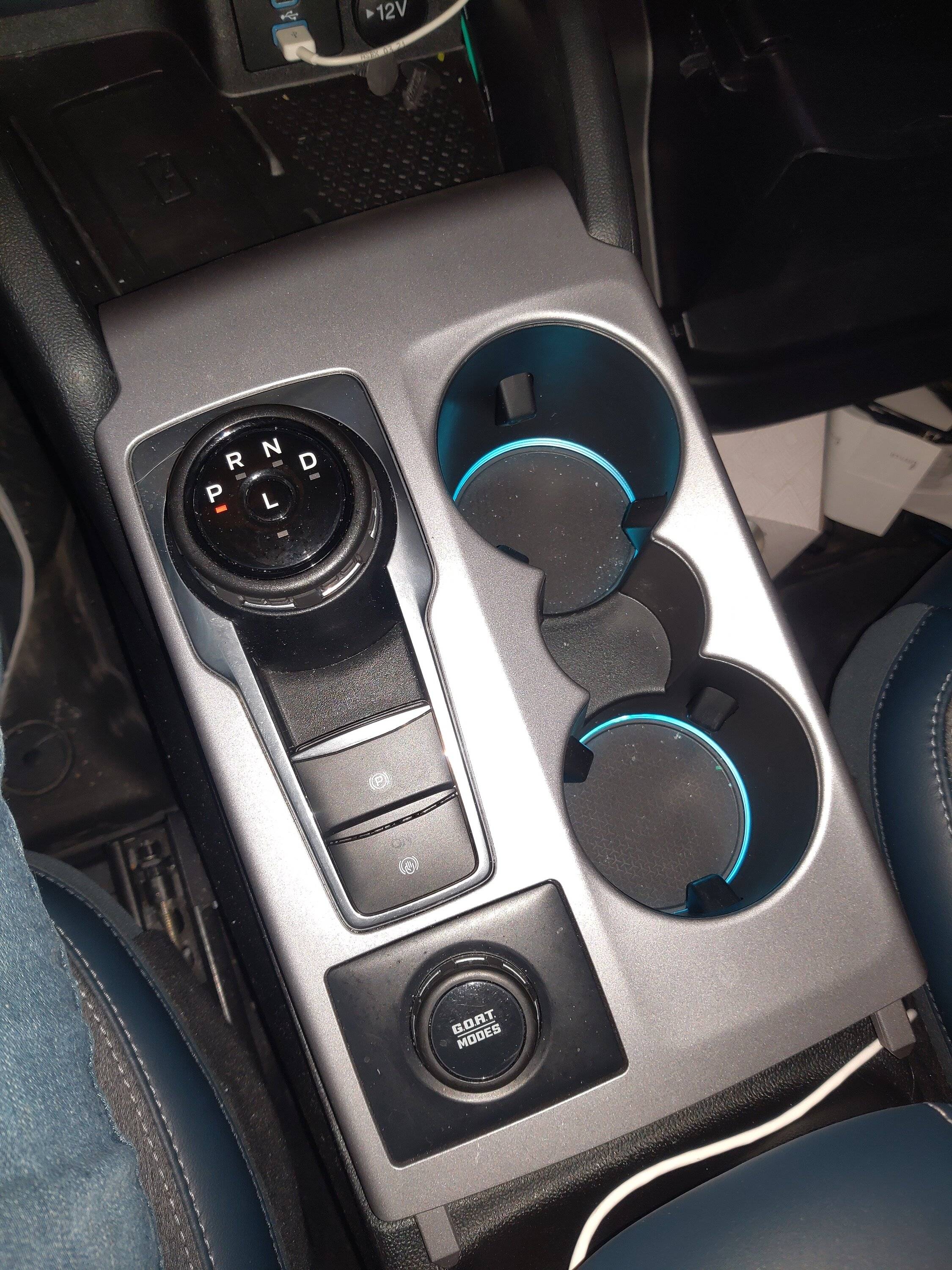

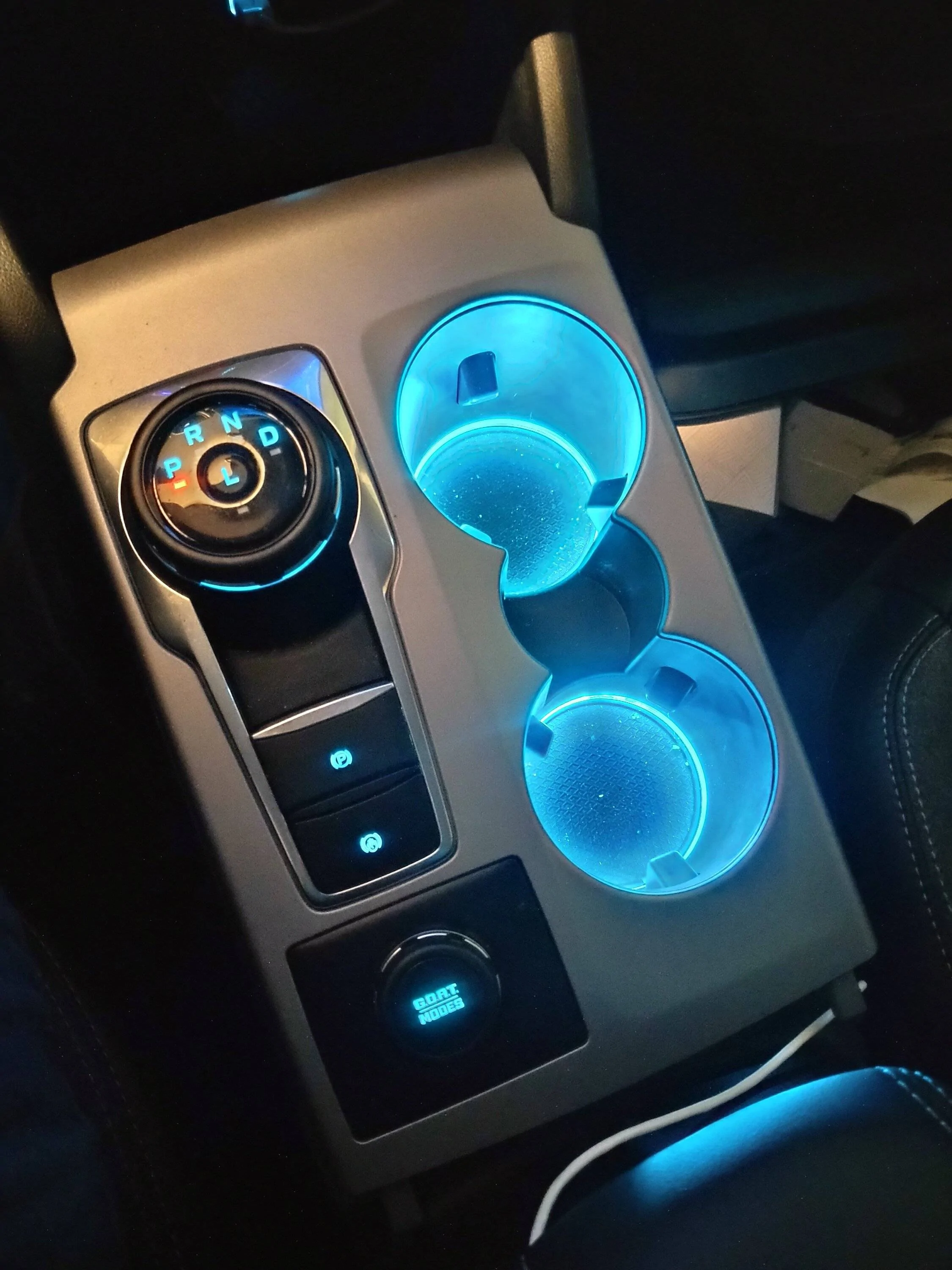

So, had a warm day where I felt like tackling the project. It turned out to be easy enough to figure out!
I'll make a detailed write-up probably tomorrow, but the gist of it was I bought some 20awg wire, wired it to the ambient light assembly under the passenger side dash, and voila! It will dim/brighten with the controls in the SYNC 3 menu.
