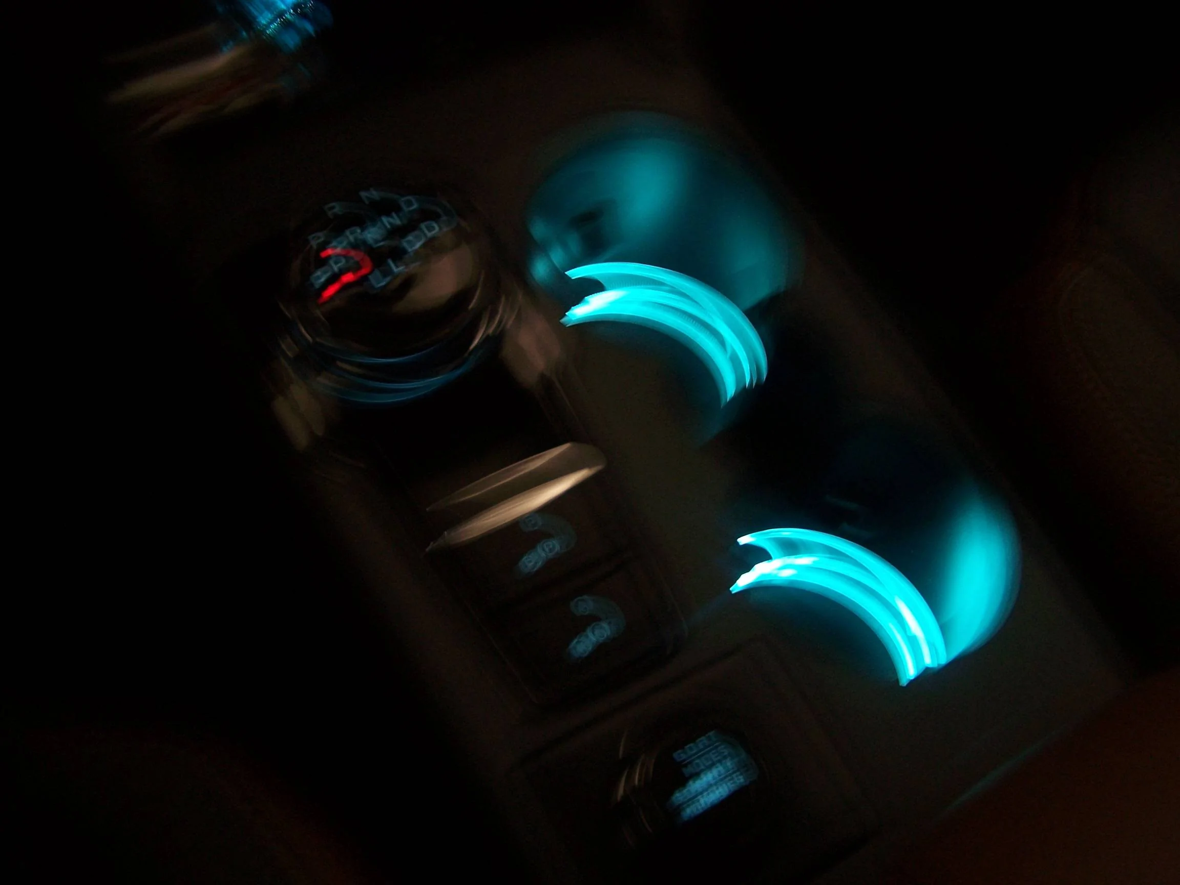

Finally got my illuminated cupholders done. Many thanks to members Pintarrr and JCampos 30 for their pictures and info on this mod. They were a tremendous help. Very happy with the results.
Ford Bronco Sport Cup Holder Ambient Lighting 100_6840
how did you end up running the wiring?
My '23 OBX came with ambient lighting. The ambient light under the glove box has a harness with the same color wires found on the Escape illuminated cup holder. It's just a matter of splicing all the same colors and your good to go. Just spliced into the wiring harness and ran the wires through the console. Splice to the cup holder wires and you're all set. Well worth the effort in my opinion.
Contact me in conversations with your address, and I can send you a copy of the wiring diagrams if that would help.
