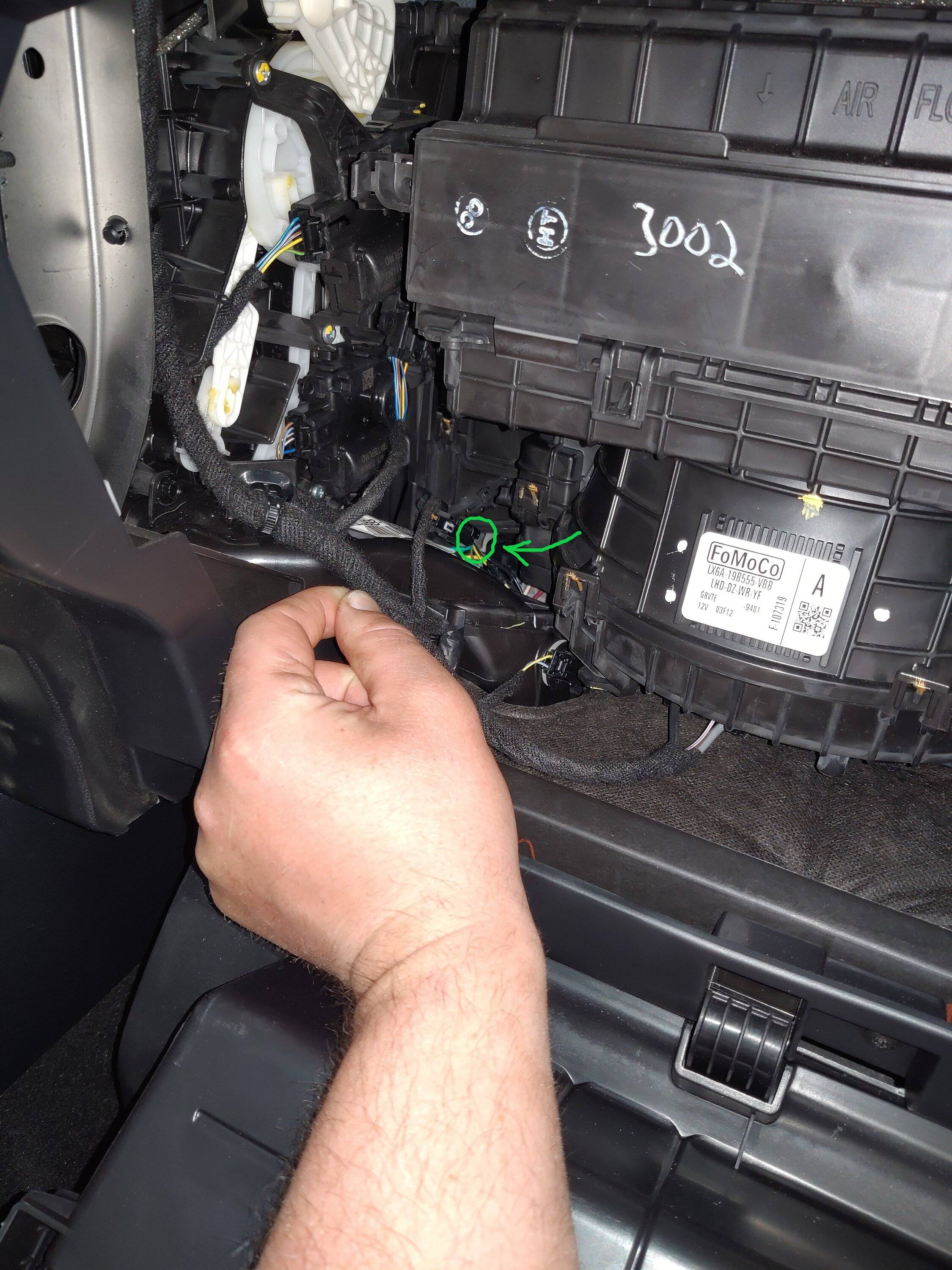

Next you'll want to remove the glove box for access to the 3-pin connector that powers the footwell ambient light. Open your glove box and press in the tabs on both sides to lower the glove box further. Now, disconnect the dampener on the right side of the glove box by using a pair of pliers to push the two ends of the male clip together, and pull off the dampener. You might have your glove box fall and spill all of its contents onto the floor (you can probably guess how I know,) so be ready for that. Now, with your glove box disconnected, simply lift the box up and out, giving you ample room to work.

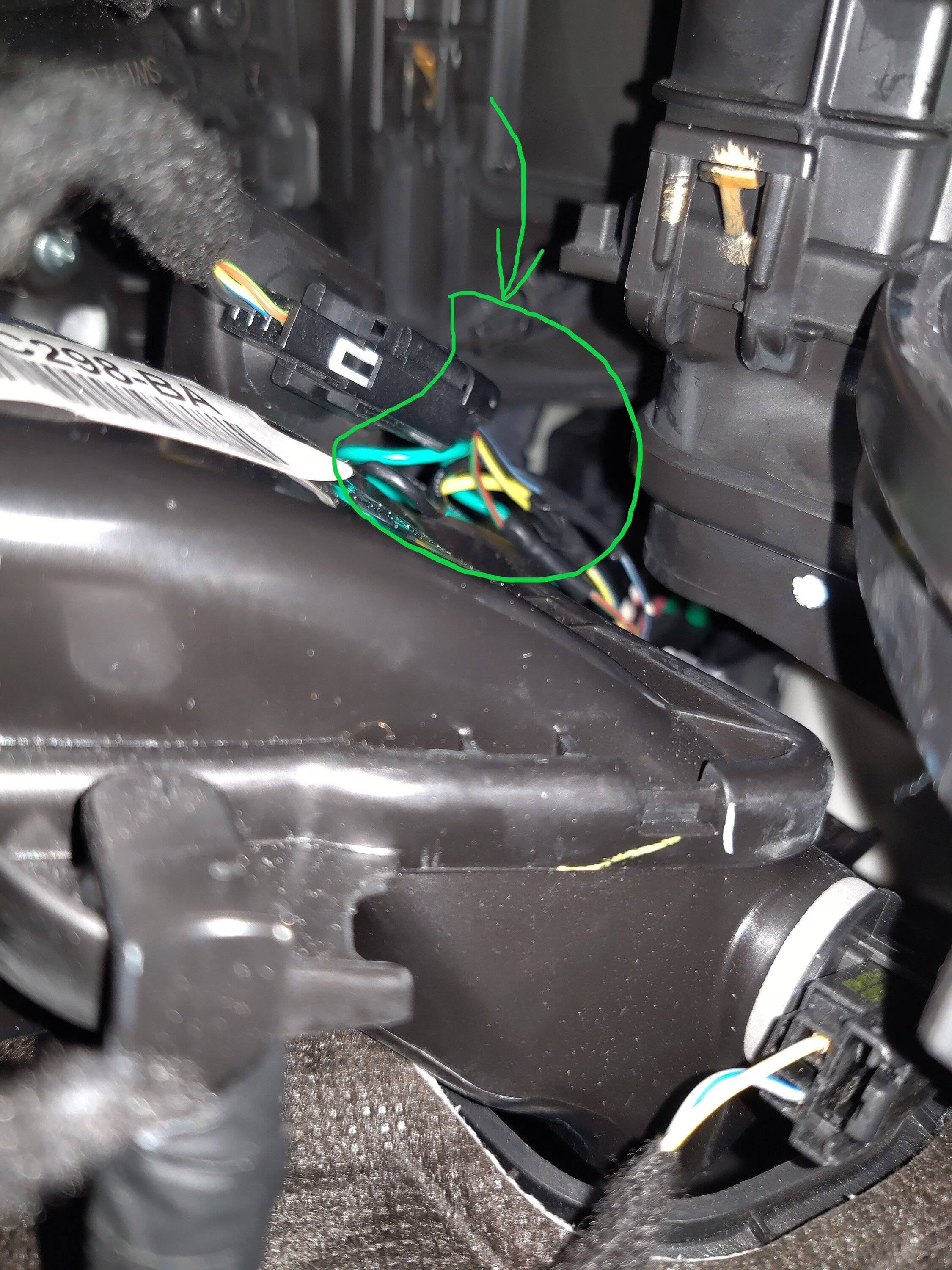

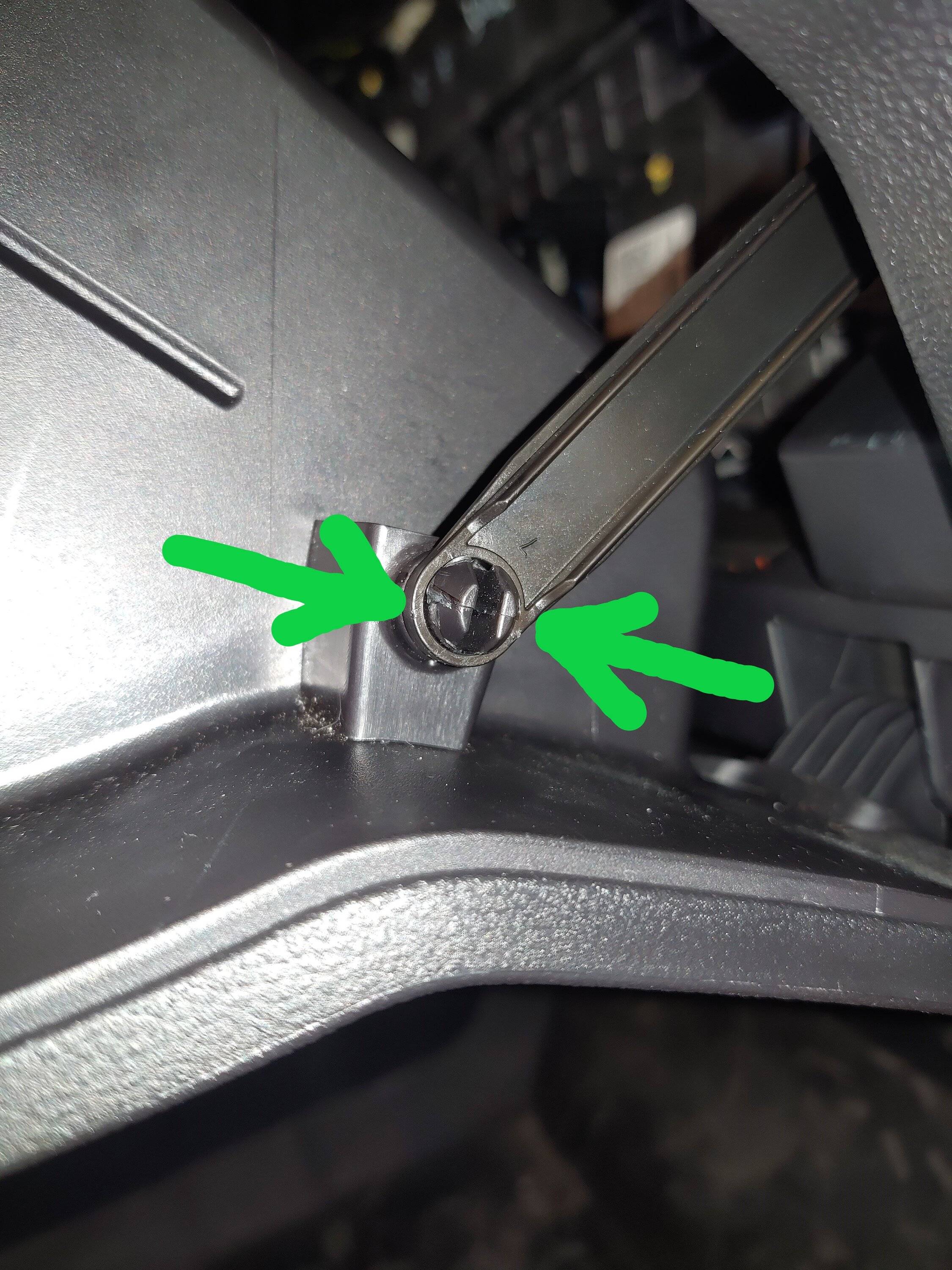

Ok, on to the footwell light. Remove the fuse panel and lower dash panel (if you have one.) *I'll edit this later to include that process with pictures, I forgot to take some for that. Once removed, you will have the remaining space needed to access everything. Use a thin plastic pry tool to remove the light assembly by pushing inward on the light cover, where the small slot is seen on the right side. There's a large tab holding the light in the socket, it should come loose and drop down enough for you to pull it through, towards the floor.
Ford Bronco Sport Cup Holder Ambient Lighting IMG_20230412_181210626
Finish disconnecting the ambient light assembly by reaching through the glove box cavity you've created. Follow the wires of the assembly to locate the end of the pigtail. Press the tab on top of the connector to disconnect. Take a mental note of where the connection is, it took me a while to relocate it because it's on the back side of another connector (pictured.)

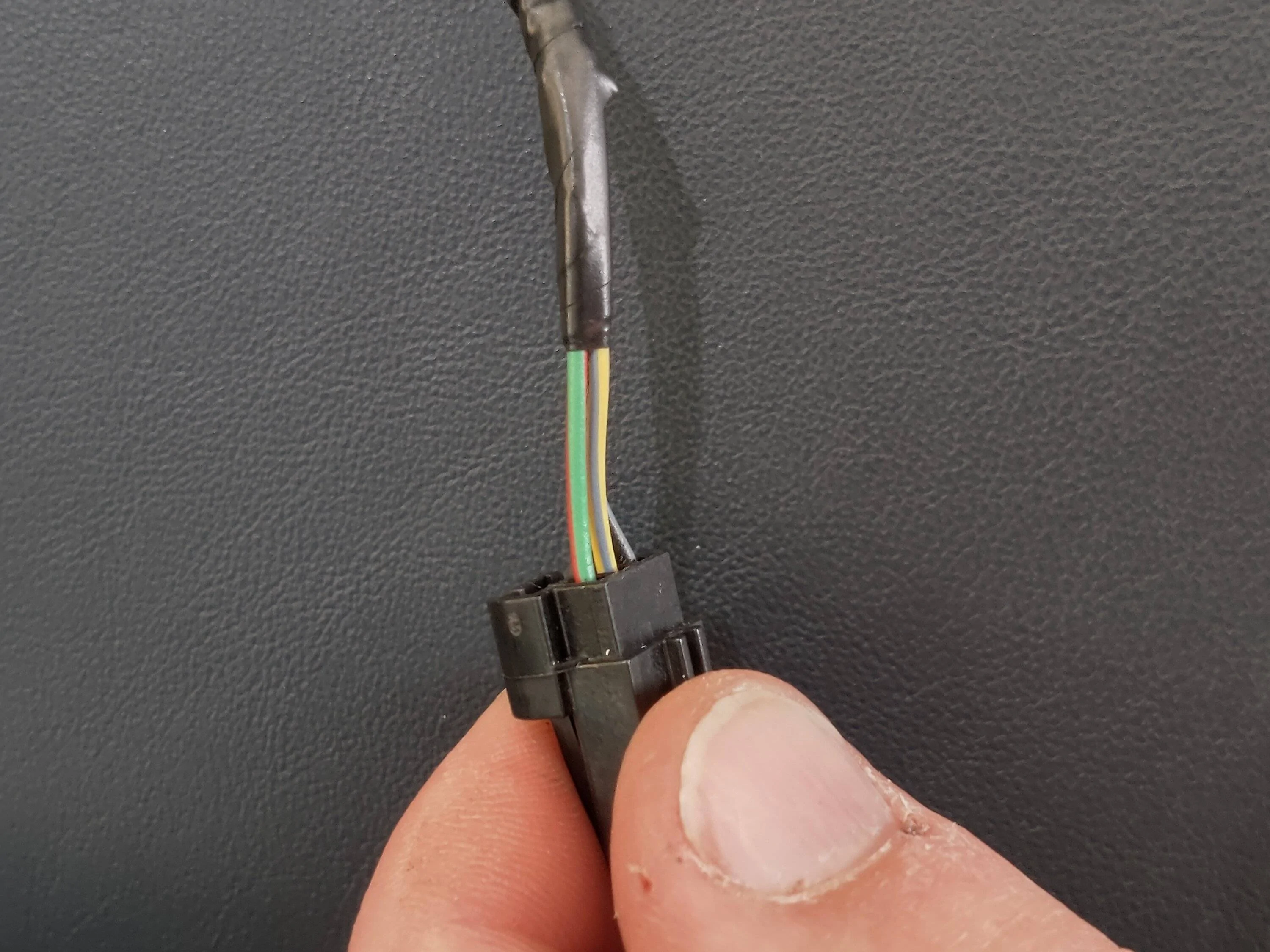

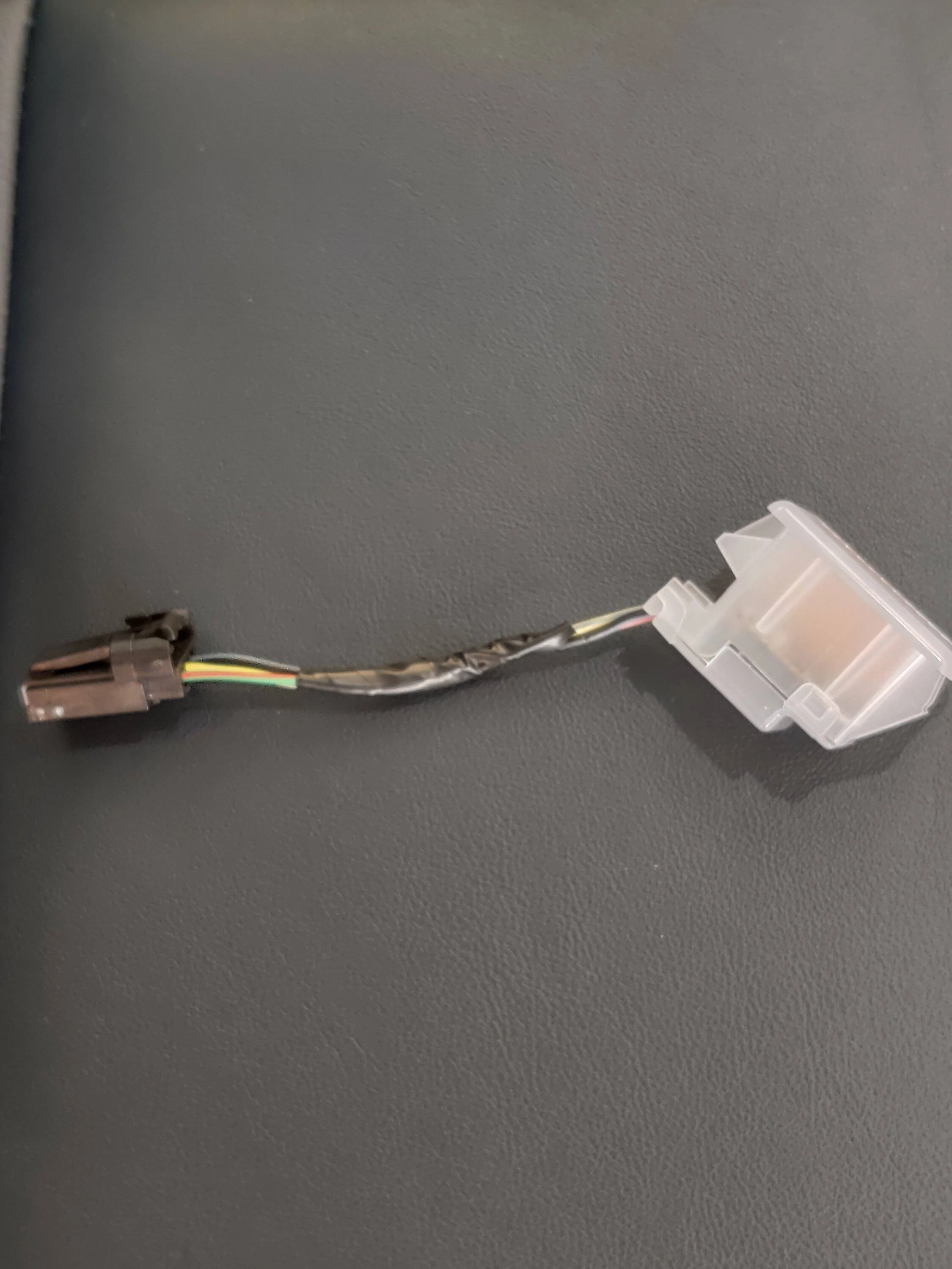

With the assembly fully removed, now you can splice into the wires with your 20 gauge wire. There are three wires with corresponding colors to the ones on the replacement cup holder. I used three different colored wires so I wouldn't get them mixed up splicing into the cup holder. Here's a link to a short YouTube video on how to splice into a wire without connectors. I plan on reconnecting my wire splices with proper connectors in the future, but this is a very solid method. The only issue is there are not many strands in the ambient light pigtail, so I wrapped the new wires around the exposed wire several times until it was tight, then used electrical tape to tightly cover the area.
How to tap into a wire without solder or special connectors | Crutchfield
Ford Bronco Sport Cup Holder Ambient Lighting IMG_20230407_181714396_HDR
Once your three wires are securely connected to the pigtail, feed all of the working end (the other end that isn't connected to anything yet) of the new wires through the bottom of the ambient light socket in the footwell. This will allow you to reinstall the light without having to squish your wires through (like I had to do, lesson learned. I'll fix that in the next few days.) Reinstall the ambient light, the procedure is the reverse of the removal. Reconnecting the 3-pin connector is the hardest part, remember to keep the tab facing upward toward the ceiling as you feel your way around and eventually seat the connector after a lot of frustration and swearing.
