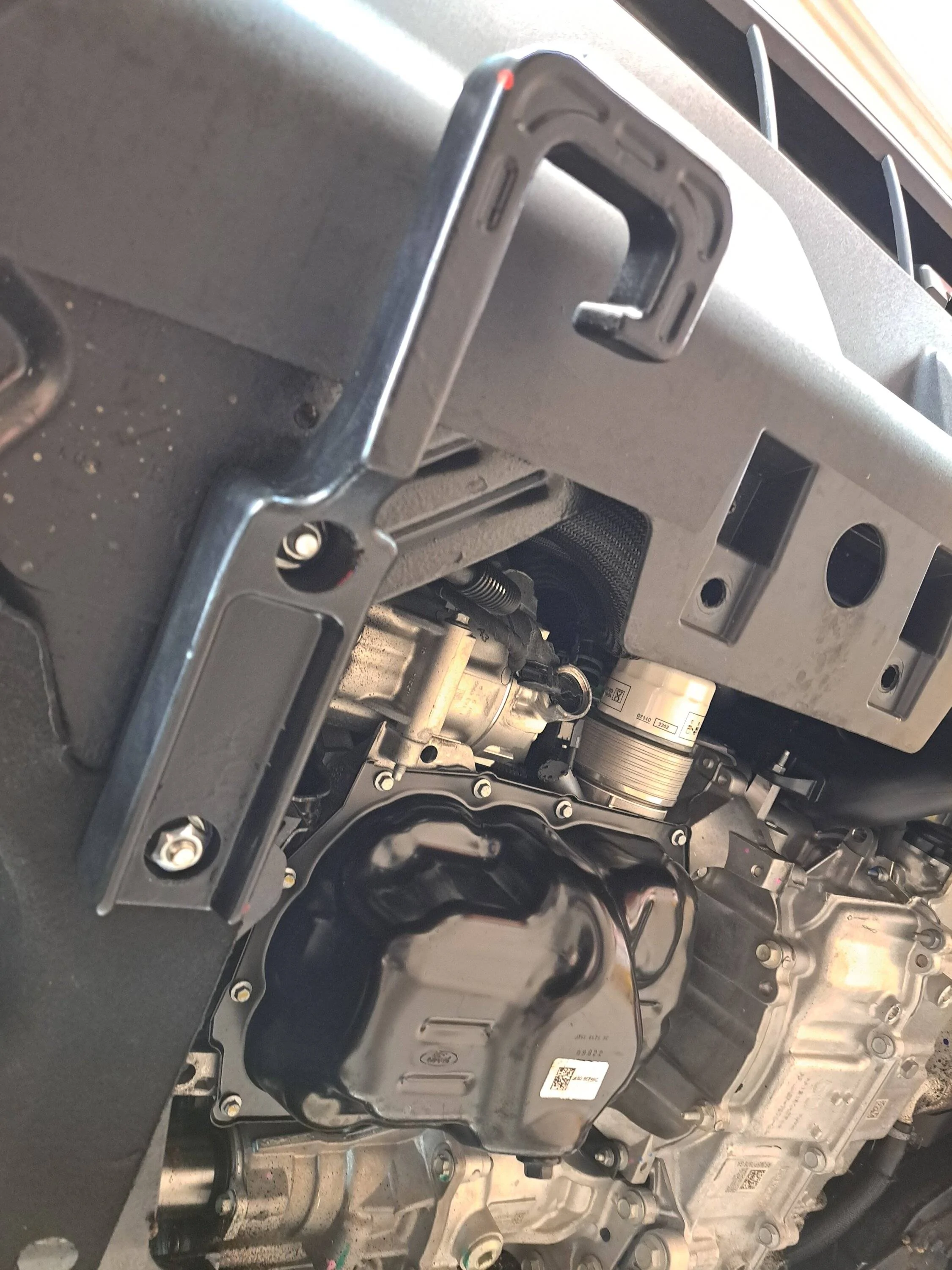

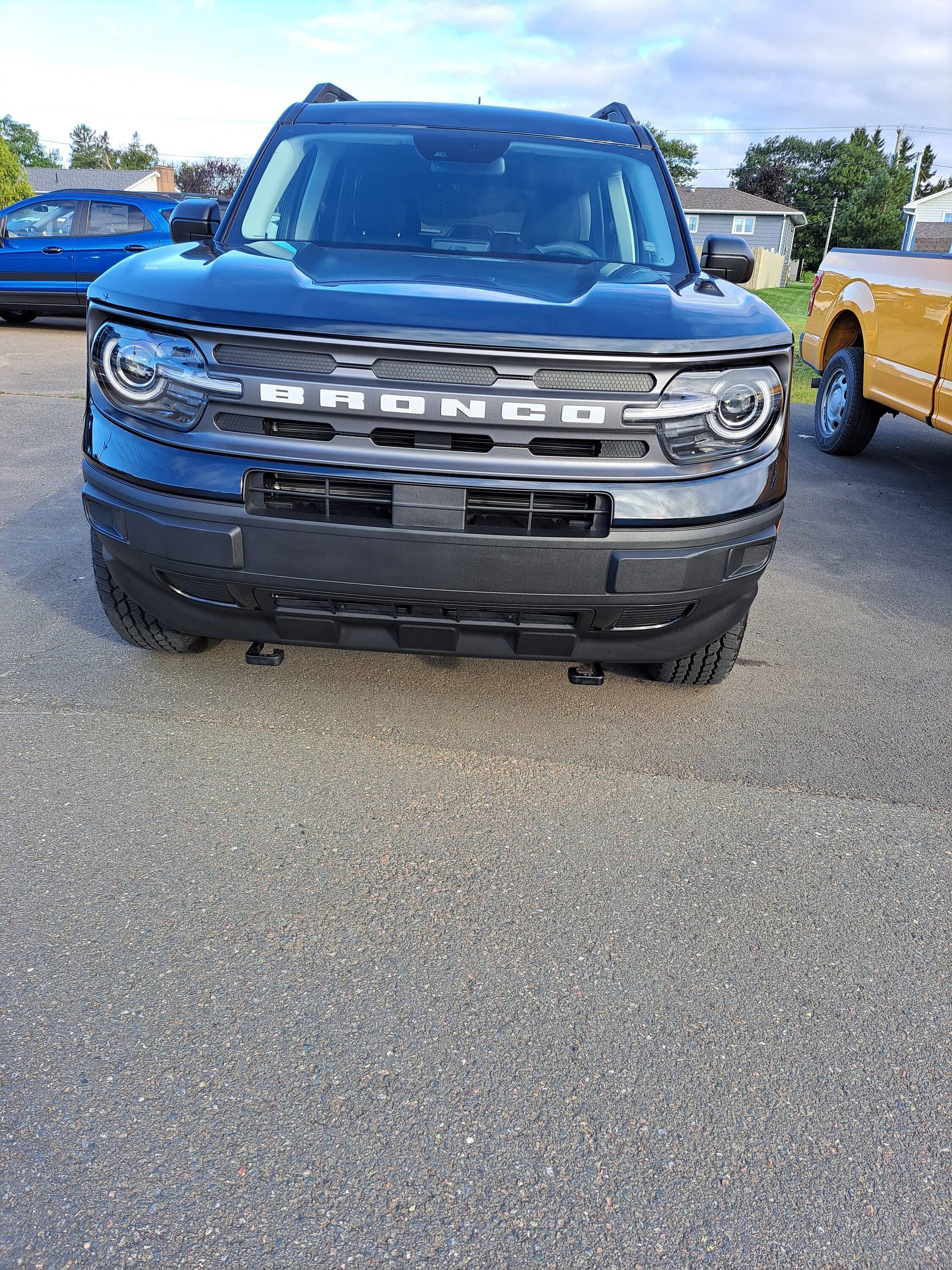

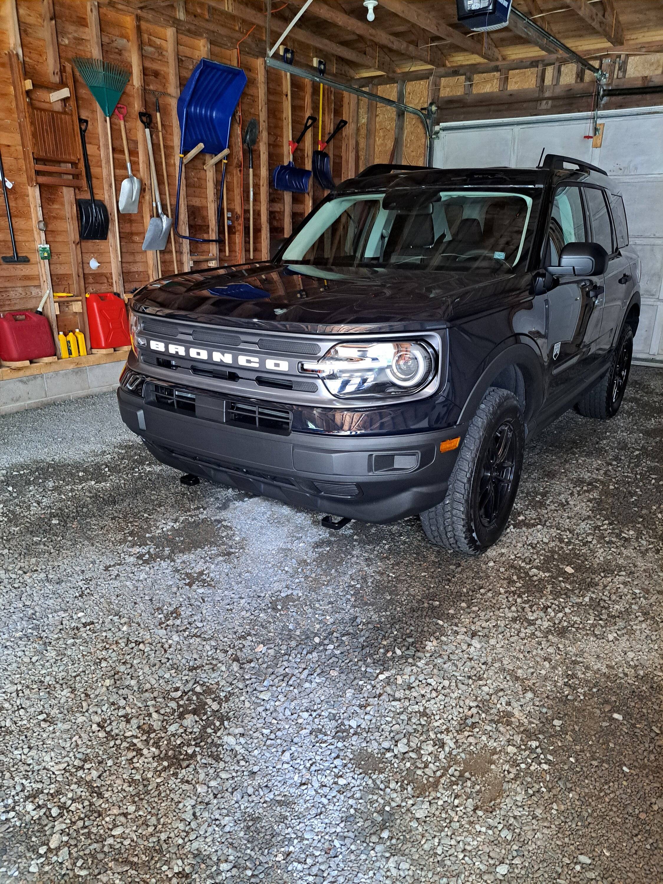

Installed tow hooks on BRONCO SPORT BIG BEND.
Just a suggestion. You may want to ask your dealer to switch sides they are mounted to. If someone were to hook up a short bridle you want the inside edges back to back not opposite like they are mounted. Looks like they could have done it that way but just made a mistake when they mounted them.

Do you think they might hit approaching a climb hill? I want to put some on mine as well would just be worried about that.
Nice :thumbsup:
I have a 1.5 in lift and 245/65/17 tires so now I have a 10 in clearance. Unless I hit rocks, I should be OK.

Looks nice. Curious if you couldn't have punched out the plastic tabs in the bumper where the Badlands tow hooks go? Looks like you could have.
No,at Ford we got the Badland hooks, took the bumper off, and they don't fit on this Big Bend.
The lower trims are missing a steel bracket welded to the frame that the badlands threaded end connects to. So the factory welds that bracket to the frame on the badlands but ford decided to save a few pennies and not included it to the frames of the lower trims.
You can bolt the badlands tow hooks to the bumper support if you want the look but they wouldn't have any strength without the rear frame bracket.
