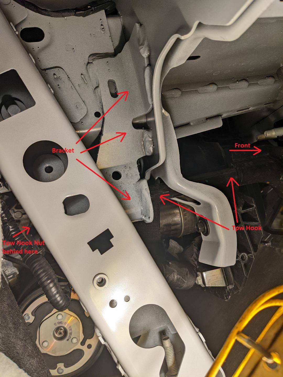

I took this picture a while ago. I pulled the felt wheel liner back and looking in from the wheel well this is how the tow hook frame bracket looks:

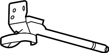

Here's the factory tow hook. Not the best image, but you can see how it reaches back and attaches to the unibody 'frame'. There are also 2 large bolts that attach it to a thick bracket at the front.
Ford Bronco Sport Tow hooks installed 1663719487759
It appears that most aligned pulling force is applied to that rear connection and the two front bolts prevent any angular forces from acting on the rear.
The aftermarket hooks rely on 2 bolts, and all pulling is creating sheering forces.
Ford Bronco Sport Tow hooks installed Tow Hook Bracket Annotated
Very helpful, thank you!

As it happens, the solid steel rod portion of the factory hooks on the BS BL (see illustration above) is significantly larger in diameter than the bolts supplied with the aftermarket tow hooks. It appears to be at least as large as the Ford towing eye, if not larger.
The 2 front bolts would seem to have primarily a shearing force on them with an off-axis recovery. They also appear to take some of the load with a straight pull.
