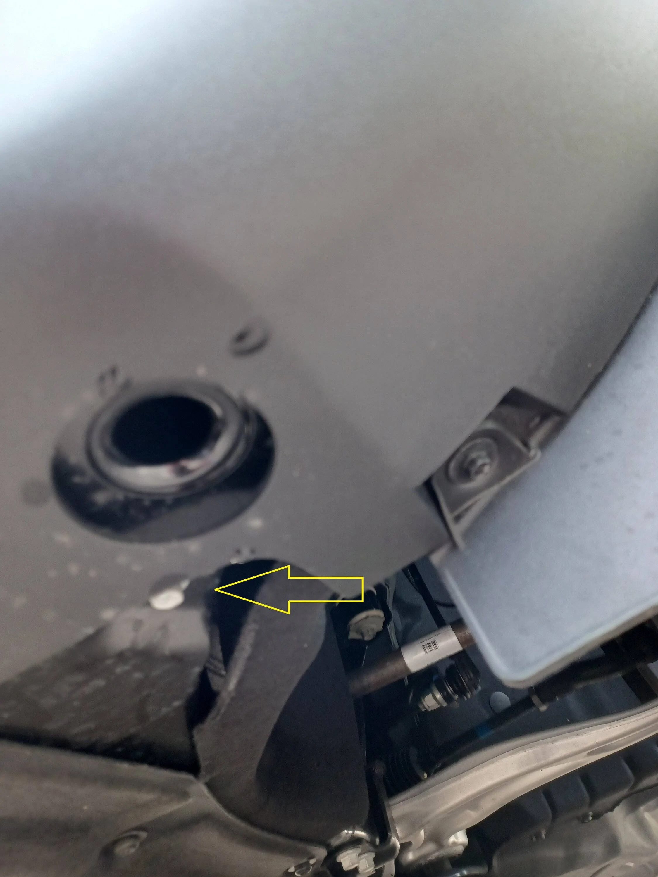

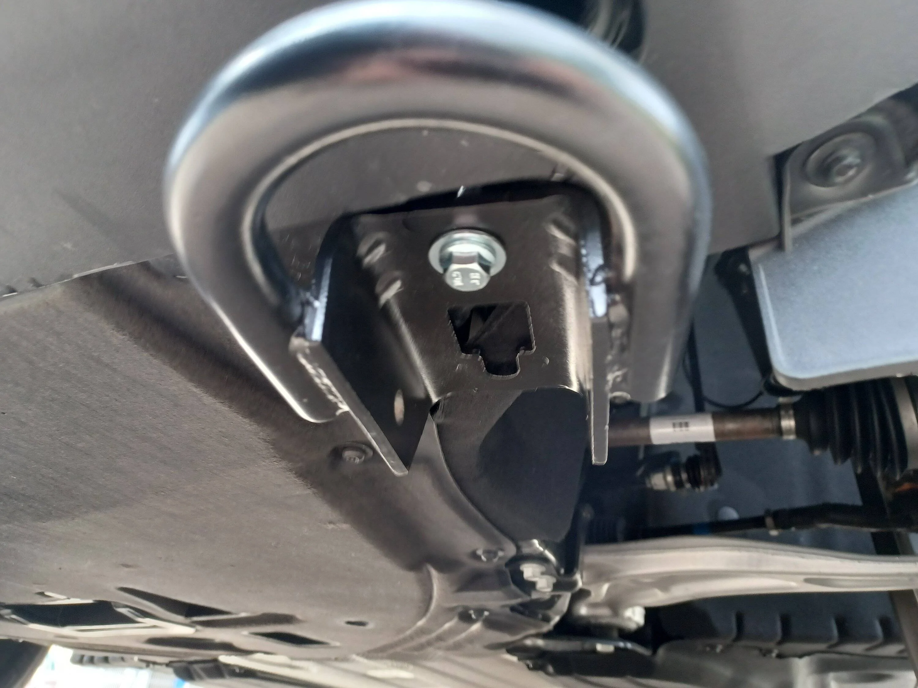

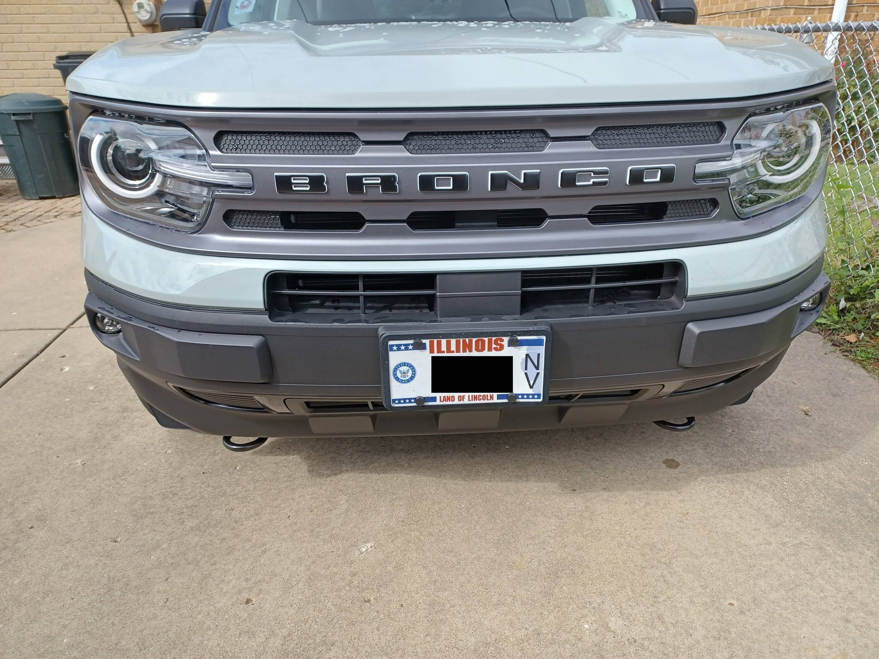

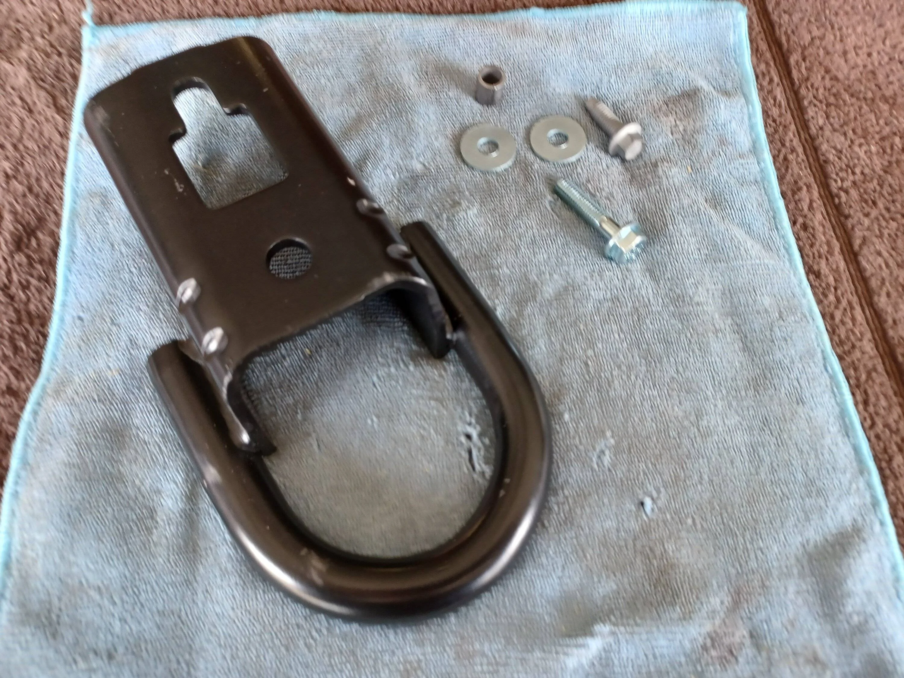

Inspired by this post... I got a set of FL3Z17A954C Tow Hooks (for an F150) and bolted them up under the Bumper, There's an M8 1.25 pitch screw under there on a metal bracket... The hardware I used to replace the screw is in the pic. Yes... There's only one screw holding them on; No... I ain't gonna try to get towed off of them. Put these on mostly for show, but I'd trust them as a front tie-down points.
