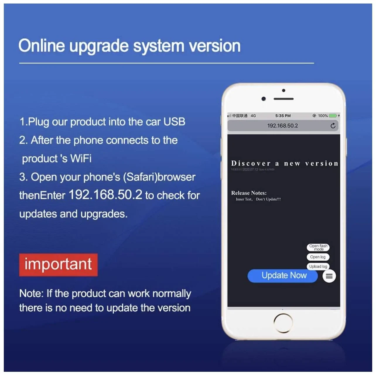

I just received mine but I am having trouble setting it up. I plug it in and nothing happens. Any and all help is welcomed and needed. thanks
It’s possible yours has a different firmware version on it. Have you tried these steps to update?
Ford Bronco Sport Wireless CarPlay Adapter? 7CEC6178-05E6-410B-AB51-A131D44DD0DE
I updated the sync and it connected and has been working fine the two times I drove since then. Lol. Thanks for the help!
