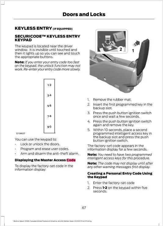

One thing to mention about Securicode is that there is a factory code, which comes on a card. It can also be displayed on the screen in the car when you follow a procedure in the manual with two already programmed keyfobs.
Via the Sync 3 settings (again, see the manual), you can program a custom Securicode entry code. This is particularly handy if a code is more memorable to you, or if you own multiple Ford vehicles with Securicode. My experience has been that this is stored in a non-volatile way (namely, if the battery dies, the custom securicode isn't wiped out and still works.)
The code can also be found on a sticker attached to the BCM and, on some older model Fords, stamped into the trunk hinge.

Yes. Well. Mostly yes. Maybe 90% yes. It tells you exactly how to get the code, but the visual that goes with it is obscenely wrong. At least, it is wrong in my 2021 book. The pad to put the key on is under the rubber mat by the 12v port in the phone cubby, not in the console as demonstrated. Putting it in the console will do nothing to display the code.
