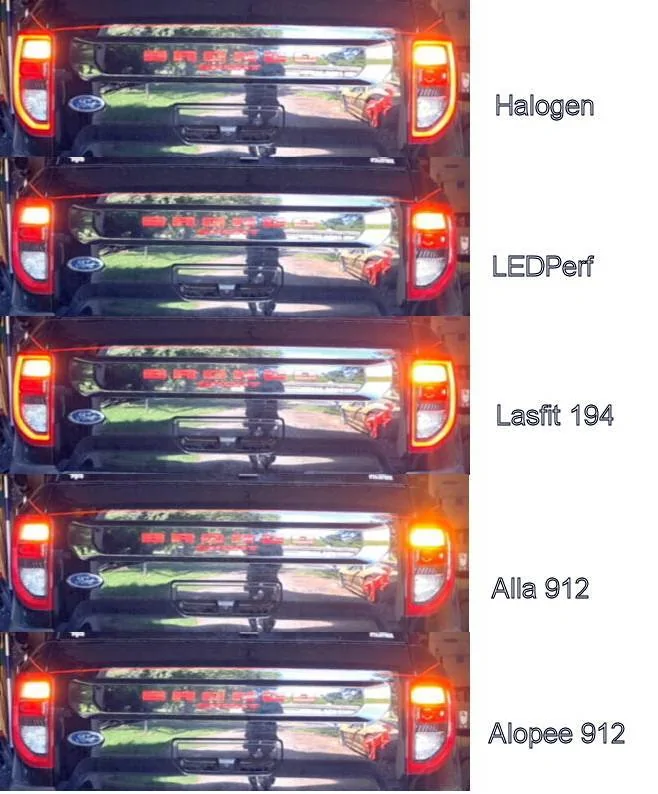

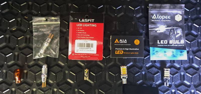

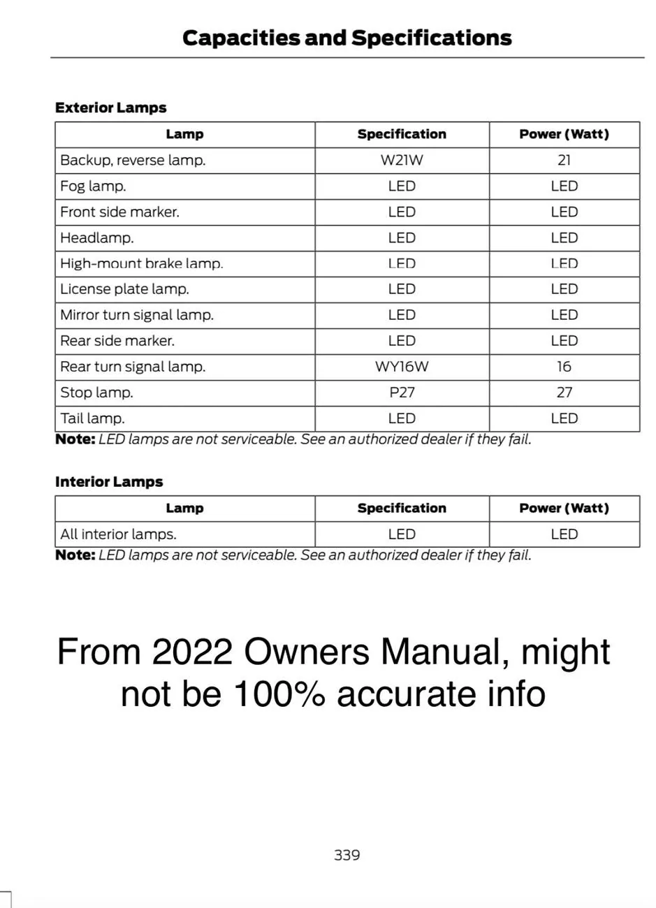

Thank you for doing the Turn Signal LED bulb comparison and posting comparison pics.
updated with info from RushMan:
OE: Rear turn signal lamp.
Specification: WY16W
Power (Watt): 16
“CANbus error-free”
All specifications below are best effort info, please verify any info of interest.
LEDPerf:
T15 bulb 916NA WY16W 16 Leds CREE - Ultra Powerful - Orange
Part #: TBD
Color: Orange
Lumens: 1600
Watts per bulb: TBD
Cost: $27.48 each
Radiation angle: 310°
Dimensions: 47mm L x 14mm W
https://www.ledperf.us/t15-bulb-916na-wy16w-16-leds-cree-ultra-powerful-orange-p-30346.html
“on-board computer (OBC) error-free LEDs”
https://www.ledperf.us/leds-and-kits-for-ford-=c=-985_3782.html
LASFIT 194 168 T10 2825 W5W LED Bulb Canbus Error Free, Non-Polarity 400LM
Part #: LX001-T10/194A
Color: Amber Yellow 3000k
Lumens: 400
Watts per bulb: TBD
Cost: $10 less 10% (pack of 2)
https://www.amazon.com/gp/product/B07B9WHXVY/ref=ppx_yo_dt_b_search_asin_title?ie=UTF8&psc=1
Notes: ?? Others used Lasfit 921, Amazon in Amber
Alla Lighting T15 Base 912 921 LED Bulbs, Amber Yellow Turn Signal
Part #: Alla-921-4014-48Y-Yellow
Color: Amber Yellow TBDk
Lumens: TBD
Watts per bulb: 6.5 ??
Cost: $17 (pack of 2)
https://www.amazon.com/gp/product/B07K1626VQ/ref=ppx_yo_dt_b_search_asin_title?ie=UTF8&psc=1
Notes: “possibly too bright”
Also see:
https://a.co/d/4LDvMxy
Alopee 922 912:
LED Bulb Amber Yellow Turn Signal Bulbs Non Polarity Canbus Error Free W16W LED
Part #: 921 912 T10 T15 ( 12V-18V )
Color: Amber Yellow 6500k
Lumens: 800
Watts per bulb: 4.5
Cost: $12 (pack of 4)
Length: 40mm (1.57")
Diameter: 15mm (0.59")
https://www.amazon.com/gp/product/B06Y2GQP23/ref=ppx_yo_dt_b_search_asin_title?ie=UTF8&th=1
Notes: @RushMan installed the Alopee turn signal LEDs
Also see:
https://a.co/d/4x83HAb
OE Specification: WY16W
OE Power (Watt): 16
@RushMan do you still have the part numbers handy for these 4 that you compared? I’m looking up some of their specs.
LEDPerf:
Part #: TBD
Color: TBD
Lumens: TBD
Watts per bulb: TBD
Cost: TBD
None listed for Bronco Sport?
Lasfit 194:
Part #: TBD
Color: TBD
Lumens: TBD
Watts per bulb: TBD
Cost: TBD
“CANbus error-free”
Alla 912:
Part #: TBD
Lumens: 2000
Watts per bulb: TBD
Cost: $12 (pack of 2)
“CANbus error-free”
Alopee 912:
Part #: TBD
Color: Amber Yellow 6500k ??
Lumens: TBD
Watts per bulb: 4.5 ??
“CANbus error-free”
Notes: @RushMan installed these
Ford Bronco Sport What did you do TO your Bronco Sport today? IMG_3474
Ford Bronco Sport What did you do TO your Bronco Sport today? IMG_3473
Ford Bronco Sport What did you do TO your Bronco Sport today? IMG_3472
I've misplaced the original bulbs and packaging, but was able to find the links to the Amazon pages.
Manufacturer Part Number ‎Alla-921-4014-48Y-Yellow
Item model number LX001-T10/194A
Alopee 922 LED Bulb Amber Yellow Turn Signal Bulbs Non Polarity Canbus Error Free W16W LED
Item model number ‎921 912 T10 T15 ( 12V-18V )
LEDPerf
No part number, just a description on my receipt.

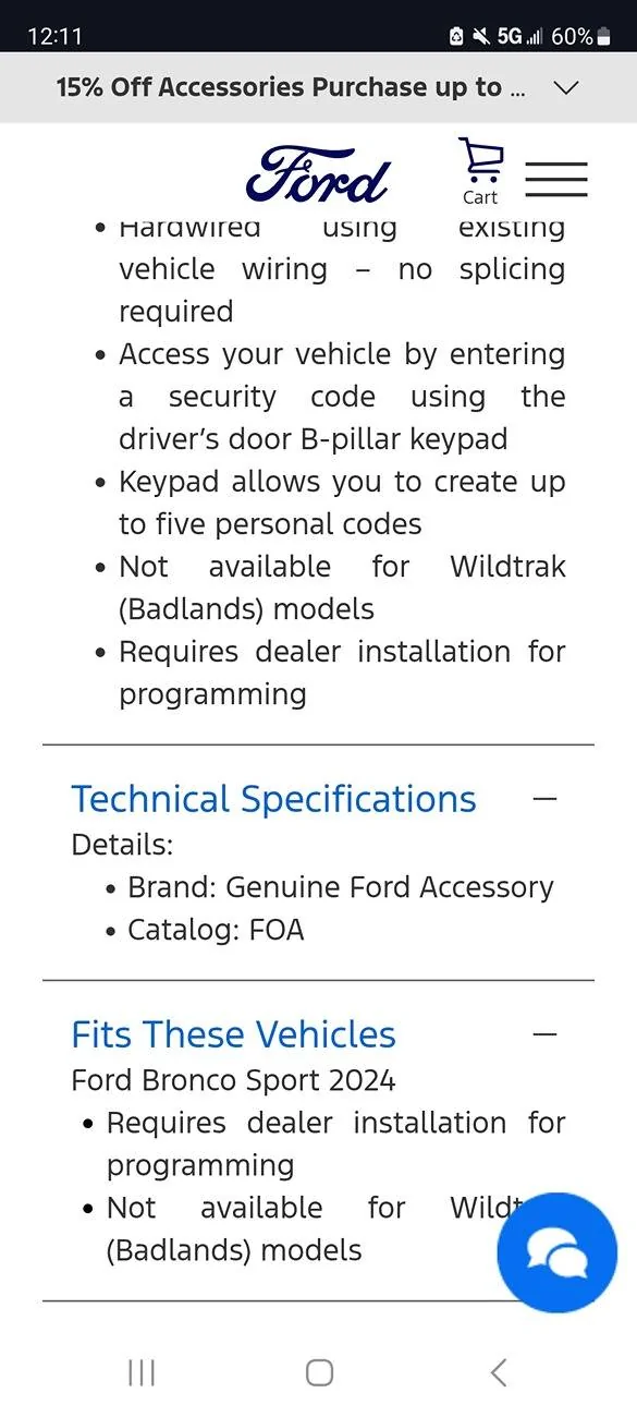

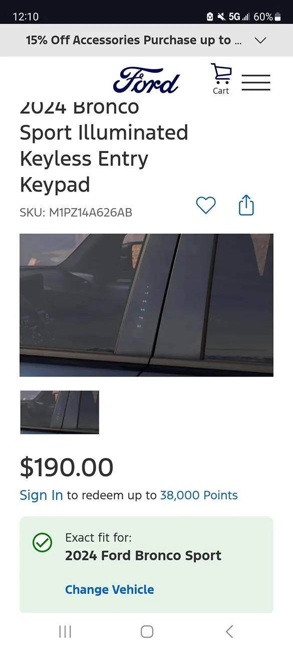

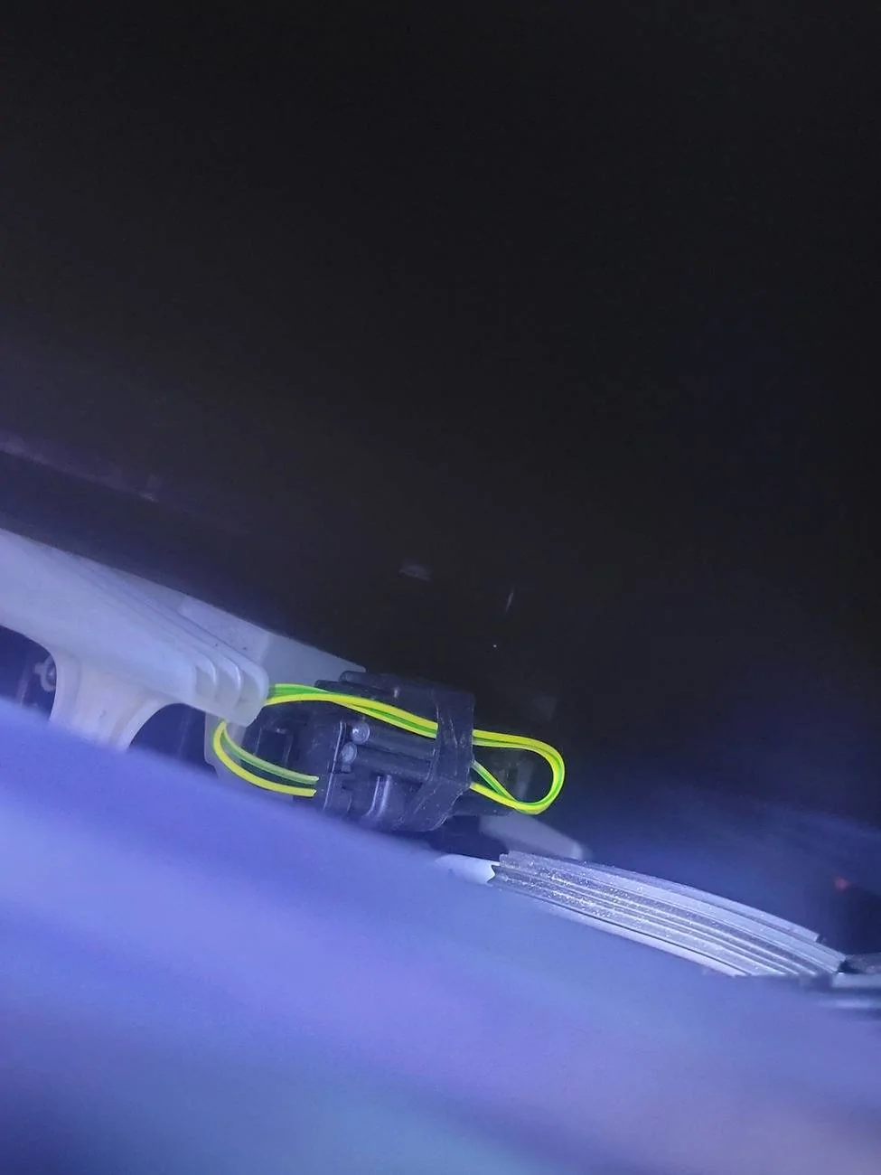

Took apart the driver door panel just enough to get a peek to see if the harness for illuminated keyless entry pad is present. One thing our big bend had that this badlands doesn't, (also the rear folding headrests) Had to check for myself because ford's website says not available for badlands. But the section of wire harness for this feature if there on our 2024 badlands. Will be ordering with ford points.

Odd that is shows not available for (2024) Badlands (almost as if there is some other reason even if the wiring harness is present which it is for you). Could be just a “typo”.
The Wildtrak is the Badlnds sold in the South American market
.Maybe it has some other differences in their computer modules. I ordered the keypad with my '24 Badlands as a DIO. It's weird that the numbers are blue in the Accssories image. Mine are red as on earlier Bronco Sports.

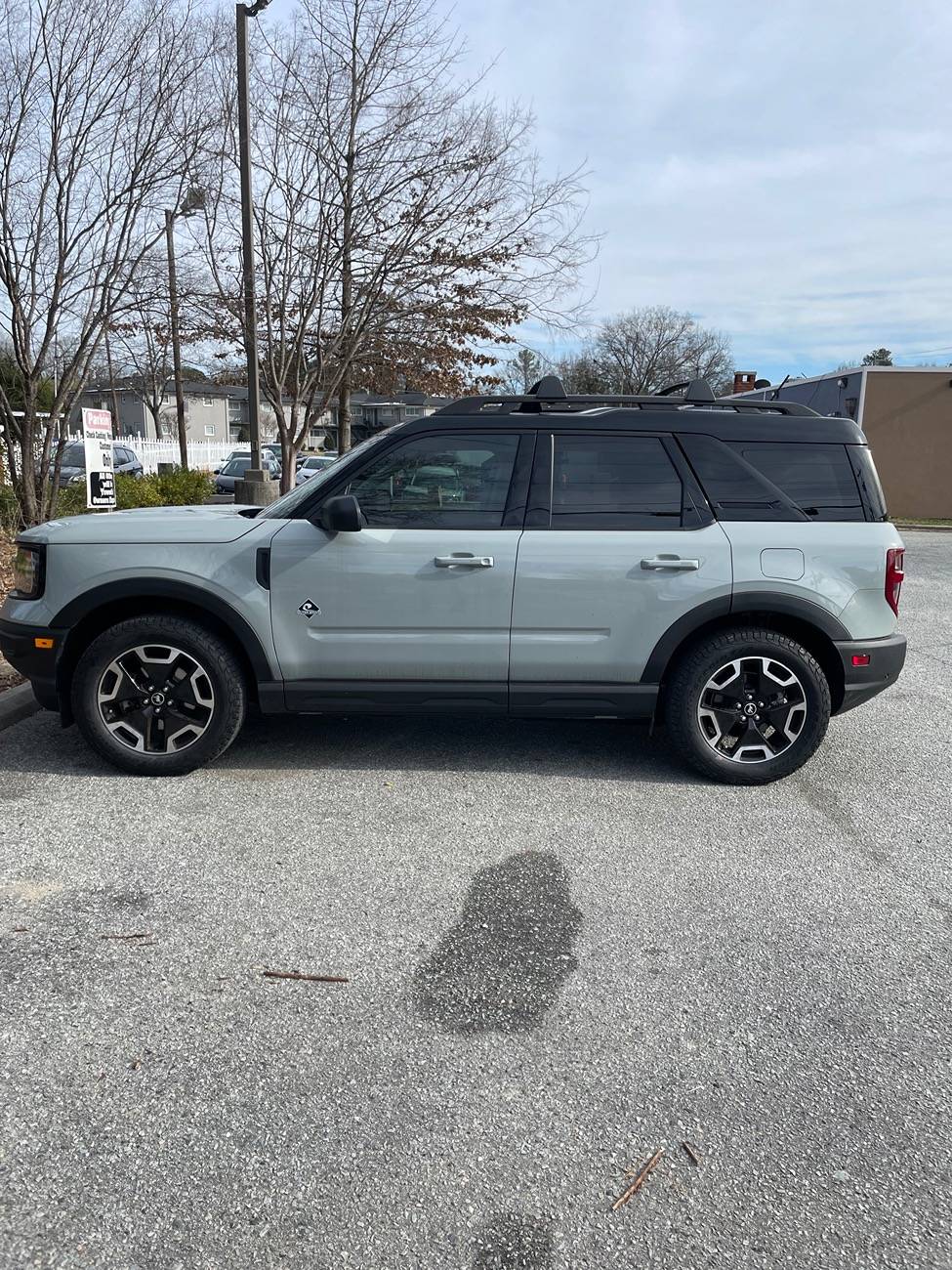

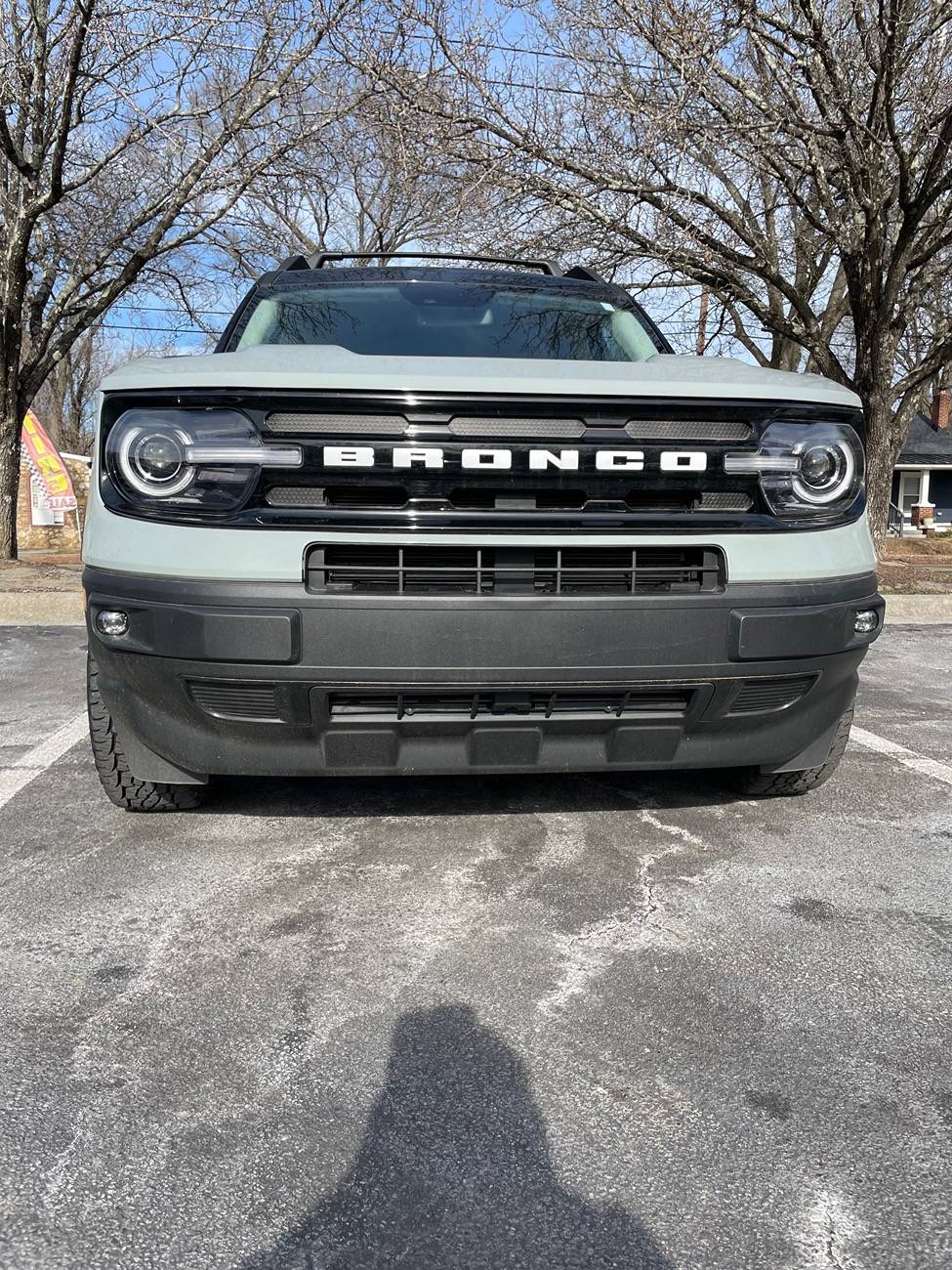

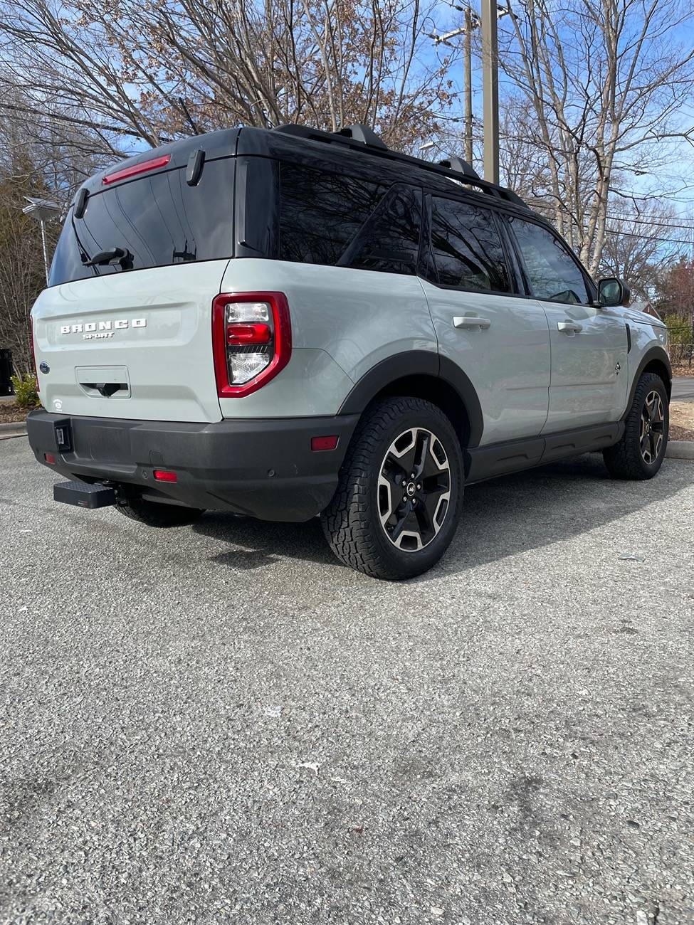

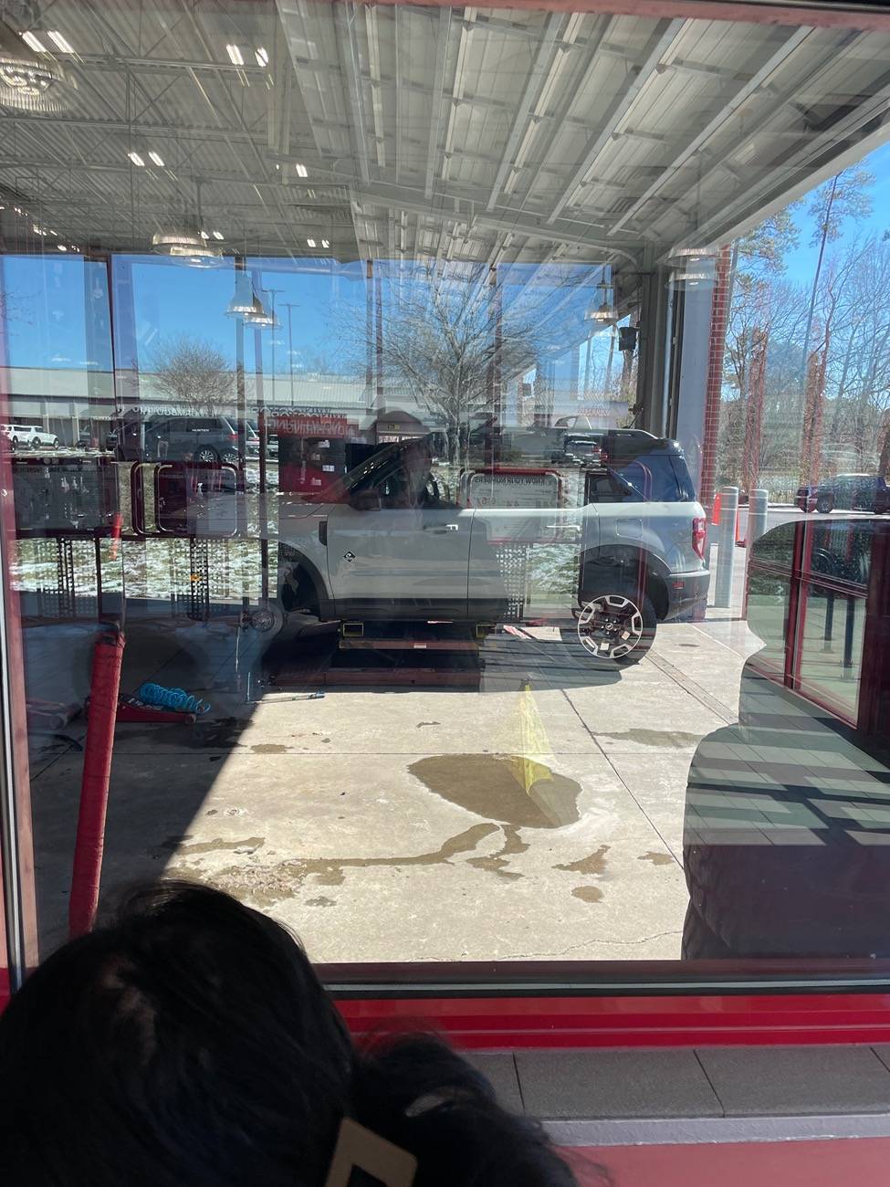

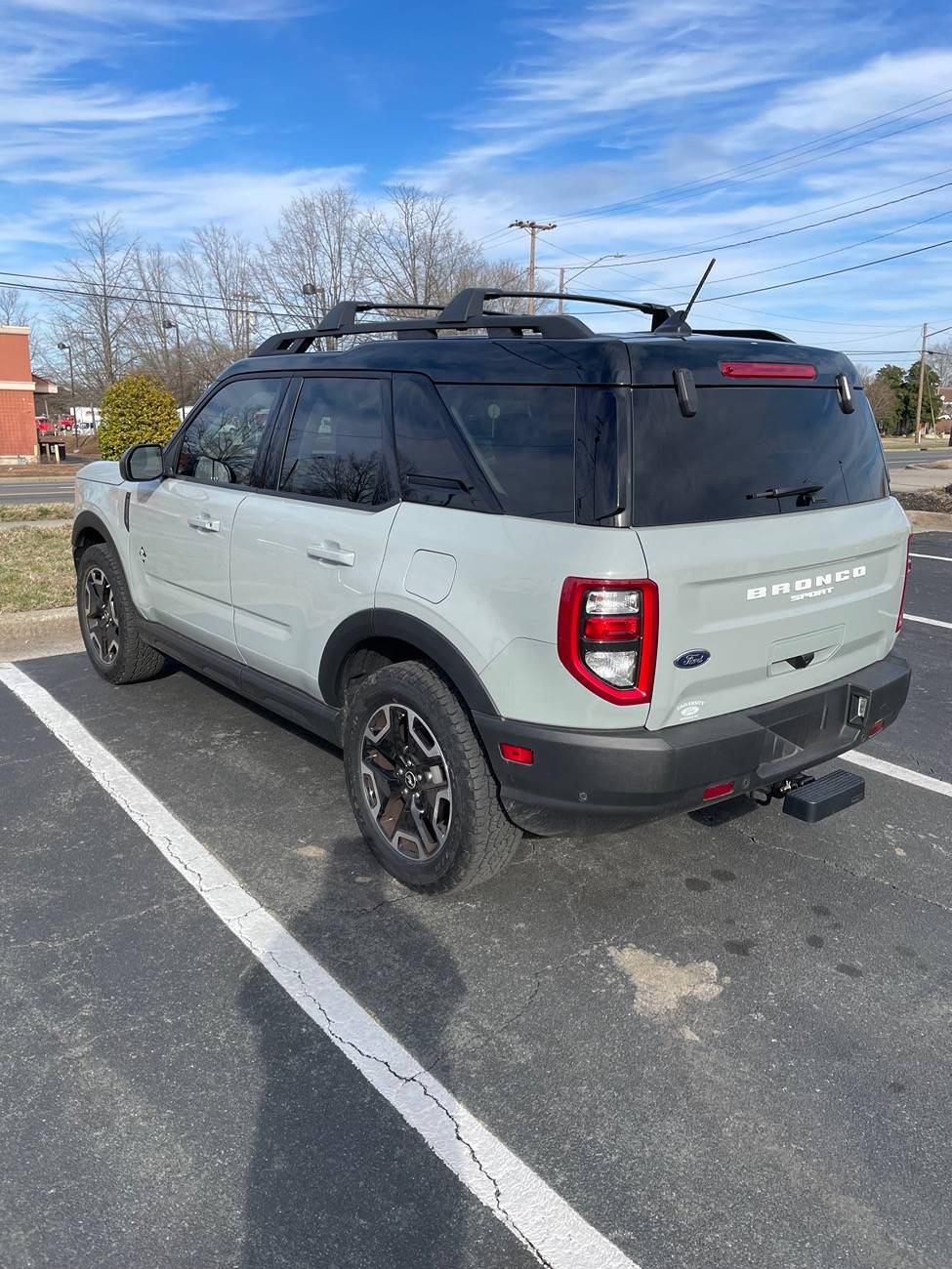

New tires finally....
BF Goodrich Trail-Terrain T/A 235 /60 R18
Ford Bronco Sport What did you do TO your Bronco Sport today? IMG_0221
Shout out to Discount Tire and Jeffrey. In and out in 45 minutes. Pics I took today were bad, will try again tomorrow. Love the look and ride...

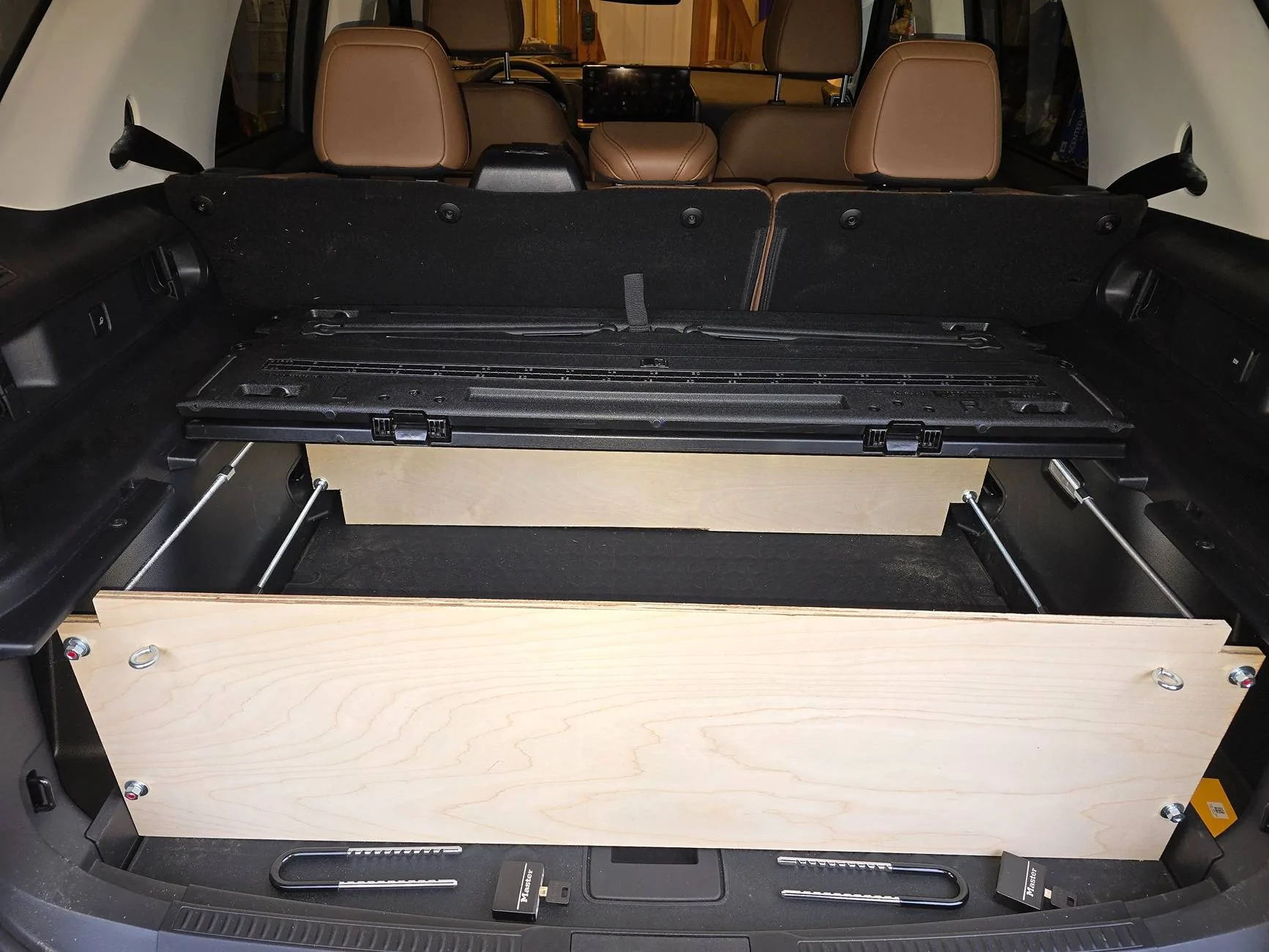

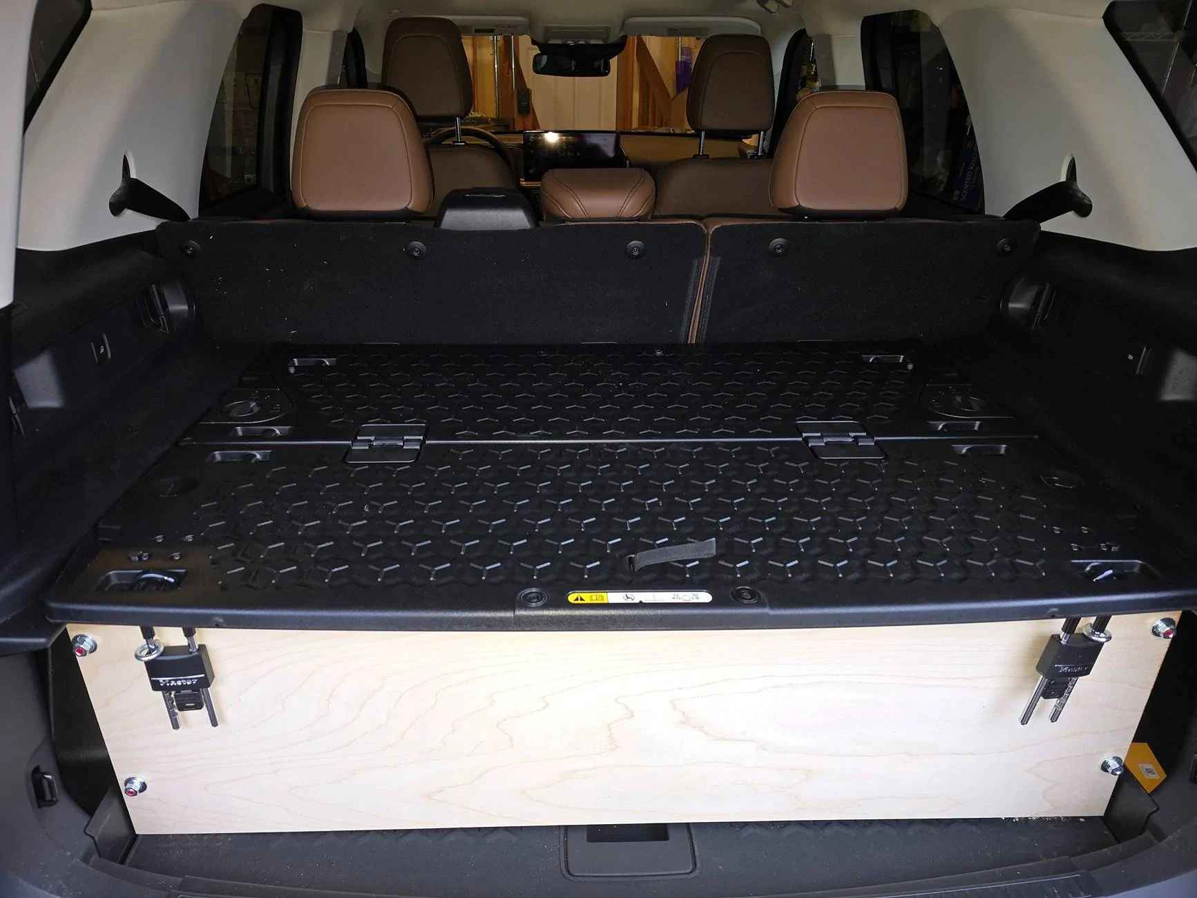

Well, having the car for 3 days now, I got my first major project done, adding locking storage.
Locking Storage under Cargo Management System
Here are a couple of pictures:
First, in and open ...
Ford Bronco Sport What did you do TO your Bronco Sport today? 20250222_164817[1]
Now closed and locked ....
Ford Bronco Sport What did you do TO your Bronco Sport today? 20250222_164943[1]
Some finish work to finish, but all the essentials in. I feel safe now carrying stuff.
