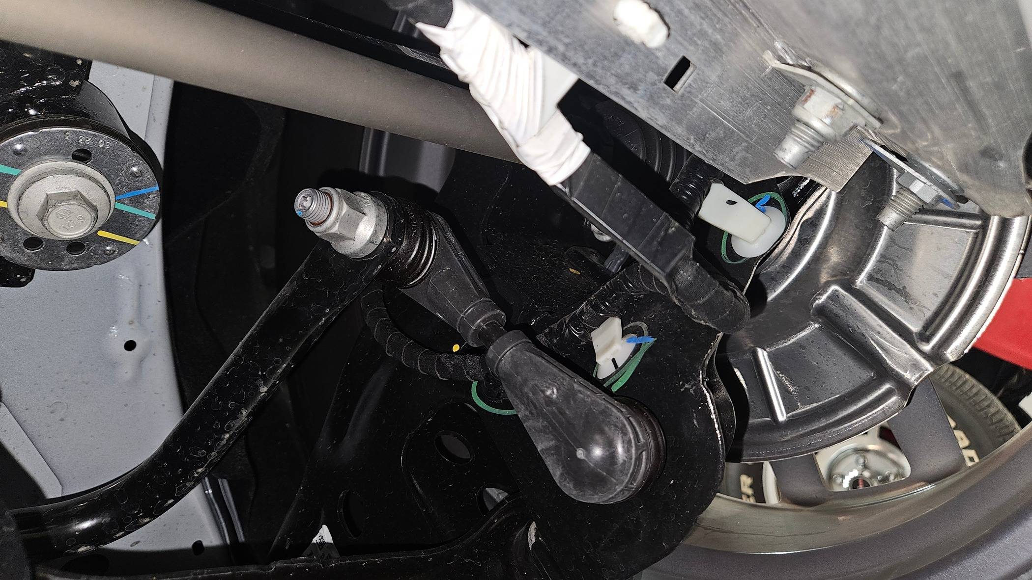

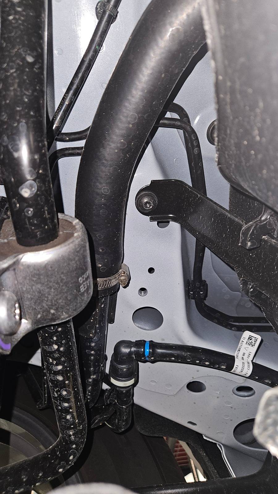

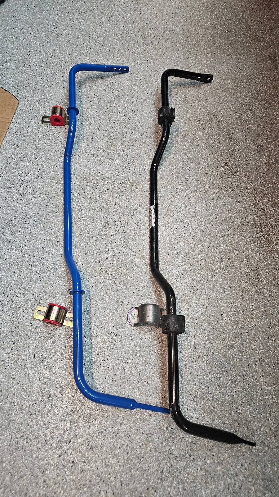

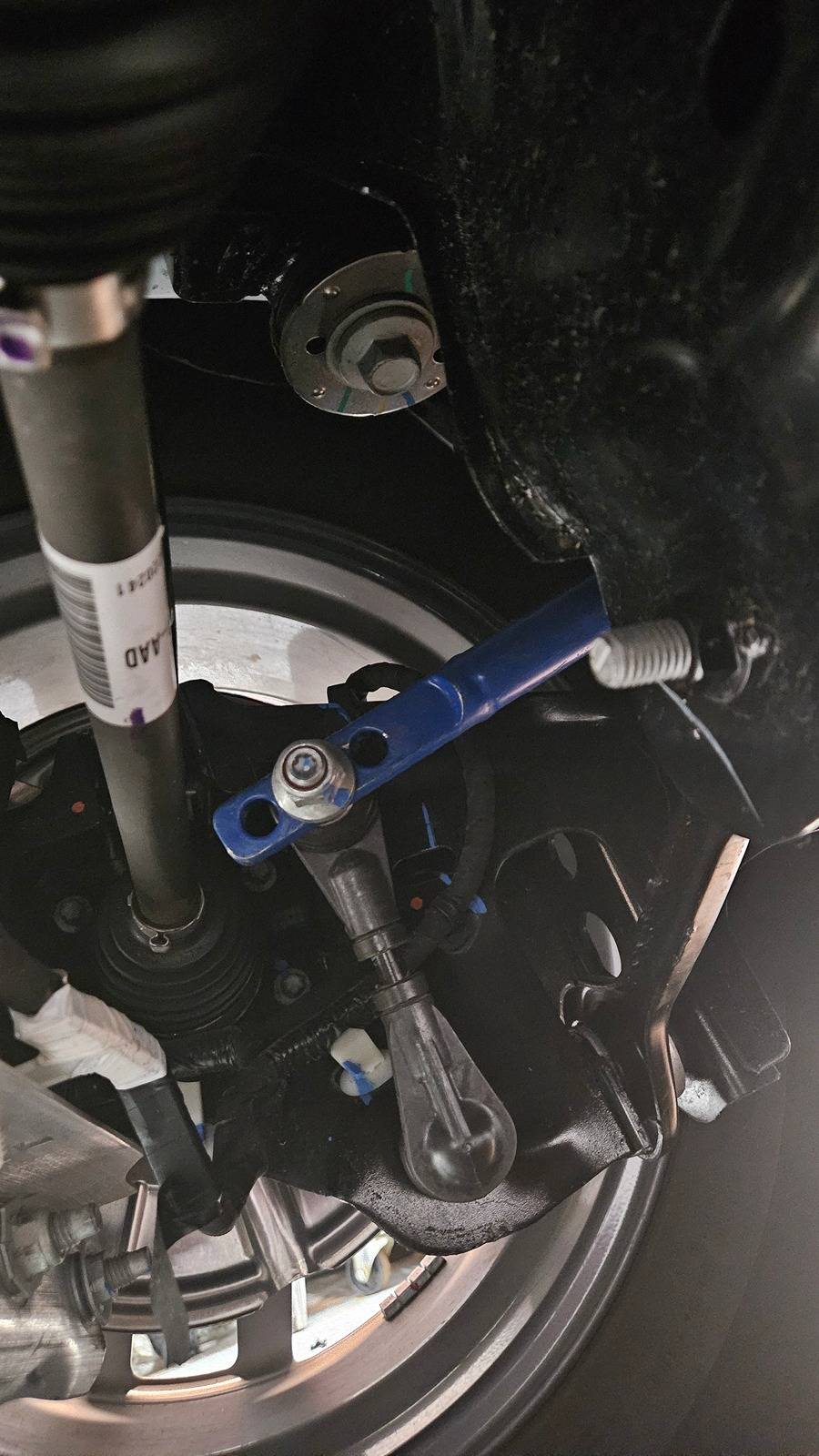

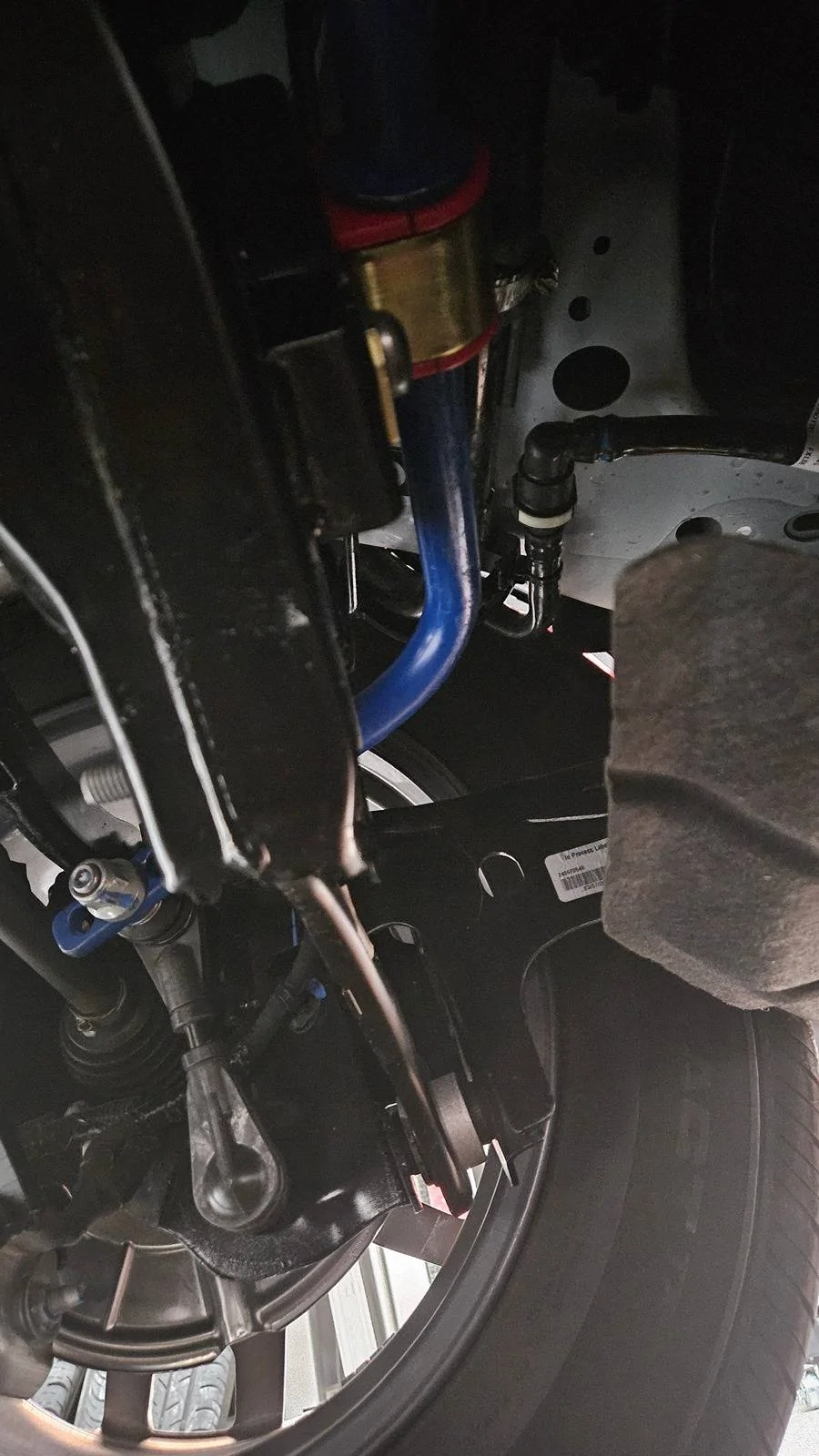

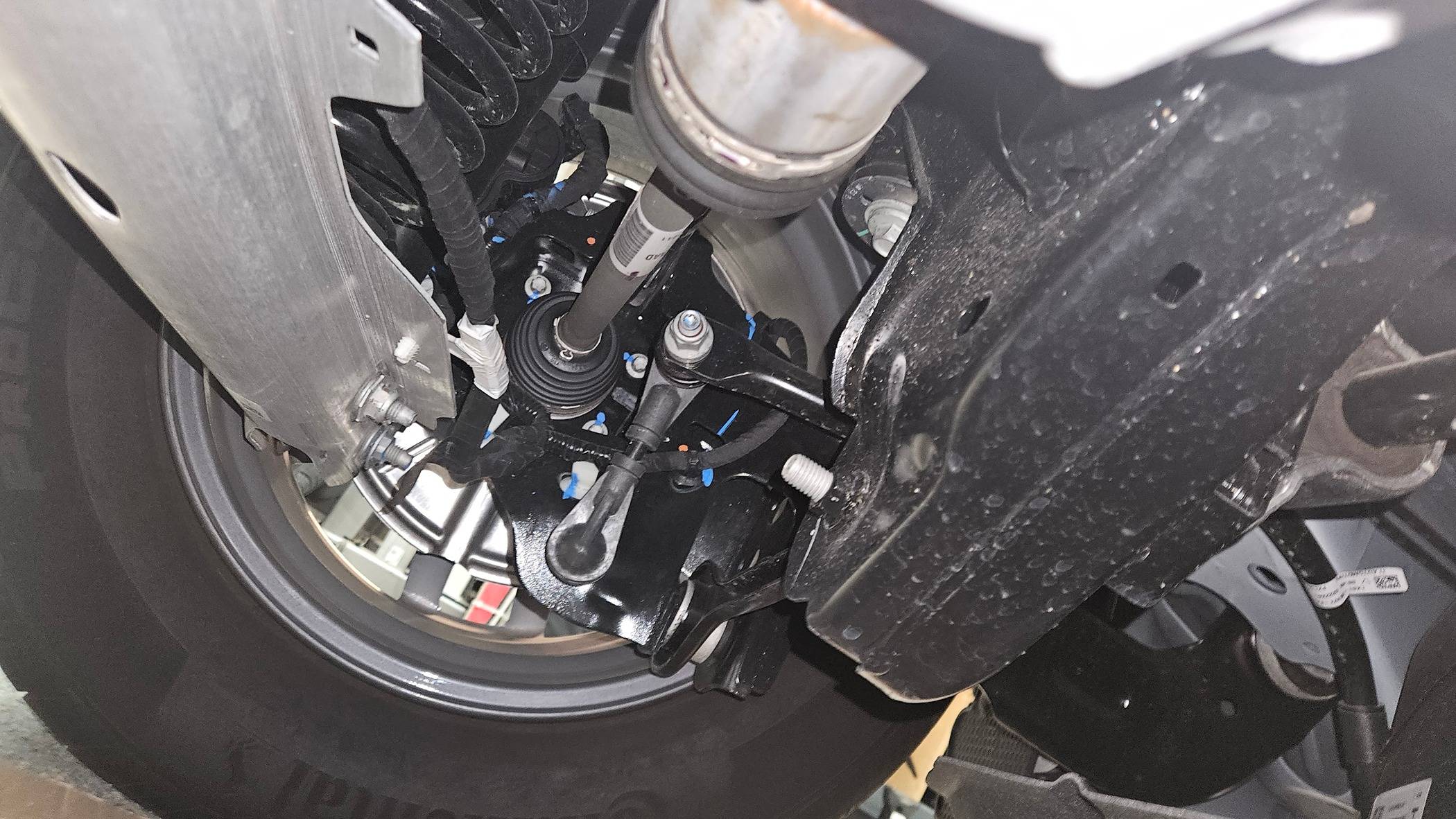

They appear to be the same diameter. Is the Steeda supposed to be stiffer or softer?Finally got a chance to install the rear sway bar. In theory it's a super easy install. In reality, getting the oem bar out and the steeda bar in is a real PITA; unless you disconnect the drive shaft. I decided to leave the drive shaft alone. Several hours later, after lots of hand nicks, some sledge hammering, metal on metal surface damage and lots of four letter words, I was able to get the steeda bar on. The geometry of the bar and the tight space is just a bad combo. Thank goodness the bar is under the car and not visible because it definitely no longer looks new. Alas, I got it installed and will update you once I take it for a test drive. Here are some before and after shots, whatever I could manage anyway.
