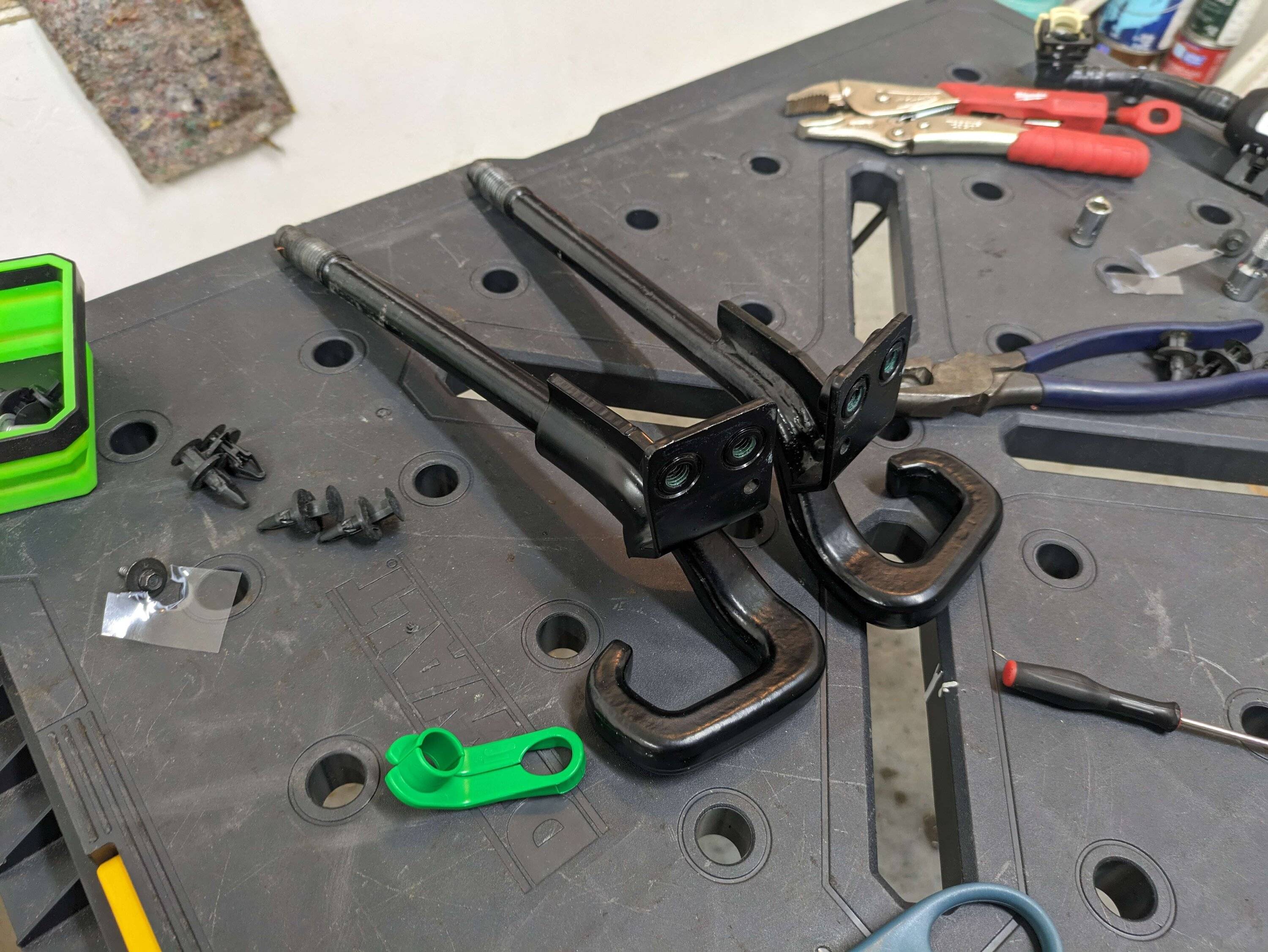

Back at it with stubborn intentions I decided it was time for a win, and sitting on my kitchen counter for 2 months has been a 30mm deep socket impact socket head (one of the few times I was able to predict a problem ahead of time) so it was officially time to remove the tow hooks, and for once things went well. All I had to do was remove 4 two-stage plastic fasteners in both wheel well in order to pull the wheel well liner out enough to reach the 30mm bolt on the back of the two tow hooks. Rear mega bolt off, all that was left were the two bolts right at the front of each hook, easily reachable through the opening for the hooks, however there isn't a ton of space to use a ratcheting socket or a ratcheting wrench, but I was technically making progress it was just slow, and loud, because the wrench was ringing the hook like a dinner bell.

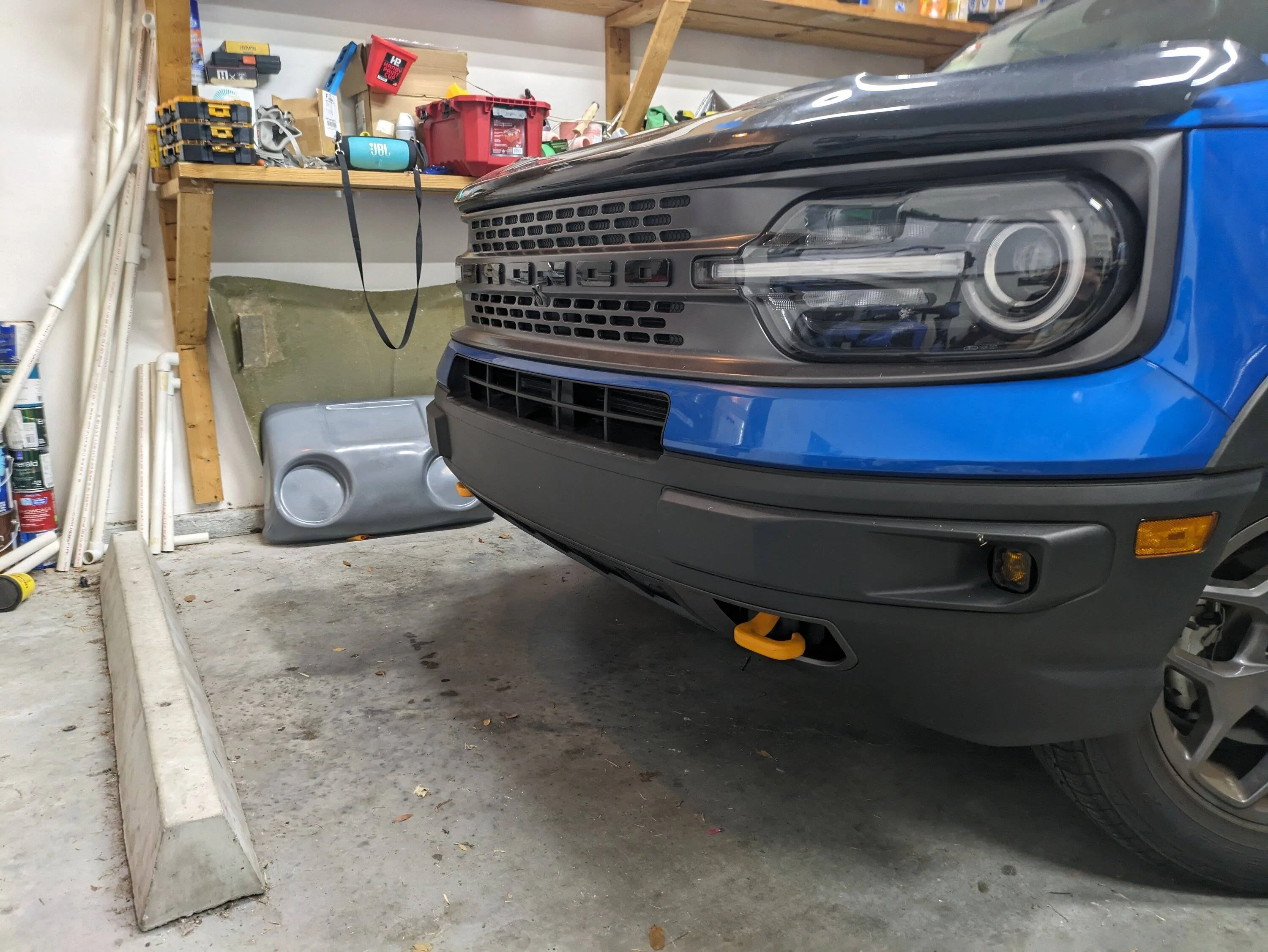

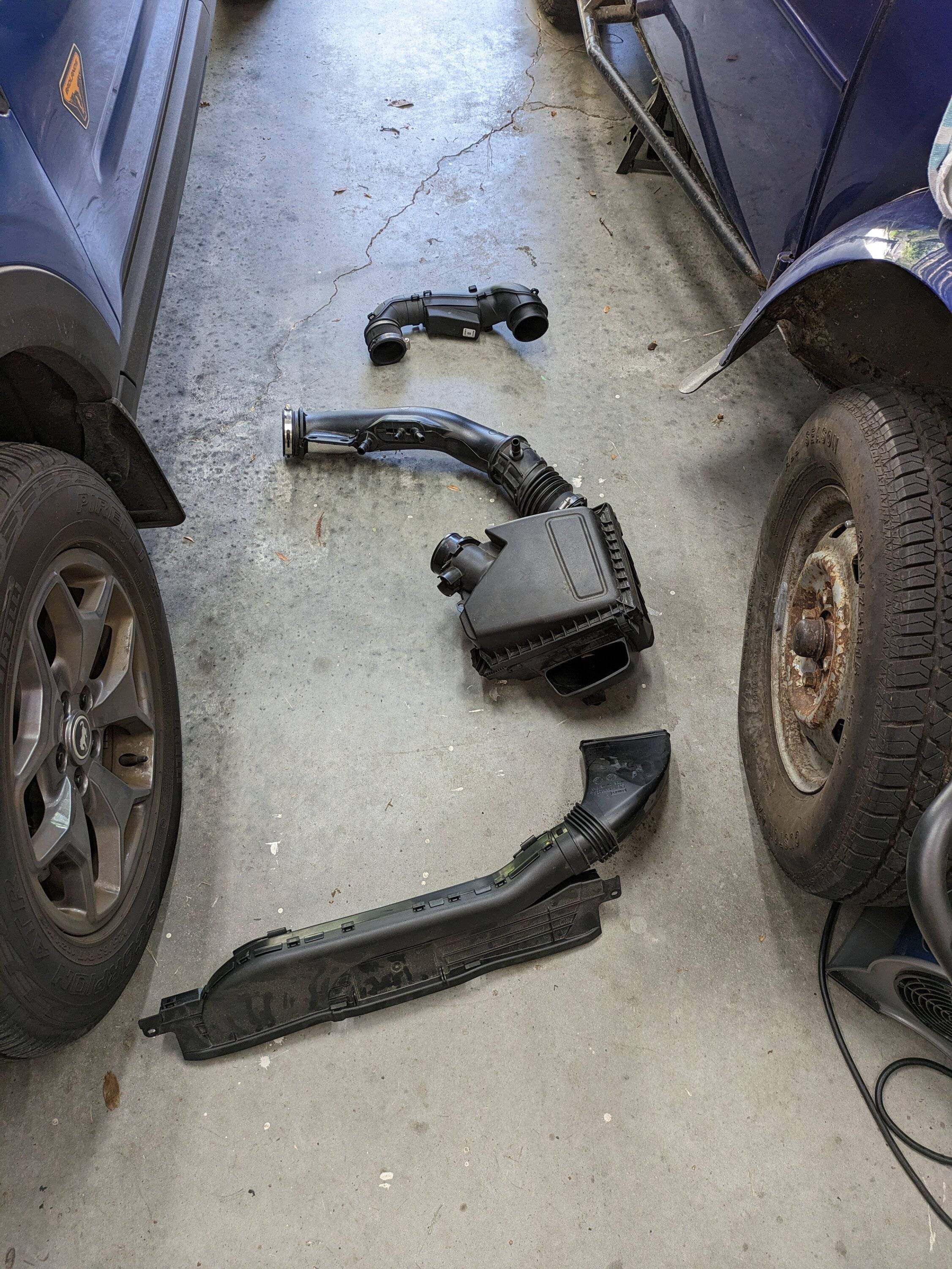

Day 2 with a very short list. Put the hooks back on after a paint job. Two layers or rattlecan followed by sanding followed by a final layer of rattlecan. Install was as annoying as taking them off as there is little to no room to work on the two front bolts on each side but I'm happy with the results. Bonus picture of all the O.E. pieces removed from the S&B Intake install

Heck yeah, tow hook twins!

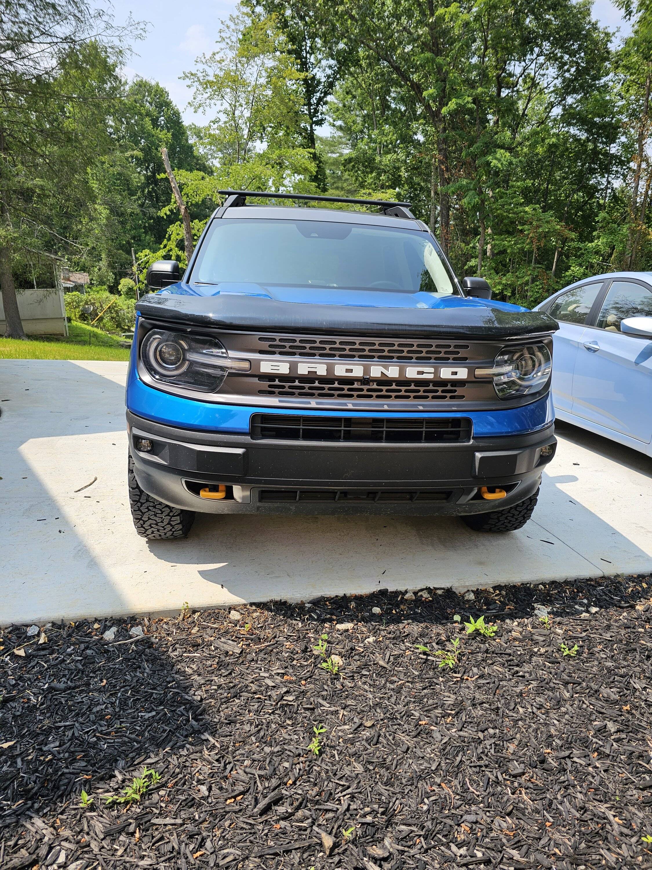

I so want to do this to my tow hooks. I have all the time, just not sure about the motivation. I don’t think the prep and painting will be a problem. It’s the removing them and putting them back on.

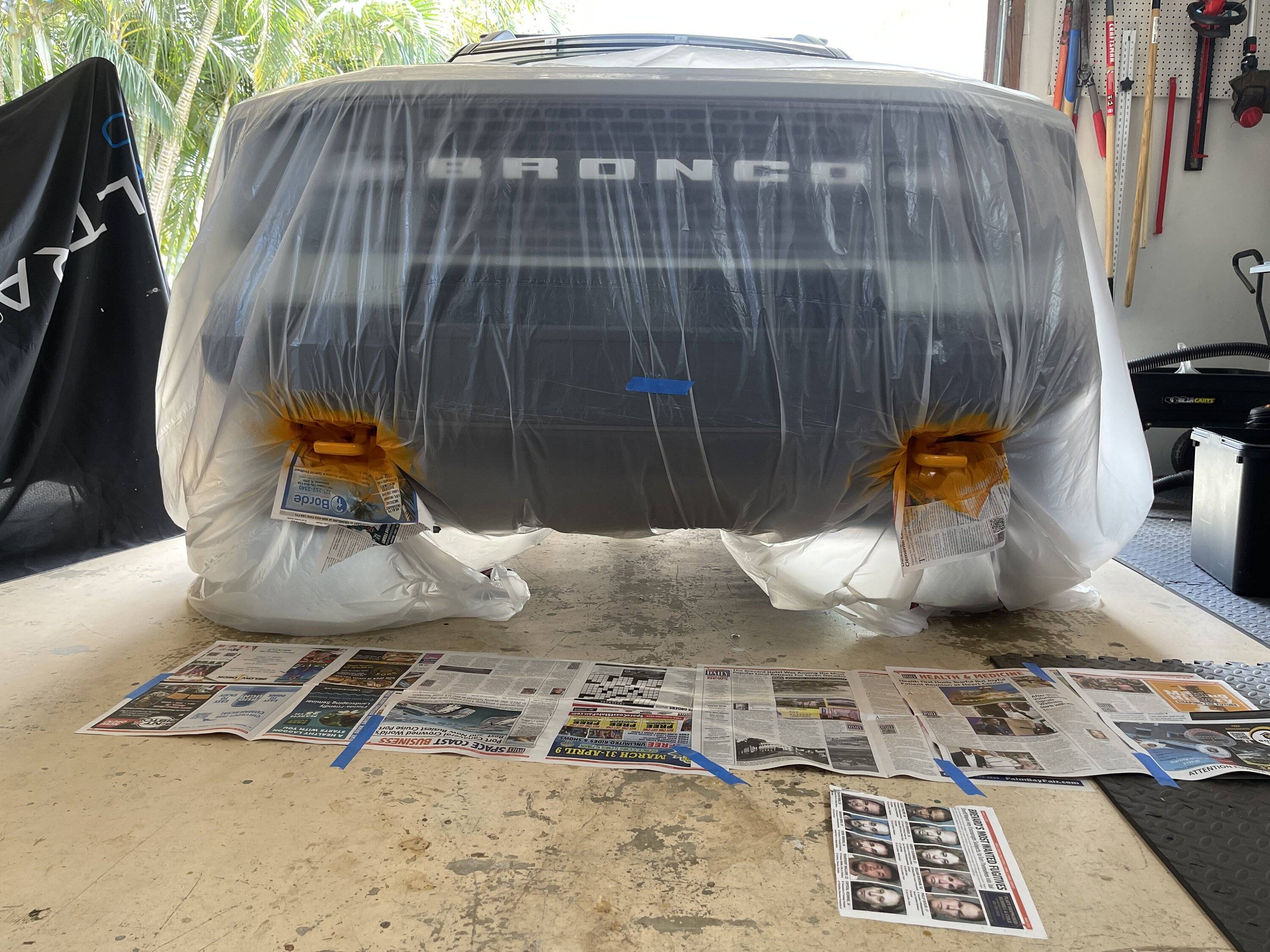

I didn't want to remove them either. Just paint them while they are still on. Takes ten minutes to make sure you've got them isolated.

Like Jmuns, i also used Montana Gold
