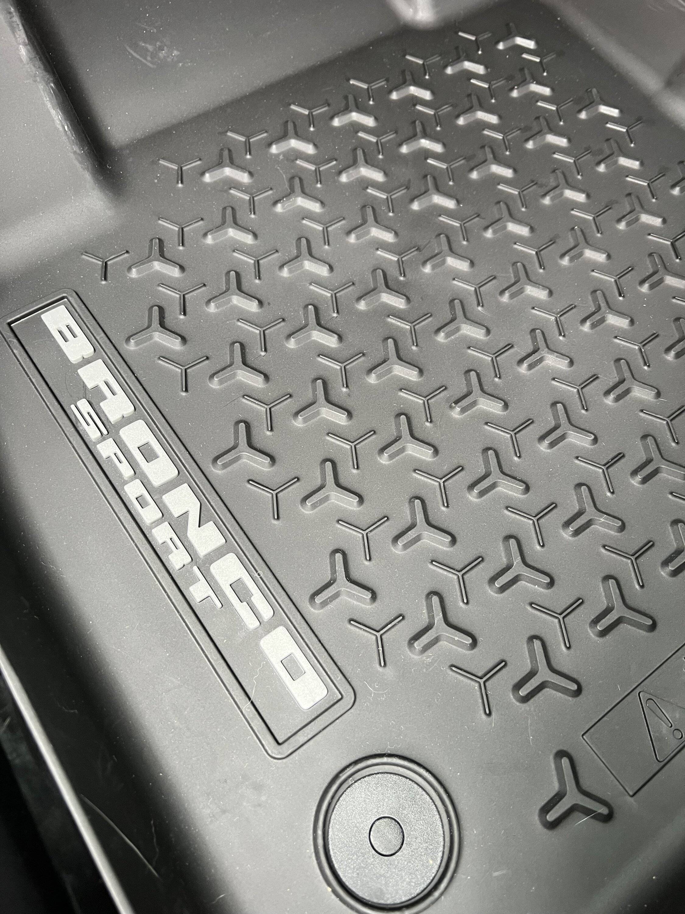

Put in the rubber floor mats….

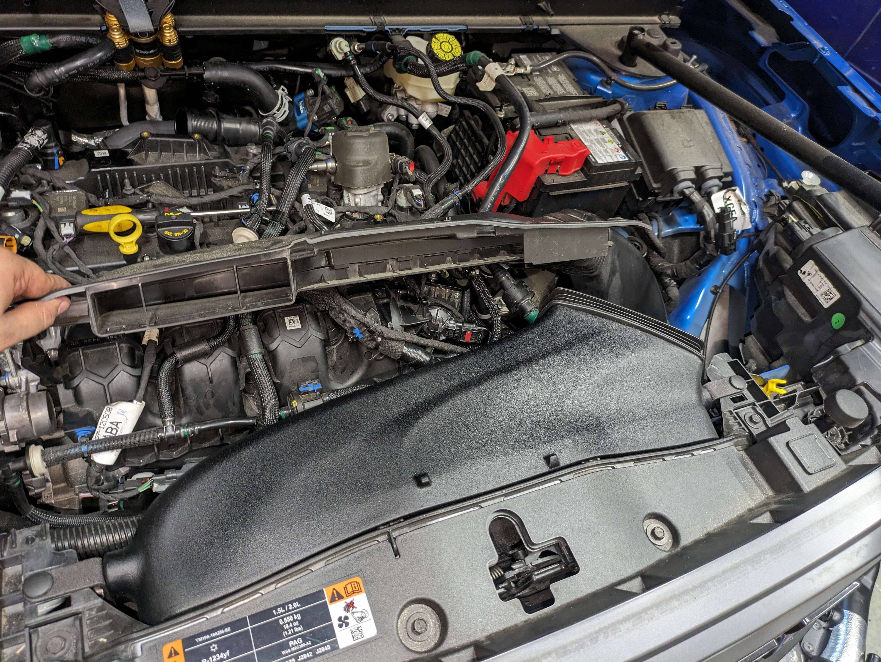

Hooks off it was back to the Air intake. The plastic quick disconnect tool did its job and I continued to remove all the sensors. Armed with a youtube video from S&B of them installing it on a Maverick and a very detailed PDF with color pictures from S&B o continued forward not knowing what hell awaited me. One inconspicuous part of the instructions and video detailed loosening the hose clamp that connects the Intake to the turbo, its at the back of the engine and the way the hose clamp was positioned, there was only one way to to loosen the hose clamp and there wasn't room. I'm not a small person, not muscular per say either, but I have literally 50+ cuts and scrapes on both of my arms, mostly knuckles and forearms, and id say half of them drew blood. I couldn't stop, but forward was painful and slow.
I'm not into lying to make myself look better, I started at 2pm, it was 11pm when I finally got to test drive the car to make sure everything was put back together properly and it wasn't going to throw codes. The new intake takes up every once of space in the engine bay, it's huge. The product replaces everything starting behind the fan shroud and up to the turbo. (Below is a comparison of the fan shroud connection replacement part, the O.E. part receives air from about 1/3rd its length , the new part the entire length is intake)
Ford Bronco Sport What did you do TO your Bronco Sport today? PXL_20230903_233141795

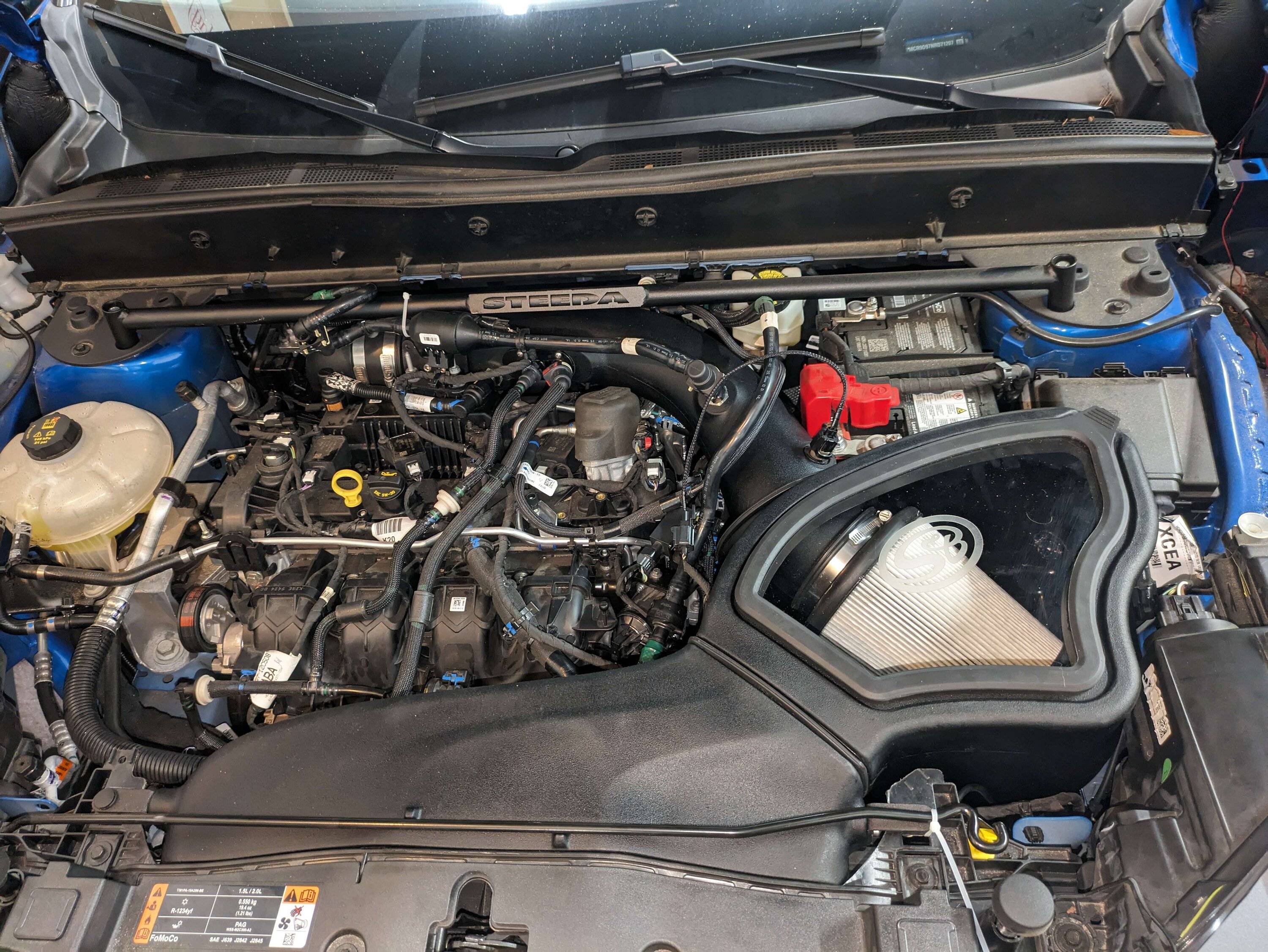

If you have the Steeda Cross brace, you will need to essentially fully remove it for this install. The thing fits, barely. And again I'm not going to lie, the driver side shroud mount bracket is not attached to the car, it's sitting about 1/2" above the hole it's supposed to secure to. See, the tricky thing is, the S&B intake has no flex tube till the downpipe to the turbo. Which means the three major pieces (Shroud connection, Airbox, primary intake tube) all connect together in one massive (not flexing) piece that dodges, ducks, dips dives and dodges and ungodly amount of pipes, sensors, hoses and wiring. I couldn't get that one tab to connect, but there is not a single piece that is loose or has room to give. It's secure and I'm not worried about it. To be honest, I can't even blame S&B, I would not hesitate to believe I screwed something up during the install. The video was great, the PDF was great, it just didn't work out smoothly for me. Looks good all things final, window is a fingerprint fiend and I had to secure a couple things with zipties because of the cross brace and secure the functionally useless proprod because I installed gas struts a while ago, I probably should just remove it entirely, but I'm leaving it there incase its broken down somewhere and I need to hit things with a bar of metal, I'm not psychic, I have no idea what that scenario could be, but it's better to have it and not need it then the opposite.
Ford Bronco Sport What did you do TO your Bronco Sport today? PXL_20230904_041420961
Didn't take pictures pictures of it, but the Tectico side marker on the passenger side positive and negative cables were torn in two. I couldn't begin to guess how that happened, it didn't look like chewing, but it is what it is. fixed the problem with some of my wiring horde I've amassed for the Beetle project. I'd hate wiring less if my crimping tool did its job. took less then a half hour and got it working again.
Test drive went well, no errors, no faults. I don't have good audio recording equipment and it had literally been 9 hours since I drove it last so I can't speak for the significance of the increase of intake noise, and I only drove it for a half hour so I can't speak for any impact (positive or negative) on MPG. And just to head it off at the start, no, I am not throwing it on a dyno to prove I didn't waste money. Like the VTA adaptor, I'm doing this for my own enjoyment, I'm doing it to make me smile (except no smiling tonight, today sucked)
