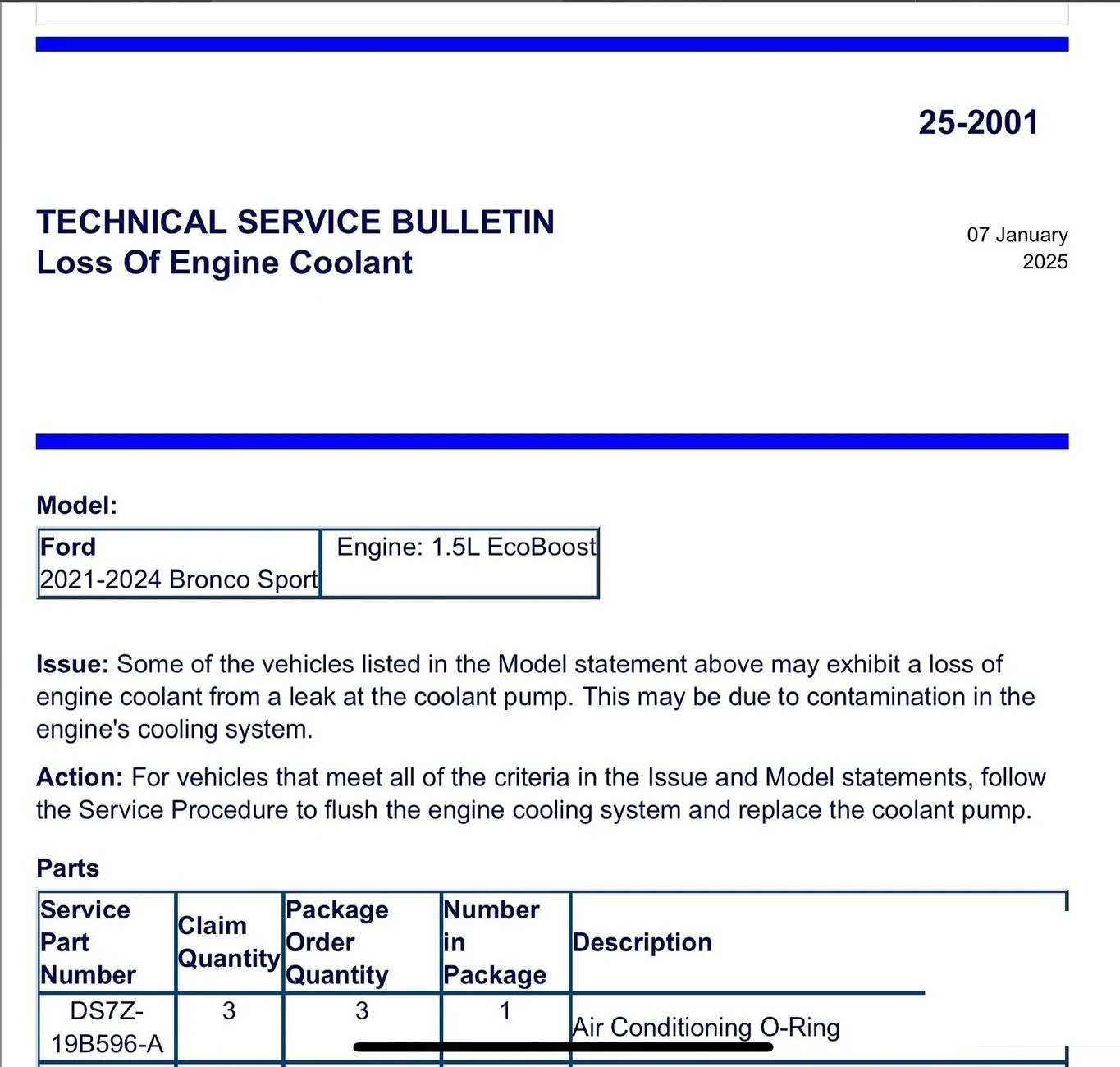

My understanding is there are 2 water pump part numbers for 1.5L ā€˜21-ā€˜24 Bronco Sports and owners have posted both pumps can leak. And it is not sudden information as owners have been reporting water pump leaking for several years.
There are many posts about the root cause and one cause could be casting sand that was not flushed out during manufacturing of the 1.5L engine although on that topic, at least 2 Ford Techs (alleged) have posted their disbelief on the casting sand as the cause.
One source of information is TSB 25-2001 and you can find Technical Service Information for your Ford Bronco Sport here:
https://www.ford.com/support/service-information/
