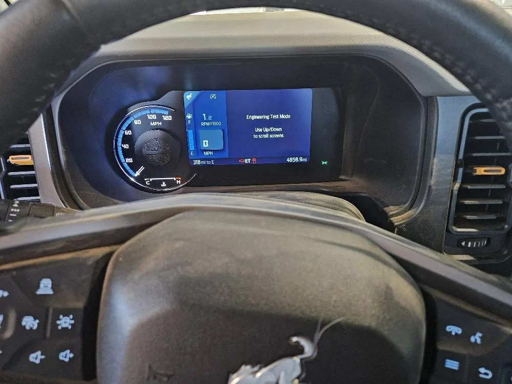

Thanks for the reply to what I know is an old thread, Dude. Yes, those are the instructions I used. Additionally, some Ford model instructions say wait for all screens off, or some other variation. I've tried a couple dozen times. I also tried the above "Diagnostic" mode just now with no success. I also just tried our '23 full-size Bronco and it works fine - see pic. While I can certainly live without it, I would very much like to make the Sport tell the truth regarding MPG ? once I know the correct setting.

I hope someone who has been successful in the past will try it and see if it still works for their Sport. As I mentioned and showed in the pic, it does still work in our '23 full-size Bronco.

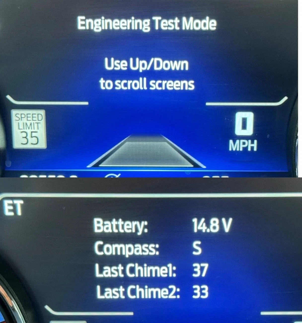

@BruceAZ ET Mode works on my ‘22 Badlands, used steps 1&2 in Post #32
For those that like to see their battery voltage displayed, I included a pic of that too…
