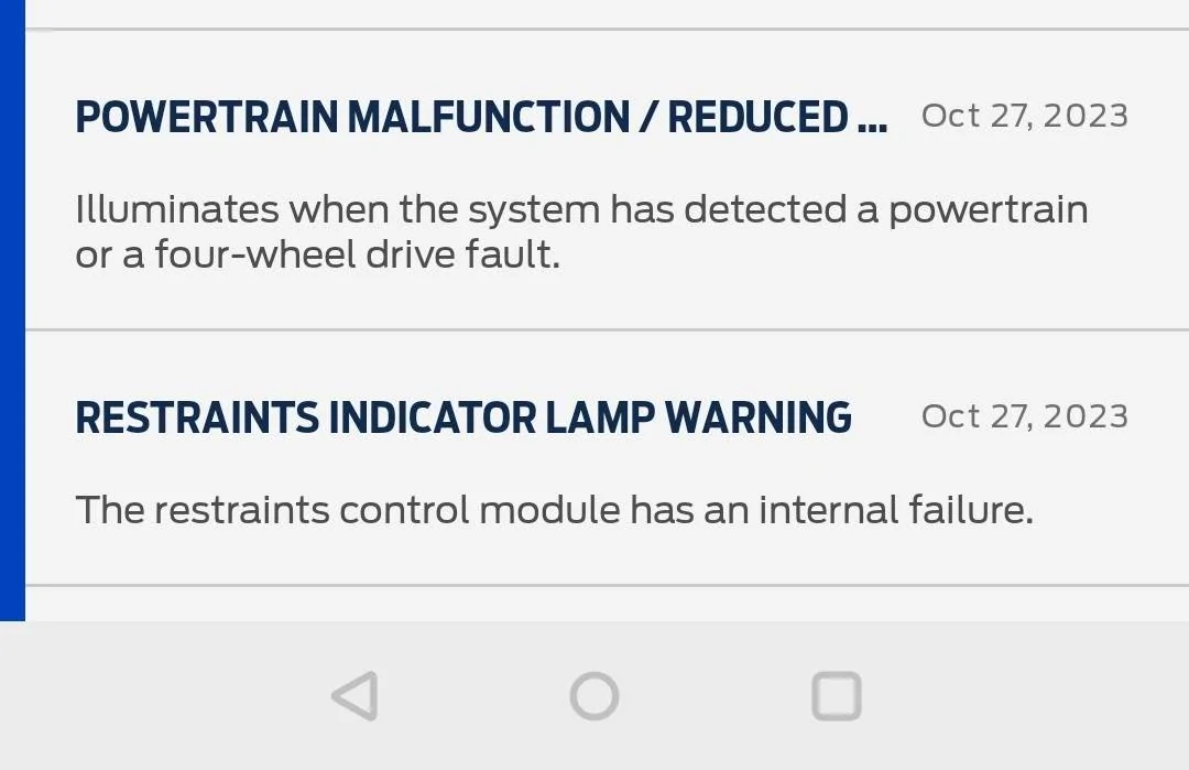

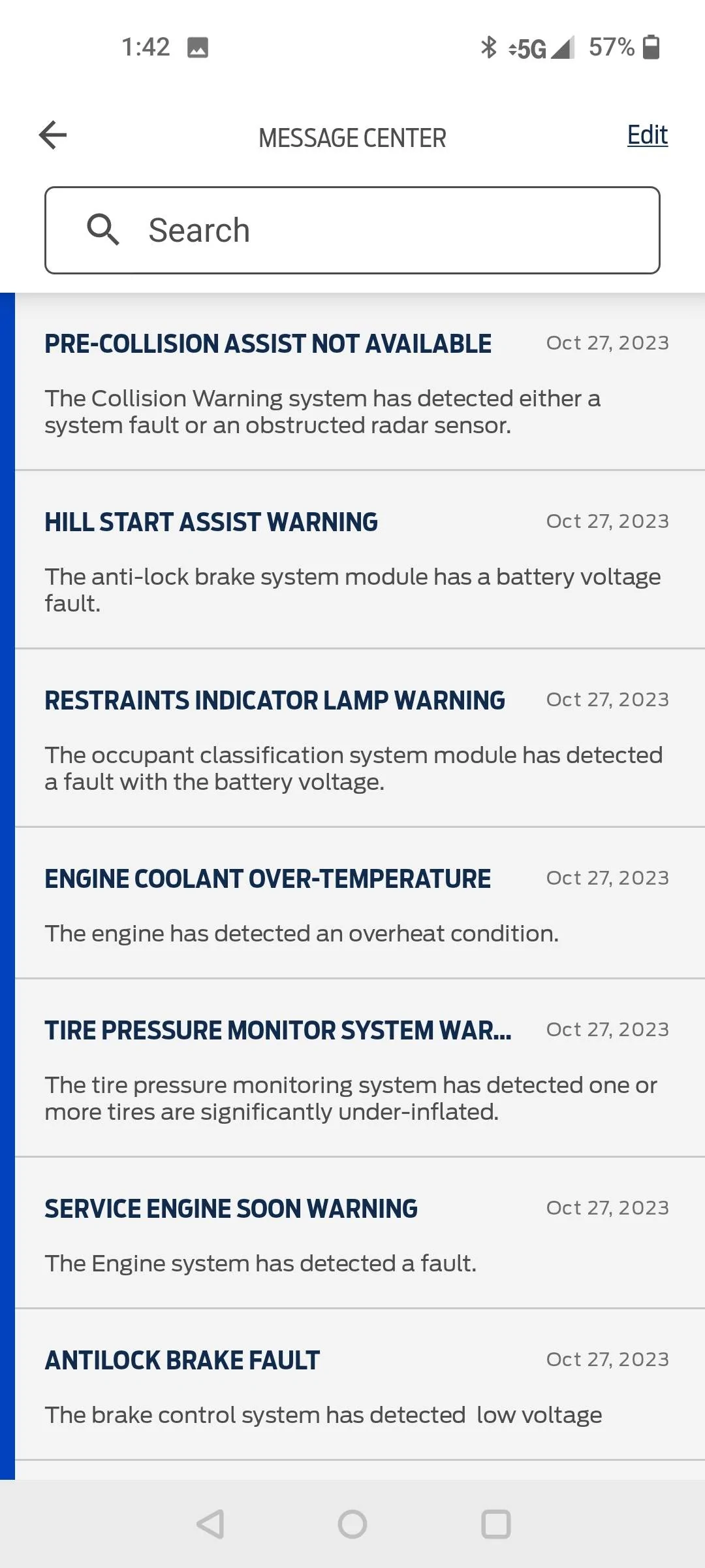

I'm hoping to limp my Bronco Sport to the dealer tomorrow for a fix to my issues (fingers crossed!) and I will keep you all posted. Meanwhile it occurred to me to check my Ford Pass app on my phone for the error messages I received after my car died. After jumping the battery with my portable charger the following were all the messages on the screen. I did make it home though without any issues.
Stay tuned! I appreciate everyone's help so far.
Ford Bronco Sport Trusty (til now) 2021 OB died in traffic today Screenshot_20231101-134240
Ford Bronco Sport Trusty (til now) 2021 OB died in traffic today Screenshot_20231101-134231__01
That thing blew a gasket! Seriously, many have reported events involving a rash of unrelated error messages (screen lit up like a Christmas tree!). As far as I know, none of them were actually experiencing all the reported issues; all resolved their problem with a new battery.
