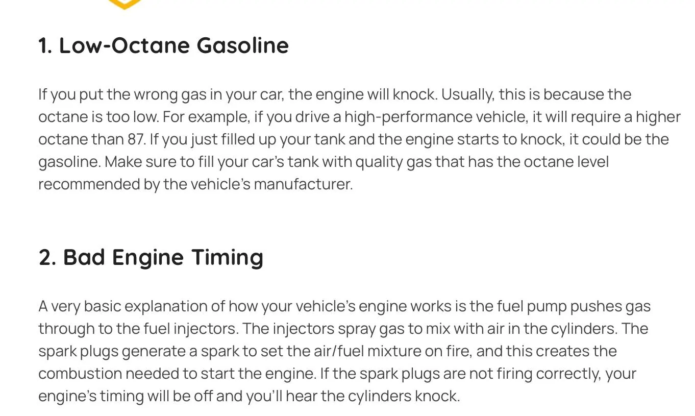

Ok, I’ll say uncle. My point was low octane gas in a higher compression engine can cause it to knock. Two ways to fix it. Use higher octane gas or in the old days, adjust the timing.
I was thinking I’d buzz the tower anyways just to see if you spilled your coffee! :cool:
