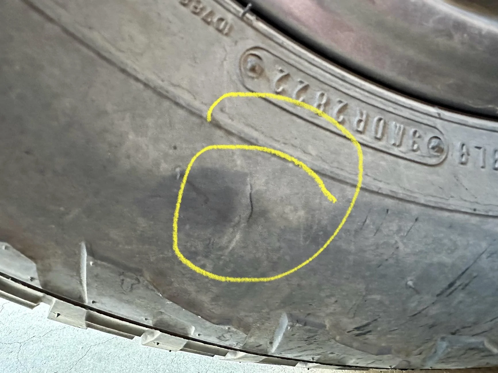

Tire Sidewall Crack - what would you do?

Hard to tell but are those other cuts in the sidewall just to the right of the yellow circle?
They look like scratches that don’t go all they way through like the crack I circled.

Do you think the crack was from some type of impact damage or like BLUEOVALRACER said maybe older than the other tires? If due age of tire maybe covered by tire manufacturer warranty?
Also, I’ve noticed dealerships over inflate tires to 40+ psi. I’d imagine that compromised integrity.

My guess is exposure to elements plus off roading.
As for tire warranty how do I find that out. These are the tires that came with vehicle during purchase in 2023. Dealership wasn’t helpful in finding out about manufacture warranty

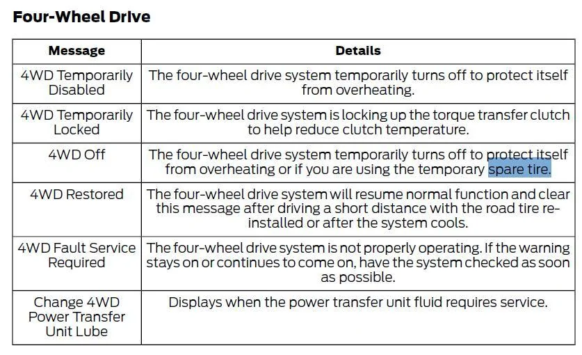

From the (2022) manual, page 321:
"It is recommended that the two front tires or two rear tires generally be replaced as a pair."
From page 111:
Ford Bronco Sport Tire Sidewall Crack - what would you do? 1722642773992-c0
From page 309:
Ford Bronco Sport Tire Sidewall Crack - what would you do? 1722643198228-o
So the manual has conflicting advice. The main concern seems to be about using the spare.
We have a full-size spare, so I don't know the diameter of the 'donut' spare, but I believe it's significantly smaller than the regular tires. Also, it's only 1 of 2 tires on an axle (not both).
Obviously, what's best is to replace all four tires. However, if 4 tires aren't in the budget, Ford does say that replaciing the two front tires or two rear tires is OK.
