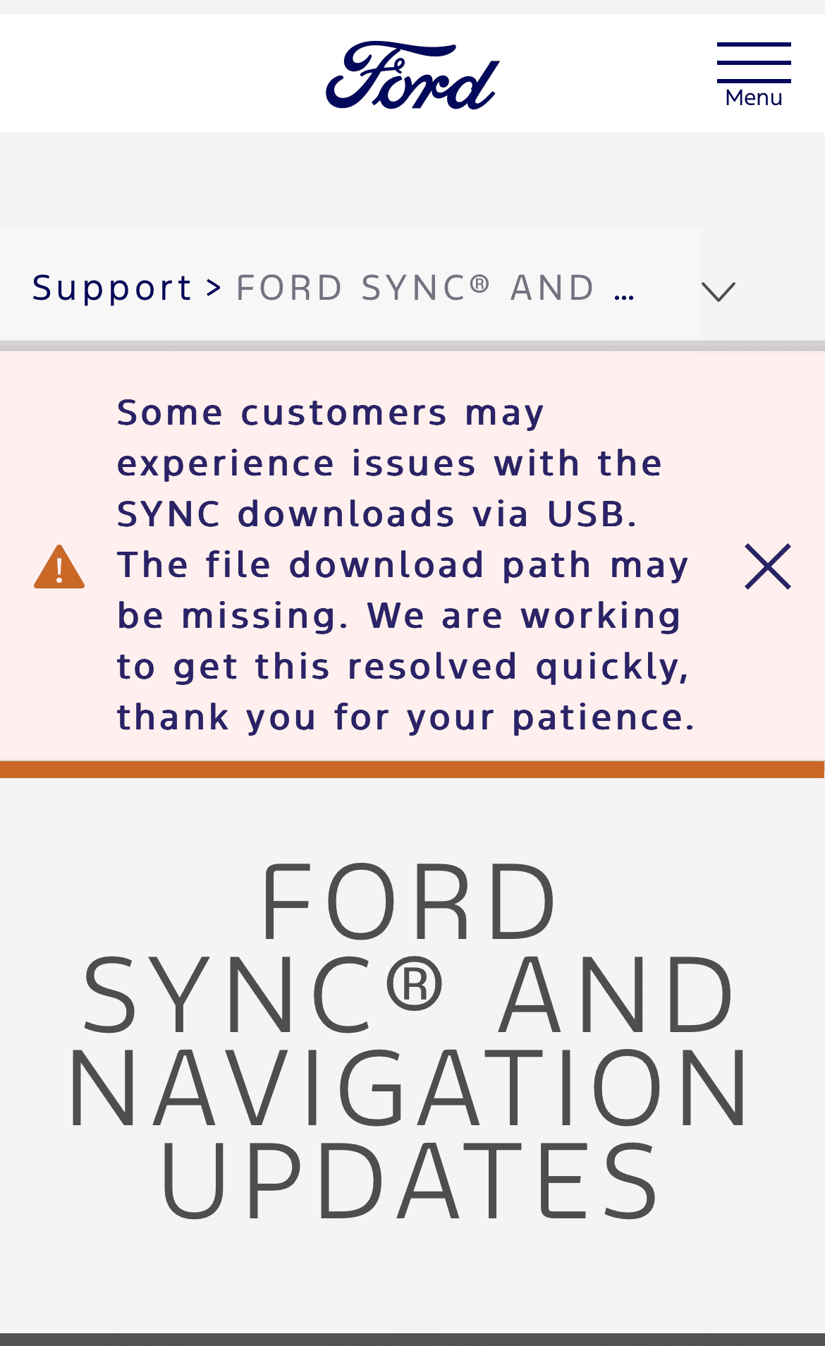

How do you update?
cprcubed
Patrick
Nov 16, 2022
629
1,045
Parker, TX
If you can't wait for them to fix their issues, PM me your email address and I can send you a link to download the zip file. Also, see the attached instructions for the install. Cheers!
