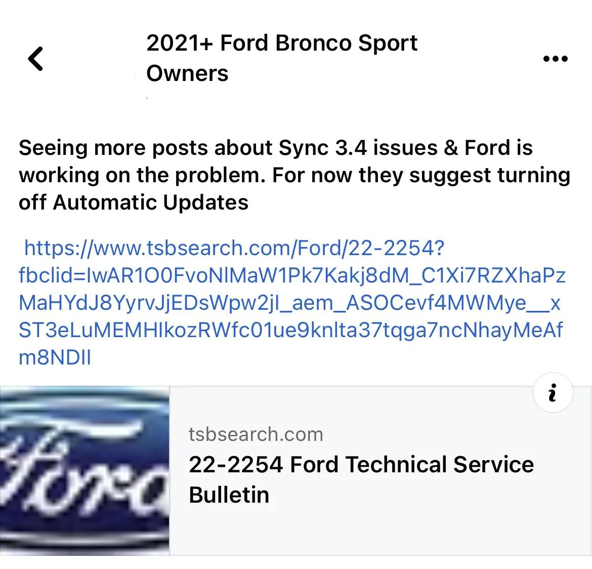

Apparently Ford now also recommends that the Sync Automatic software updates be disabled. See pic which was posted today 7/22/2023 by a Ford Dealership (it is on a Bronco Sport Facebook Group). There is no fix from Ford yet.

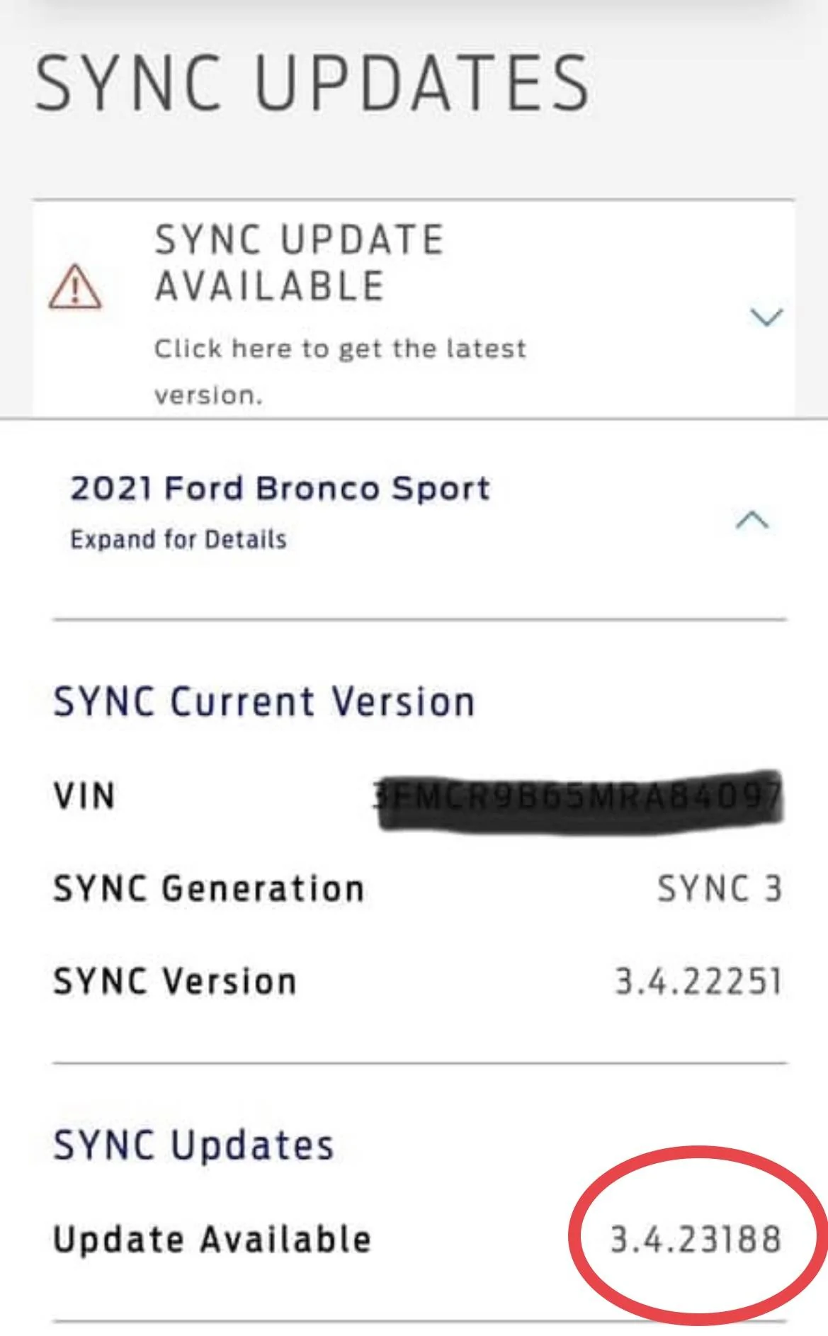

Finally the new update is available!
