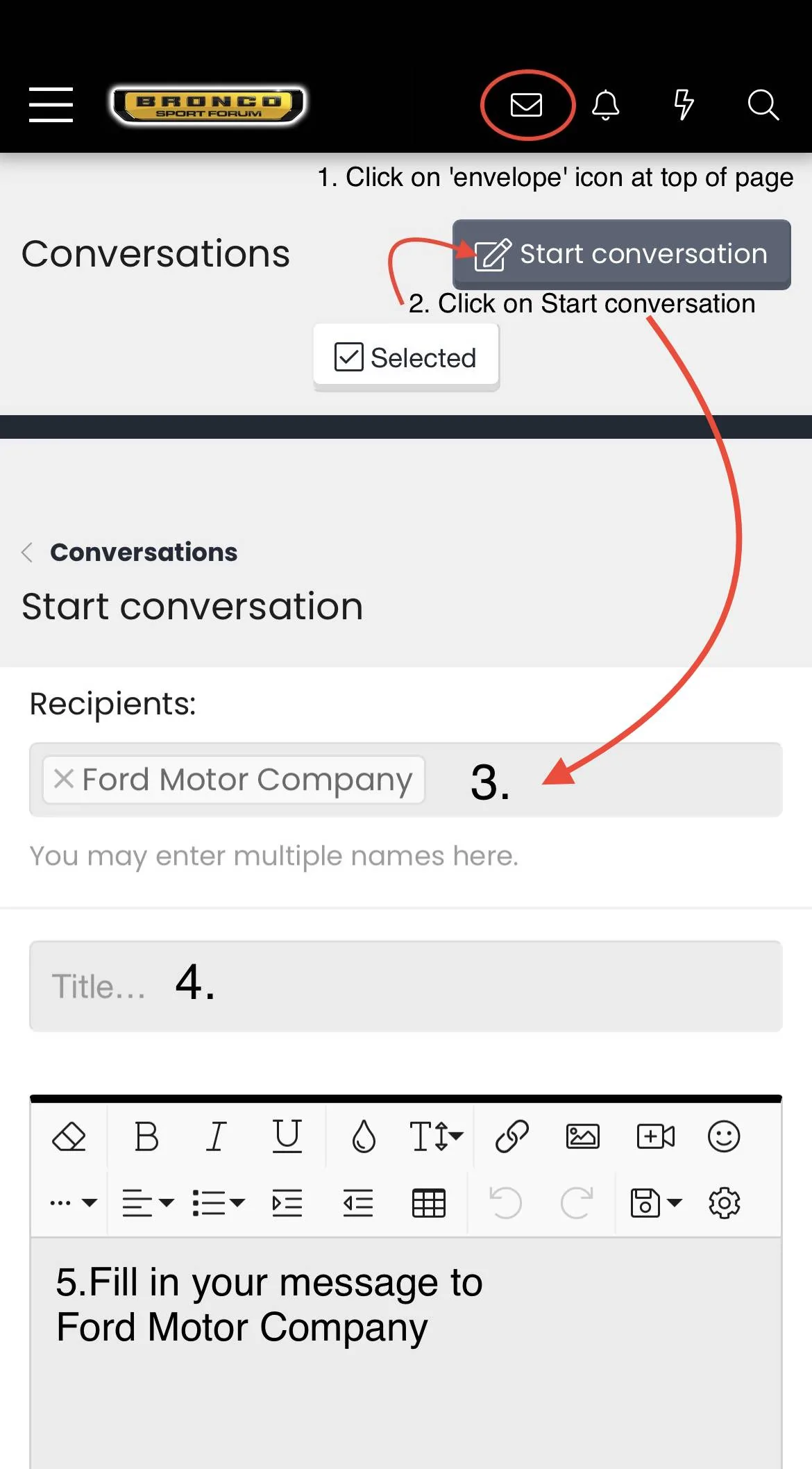

alternatively you can create a private message to @Ford Motor Company and provide your info and ask them to create the case # for you. The internet team is very good at getting the case # created but you should not expect the internet team will have ability to solve a software issue - with Sync software issues, that is Ford’s software team (sometimes knows as the SYNC3 Connected Services Team).
