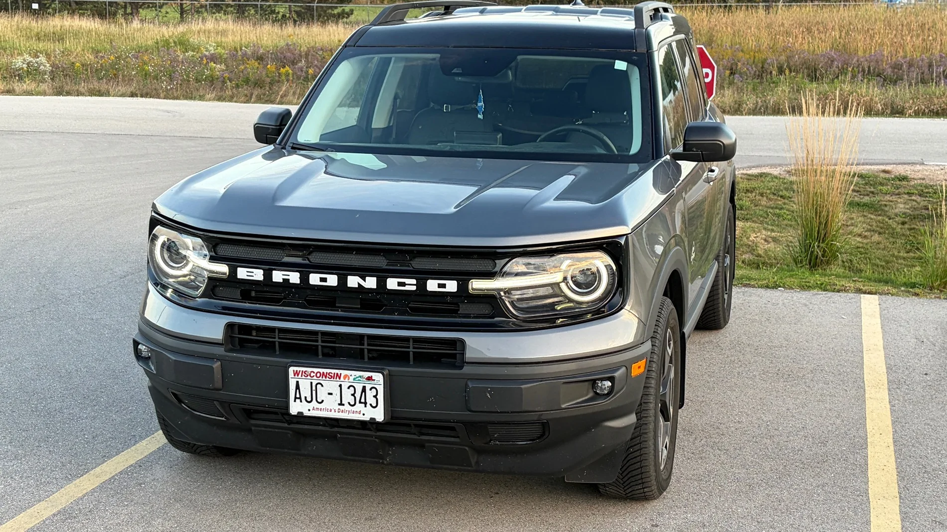

Has anyone experienced their daytime running lights not turning off after you park the car and lock it? The lights are in Auto mode and I have to turn dial Off to get them to turn off. Seems like it started with BMS programming a while back.
Curious if anyone has had this issue and found a solution. Thanks.

Do you have a 2021 model or early 2022 model? (The same issue may be on some 2021 to at least some 2023 models)
If so there are a few service bulletins to look at: one replaces a defective (from factory) headlamp module switch (the switch on the dash you interact with):
See these posts from me:
look for Post #67 from me if this link does not directly go to my post #67:
https://www.broncosportforum.com/forum/threads/part-of-headlight-staying-on.2926/post-210767
https://www.broncosportforum.com/forum/threads/daytime-running-lights-sometimes-stay-on-after-shutdown.4418/post-217247

when you shut it off and lock it they are now courtesy lights and will stay on for a minuet or two.

Thank you. 2021 OB so I’ll take a look. Appreciate you!
