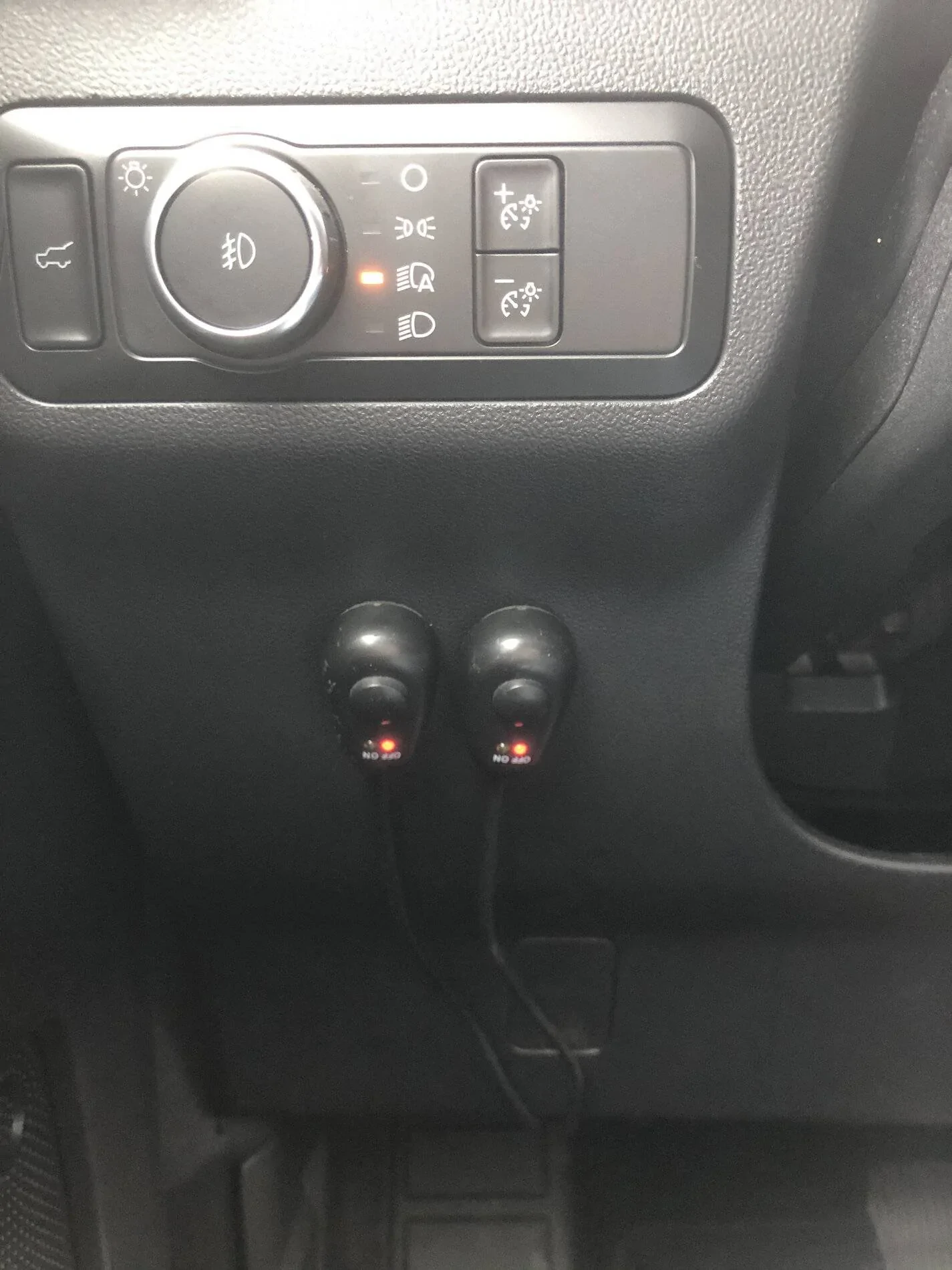

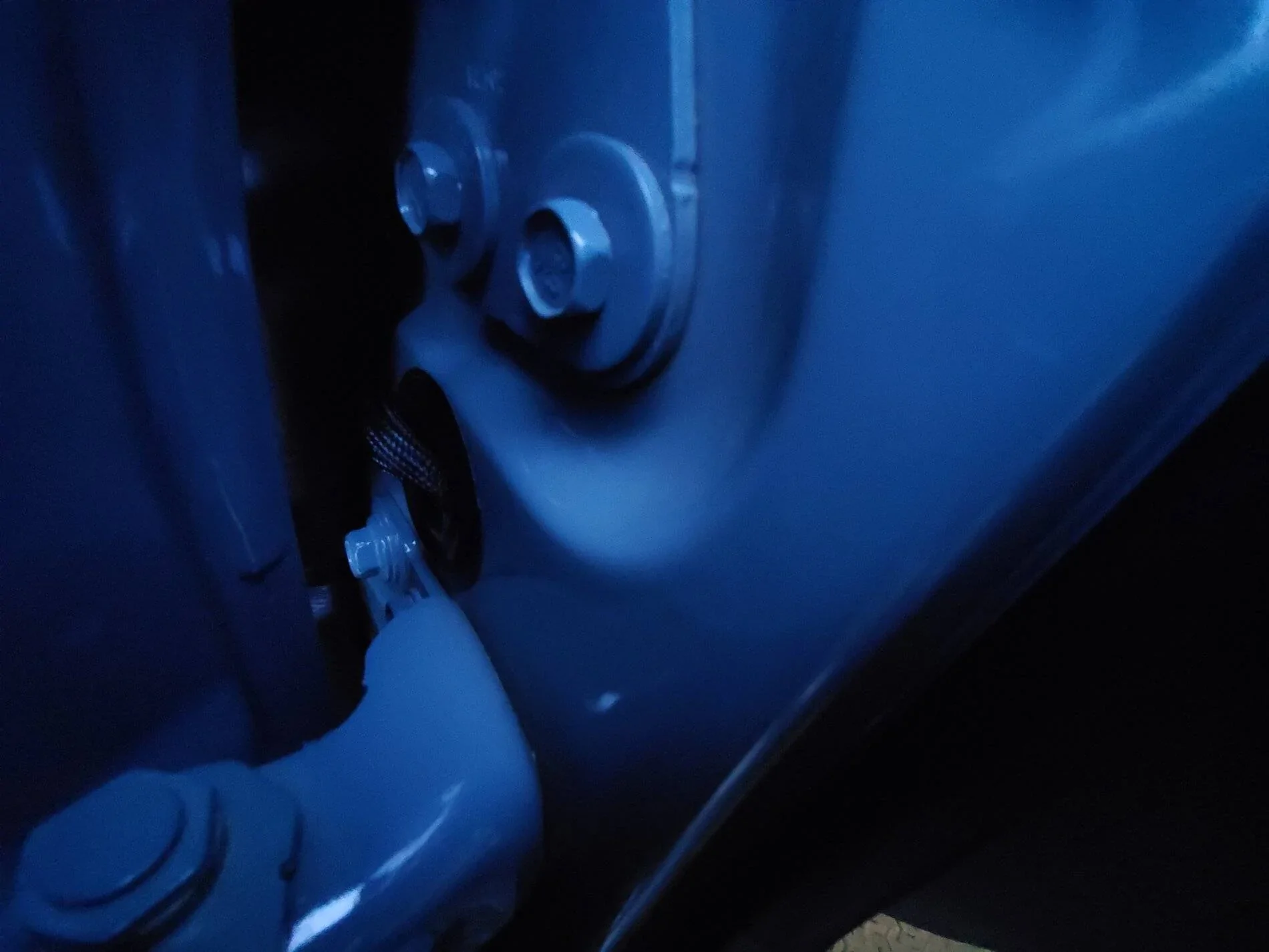

There is a plug that pulls out. Then its pretty simple to run through the steering column.
Ford Bronco Sport Rough Country nudge bar installed 20210414_195829
Ford Bronco Sport Rough Country nudge bar installed 20210414_195810
This was very helpful! Thank you! But how did you get the wiring from the plug hole to the spot where the switch is mounted? I can't see anything or reach that hole from under the dash

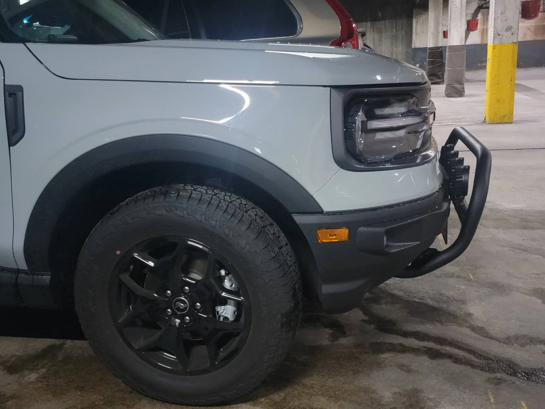

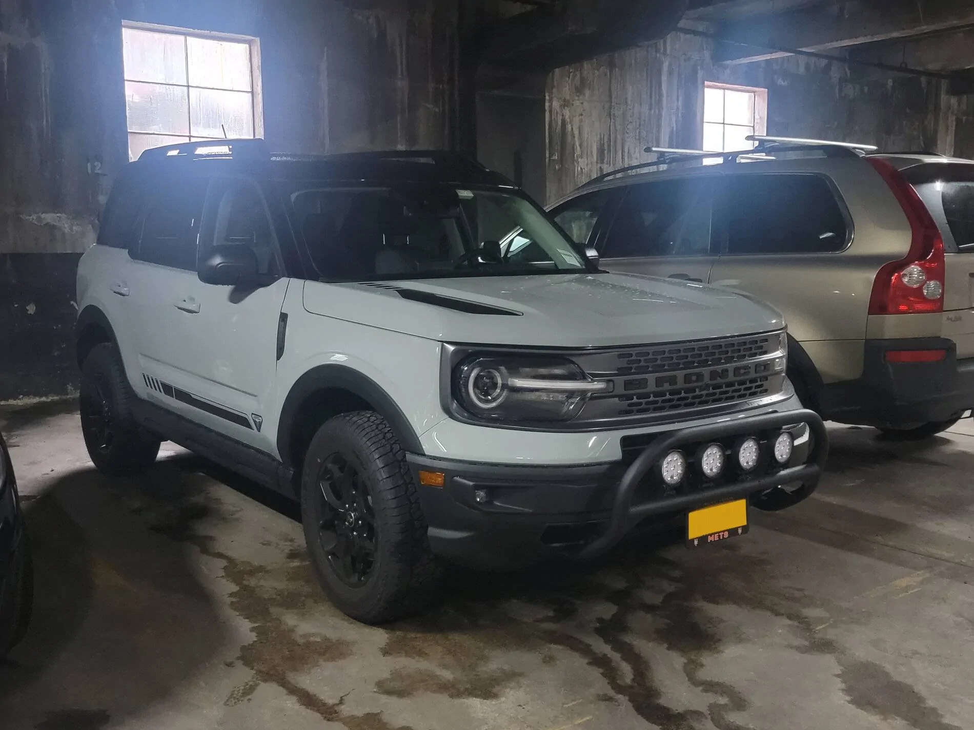

Hi Guys,
Here is my First Edition Bronco Sport with the Rough Country Nudge Bar Installed. I am not mechanically inclined so I had a shop close by to me that was an Authorized Rough Country Dealer install it. FYI, the instructions are a little off for the first edition. The mechanic had to weld a piece to my frame once he took the bumper off in order to keep it sturdy. Also, my Front Toe Hooks had to be removed unfortunately.

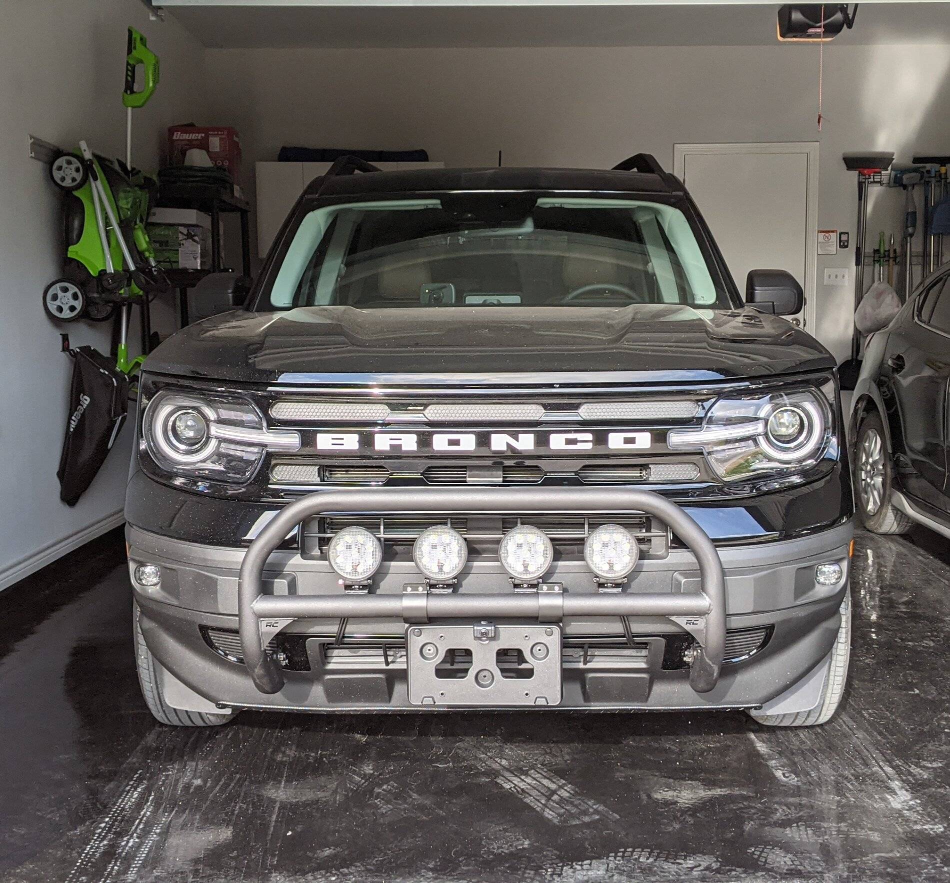

Just added mine with a mount for a front license plate and front camera in an outer banks
Ford Bronco Sport Rough Country nudge bar installed PXL_20210817_135729546~2
I am going to be installing the Nudge bar on my wife's BS & was wondering if you have a link to the license plate bracket you used to relocate the plate to the bar.

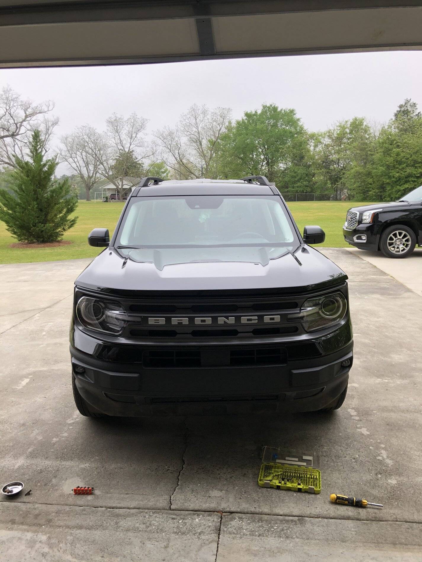

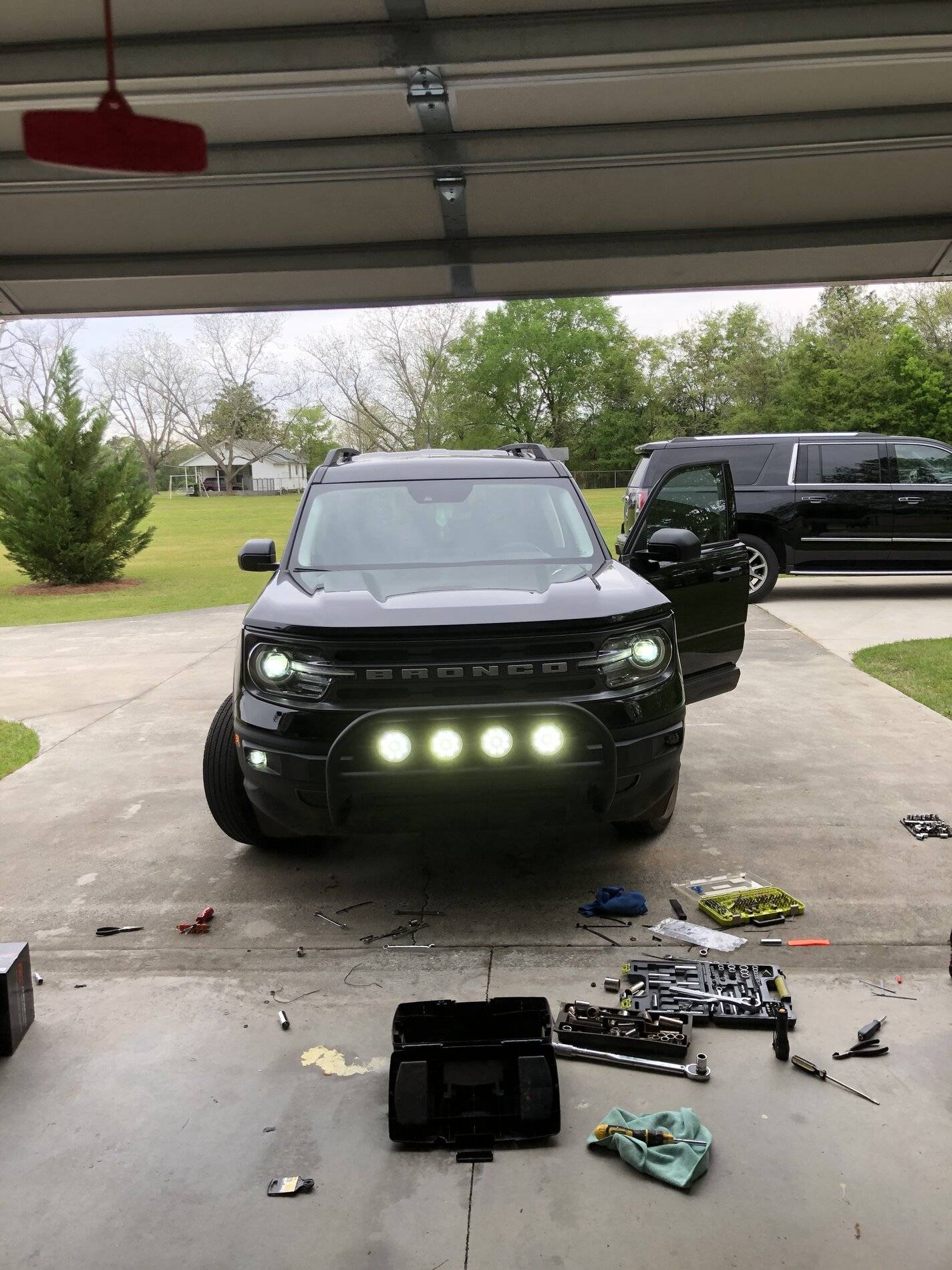

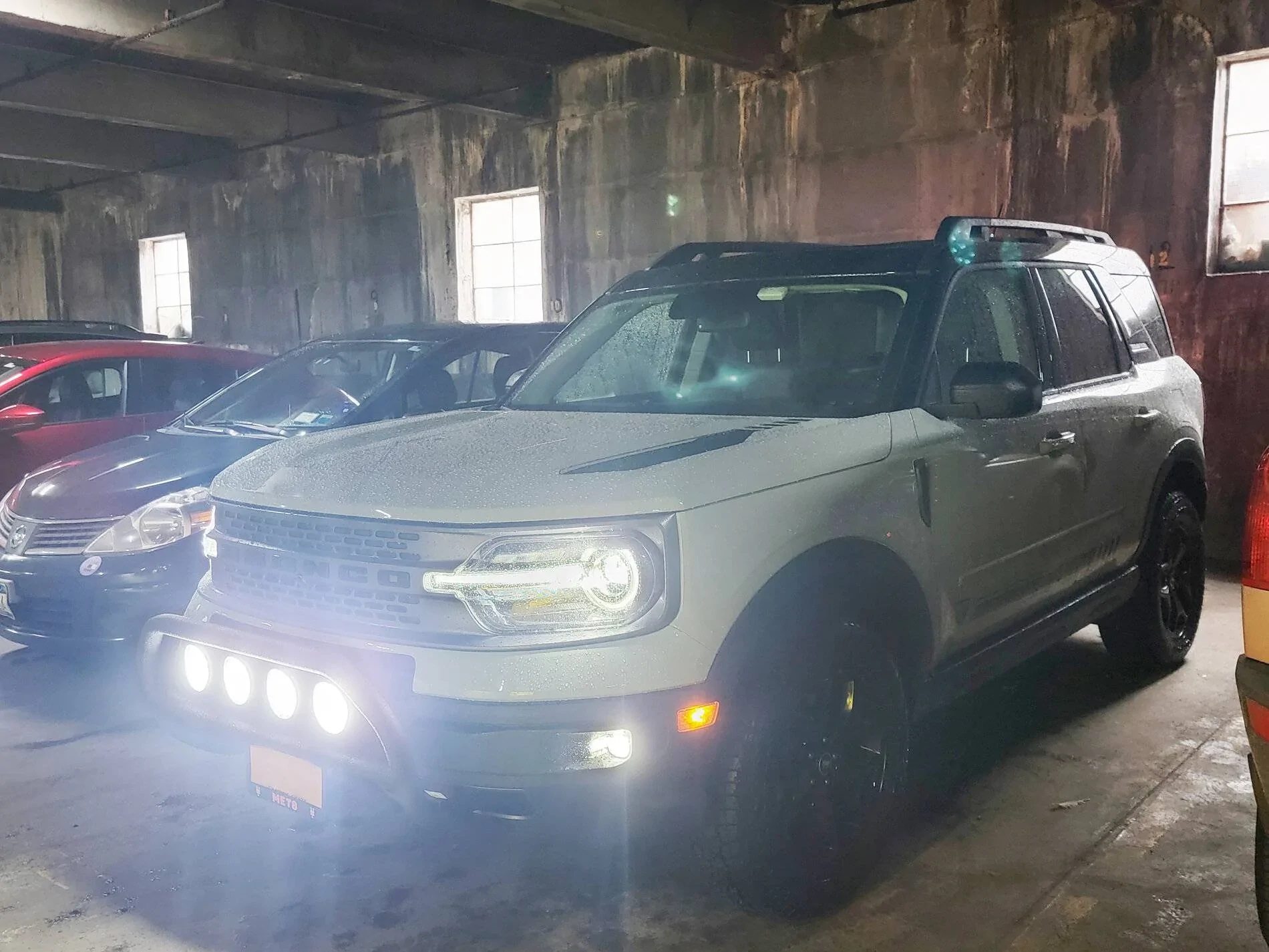

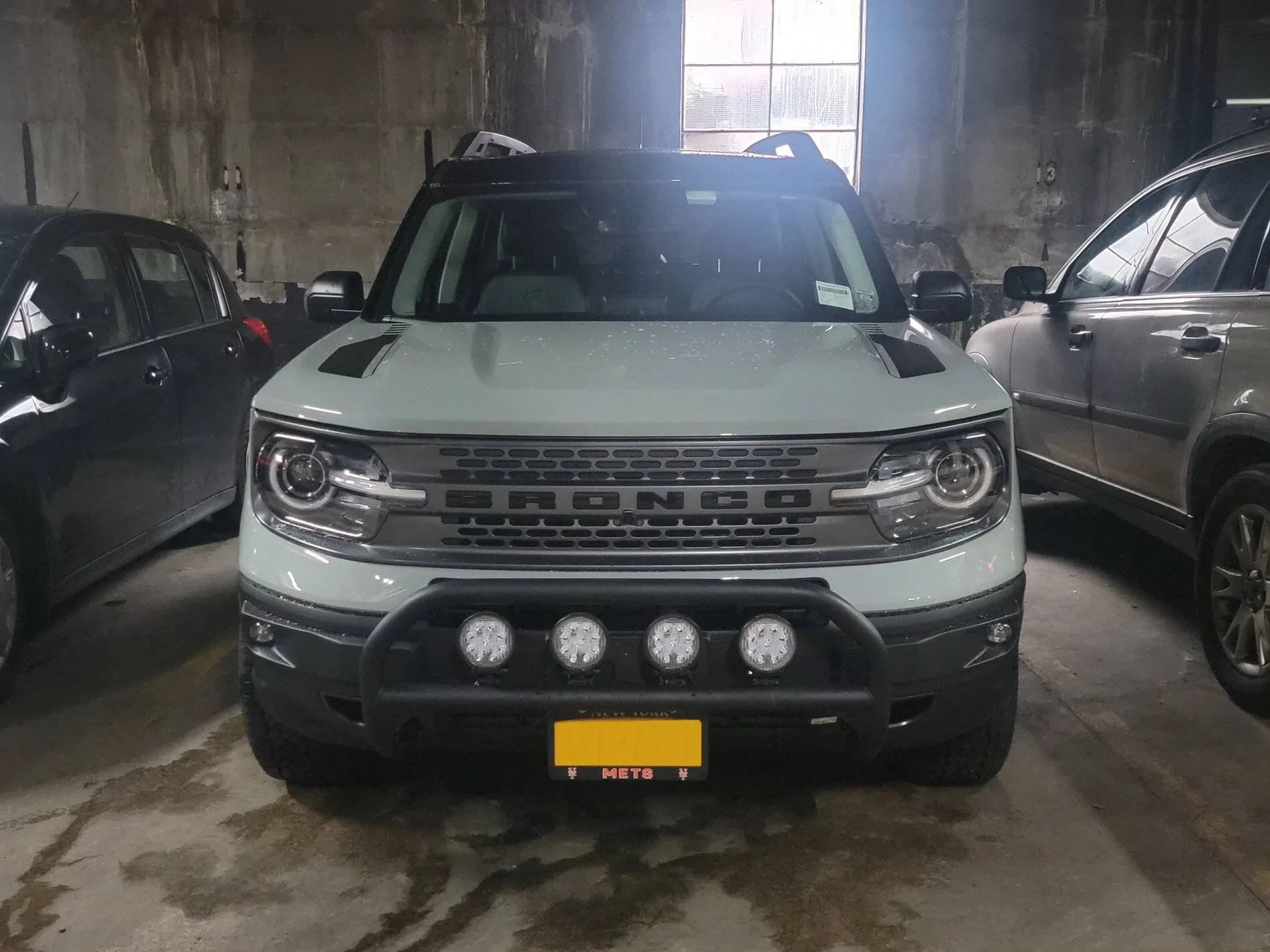

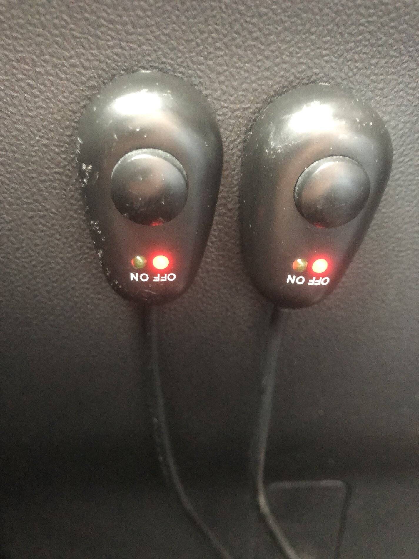

Rough Country nudge bar installed! Install took a few hours and most of it was getting the whole bumper off. It was easy to wire through the door and the switches were mounted right under the headlight control. Installing the bar was as easy as bolting the bracket onto the chassis. Like i said the majority of the time was getting everything off of the bumper and finding hidden screws that kept the front fascia on. Overall it was relatively easy just took a while to get everything off but with the proper tools it should take around three hours. I provided a before and after photo aswell and a picture of the lights on in the dirt. Feel free to drop any questions.
