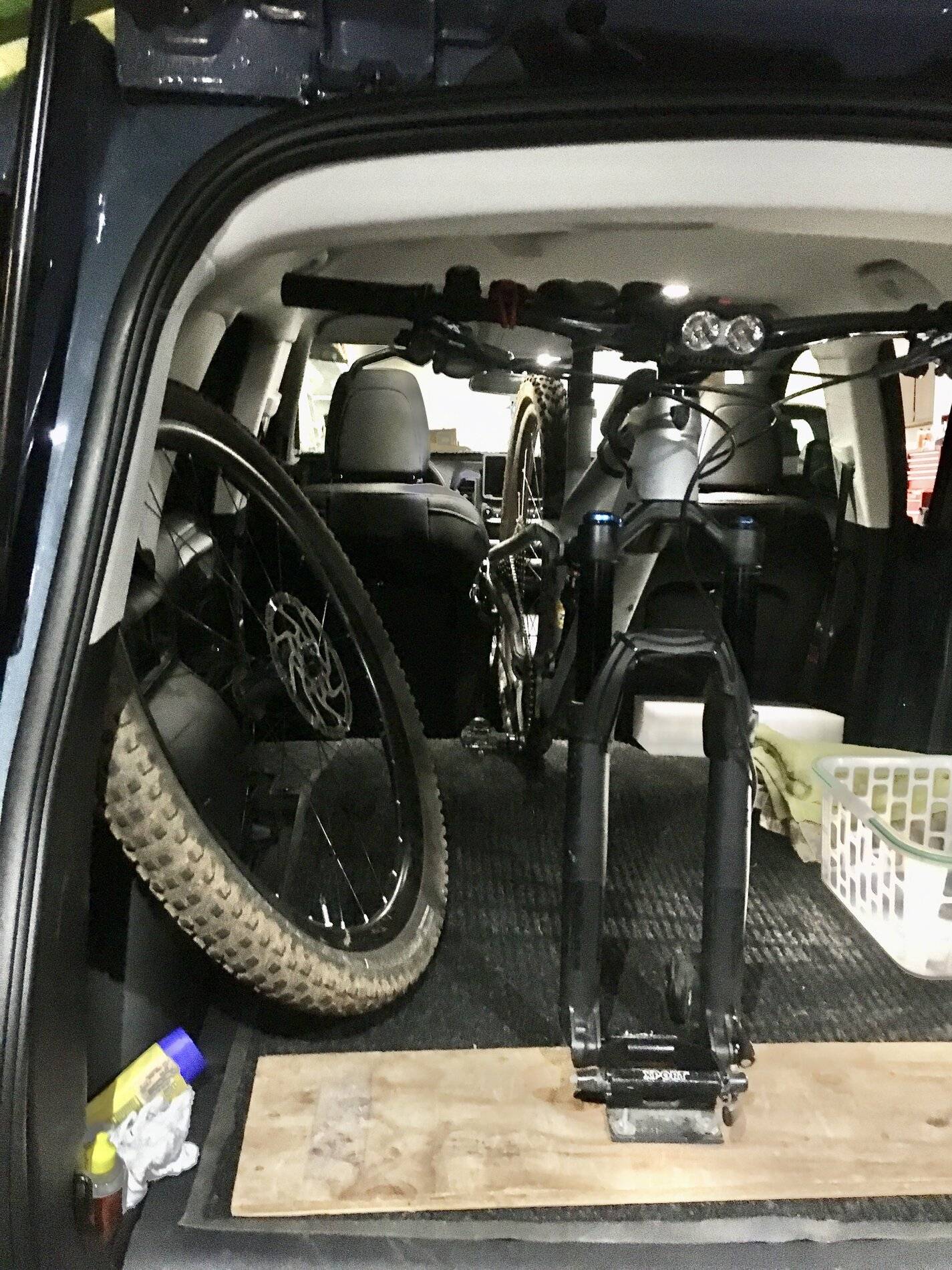

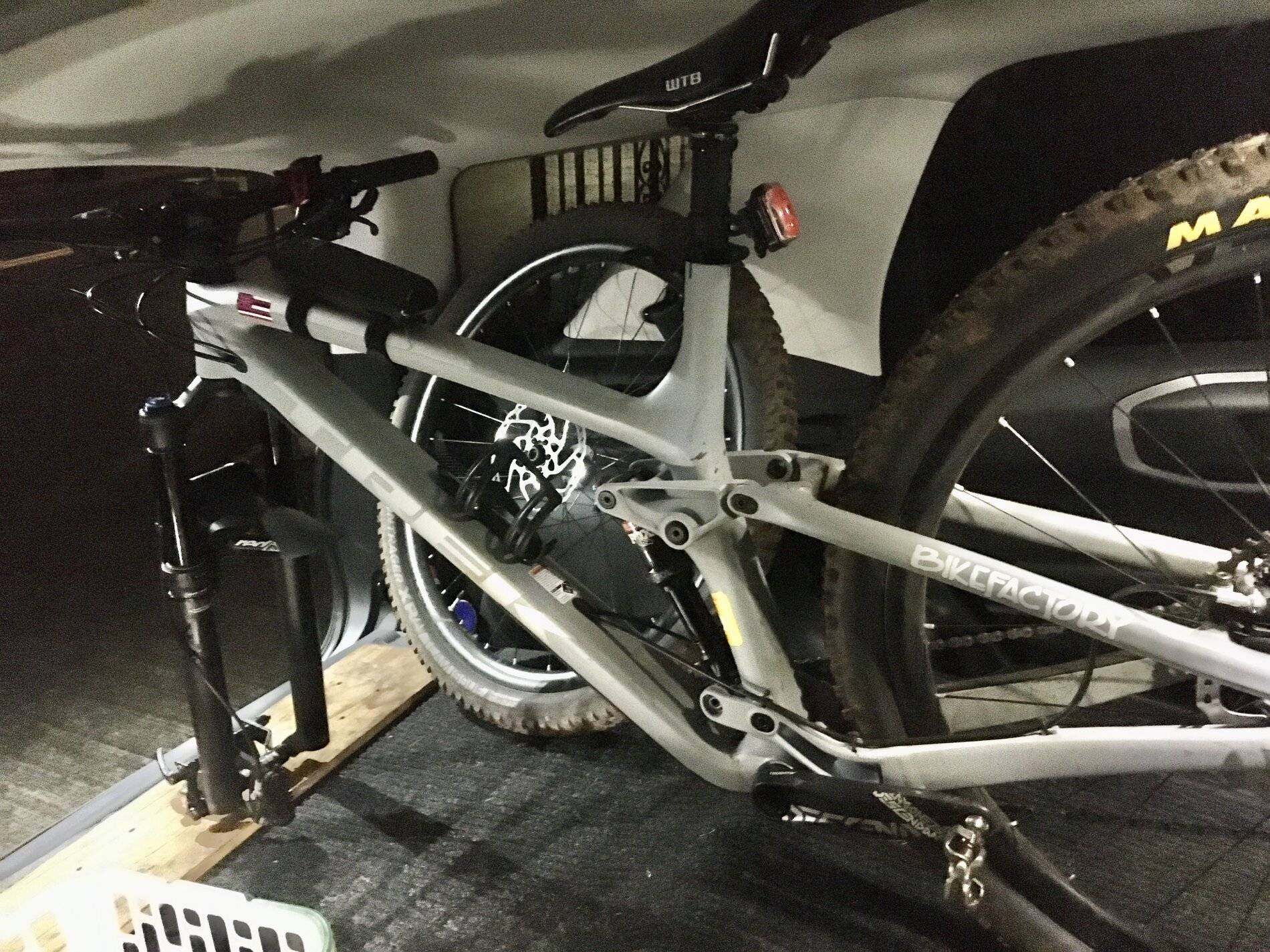

I’m going to answer my own question, because I figured it out... The bench cushion is held in by two plastic clips about a foot from the outer edges of the cushion. Simply pull up (one side at a time is okay) to detach and then lift the cushion out. It makes for a pretty easy removal and replacement if you want to carry passengers in the back again. Not as convenient as my old Escape (truck), but allows the floor at the front of the rear cargo area to set lower by over six inches, which is enough to allow for upright transport of a large mountain bike (with the seat post collapsed). I also found a nice rectangular piece of plywood to set on top of the under-seat support bars which prevents the seat-back cushions from indentations, and actually puts the floor on a flatter (non-drooping) position. Whoo hoo!

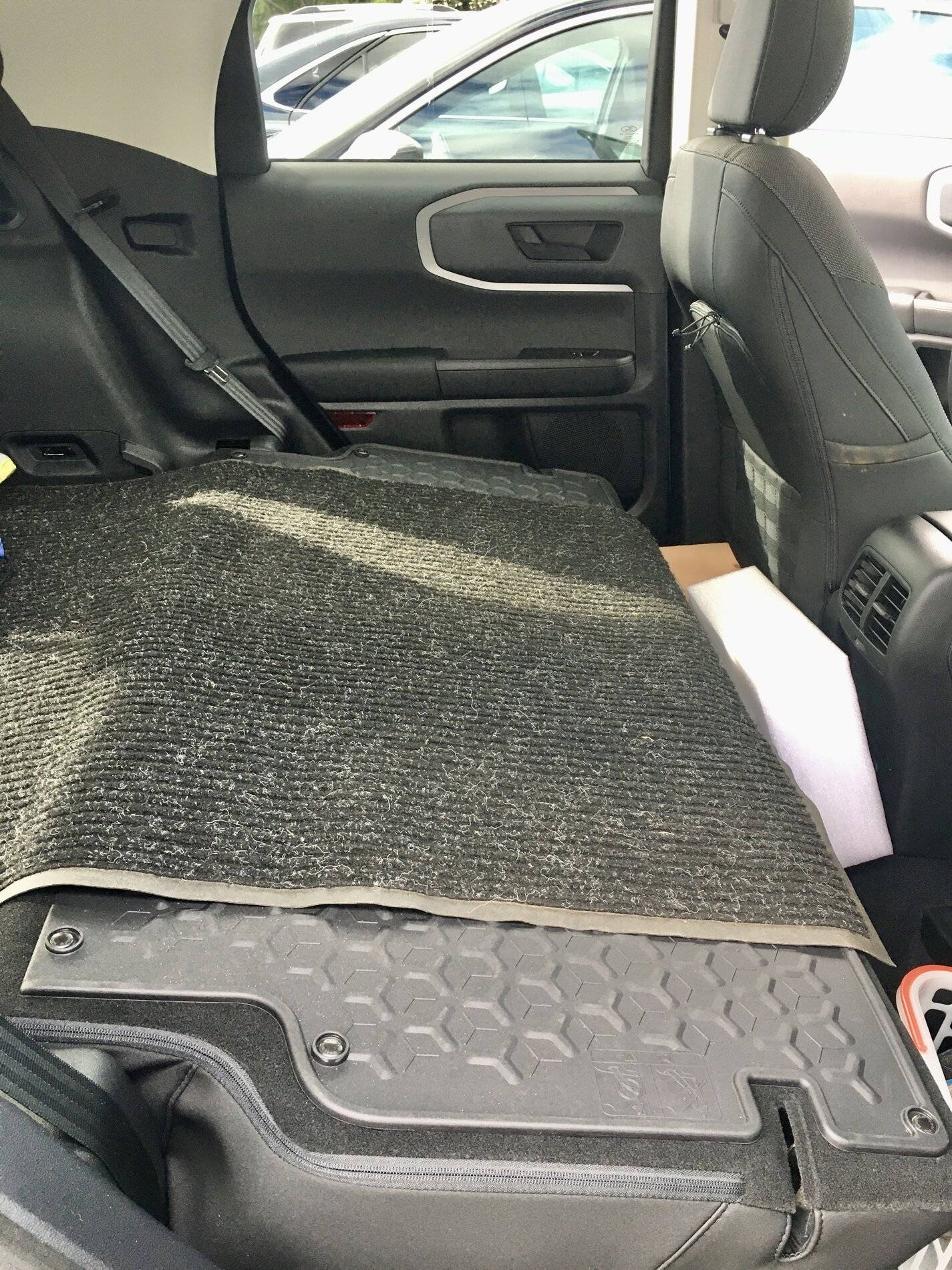

The cargo floor is now a little lower and angled downward, instead of higher and angled upward at the front. The pictures show the plastic female receptacles that metal square loop hooks on the removed bench seat snap into, and the angle of the cargo floor w/seat backs folded down on top of the plywood that I laid in. The downward angle is steeper without the plywood. And, actually, if you needed to seat someone in the back, you could flip up either seat back and toss in a pillow or chair cushion, as the seat belts remain in place and functional! (You’ll also want to flip the outer headrests forward and remove the small middle one.)
