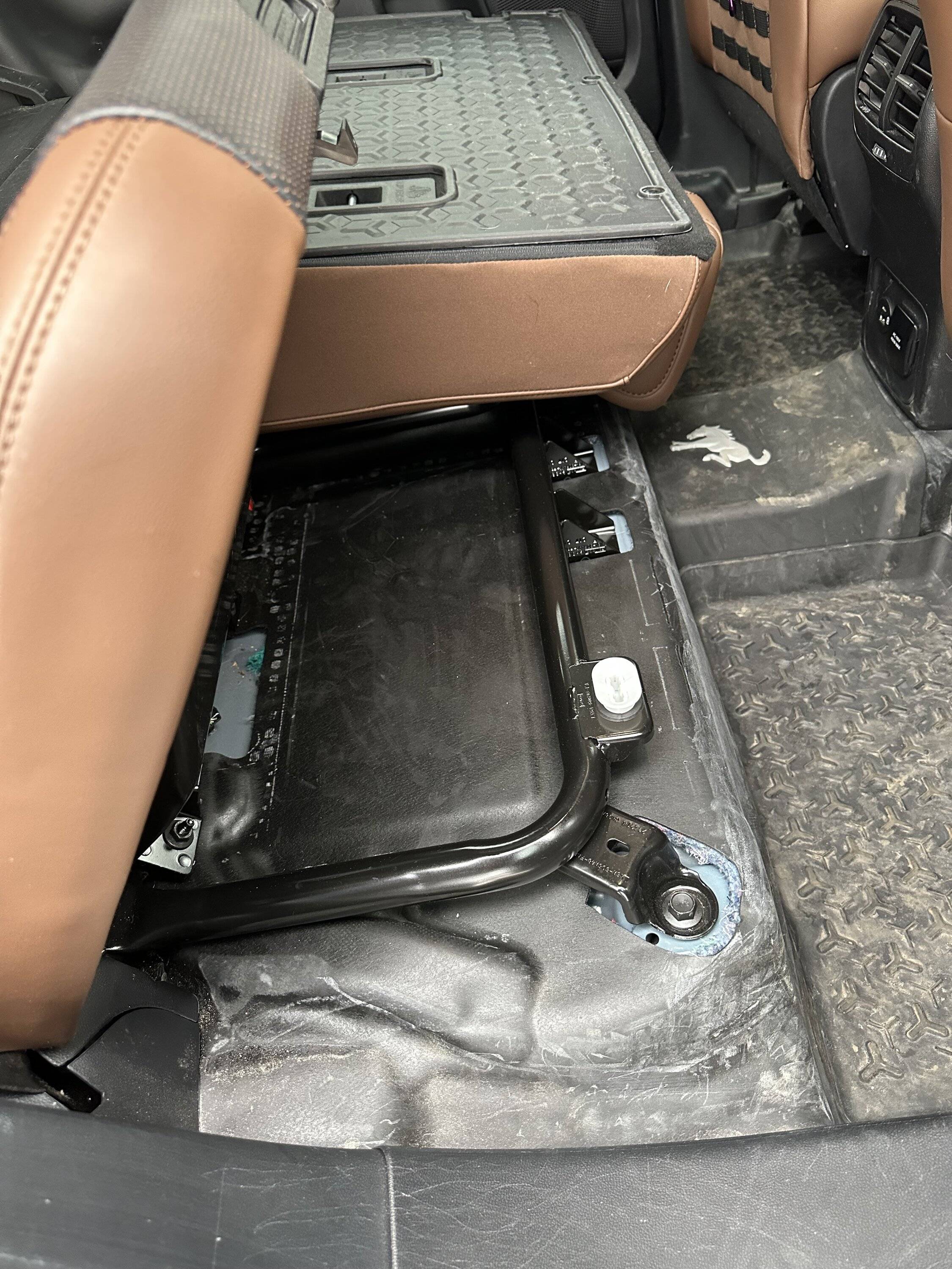

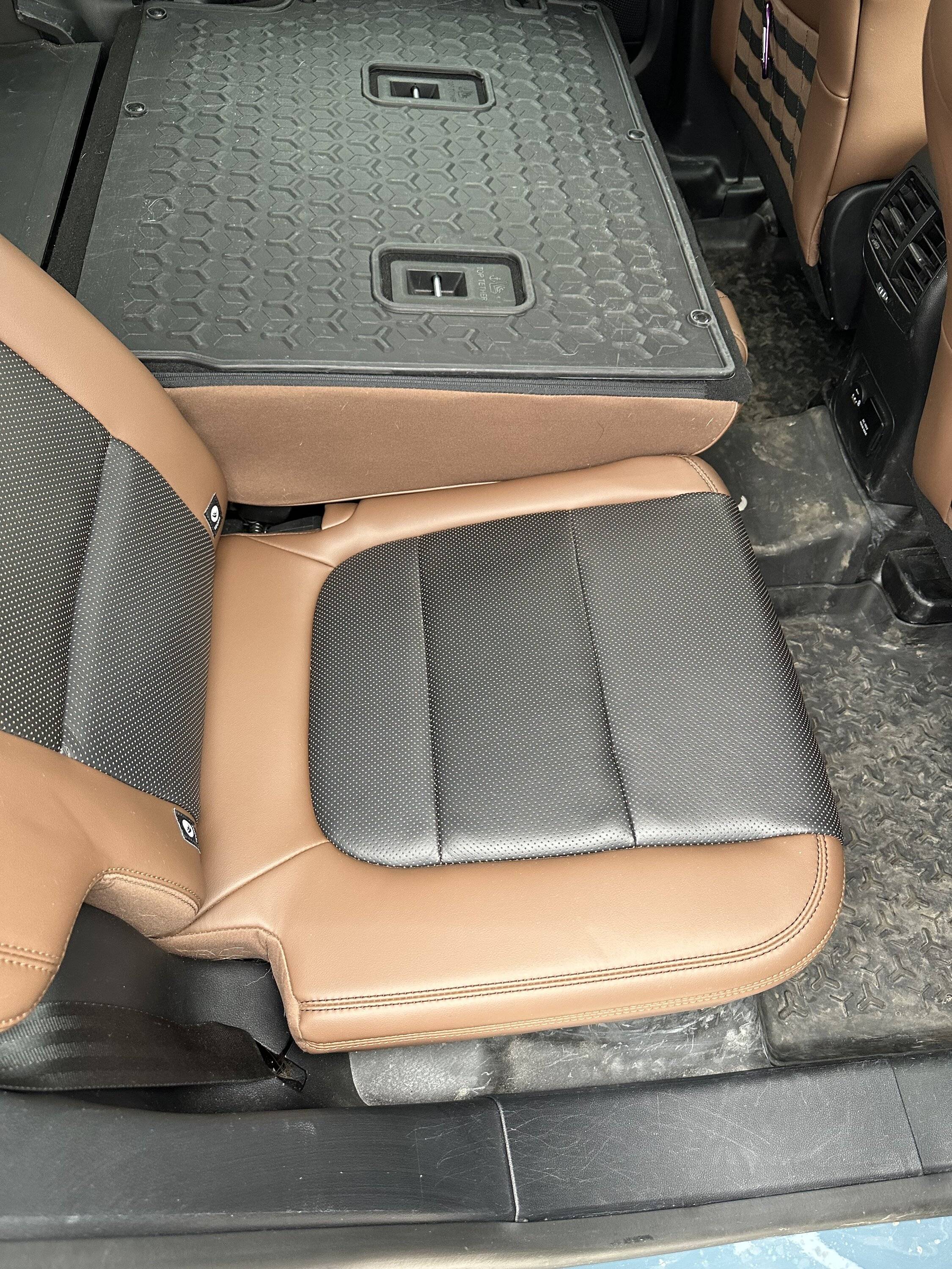

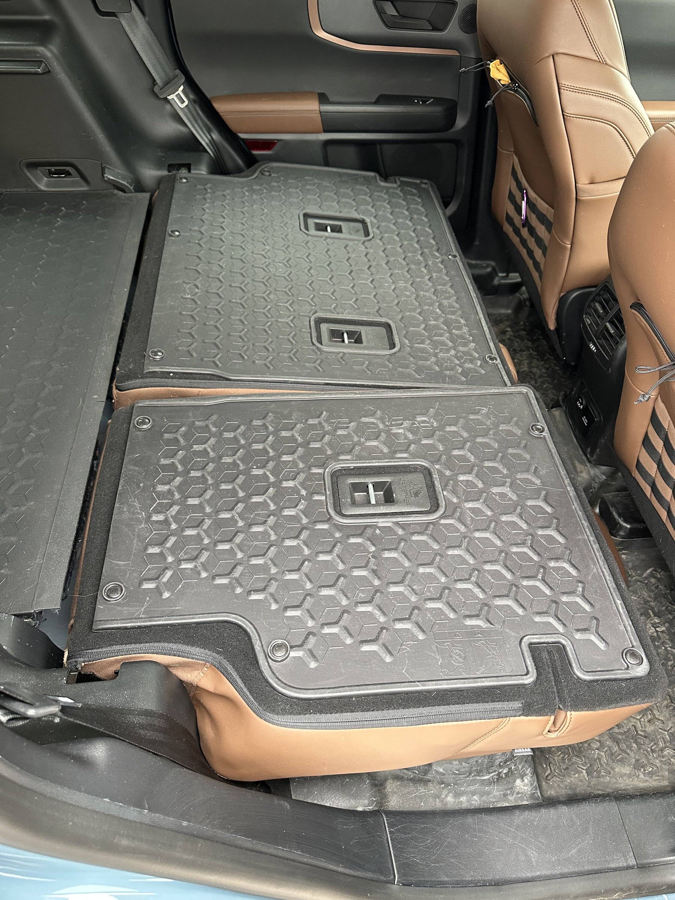

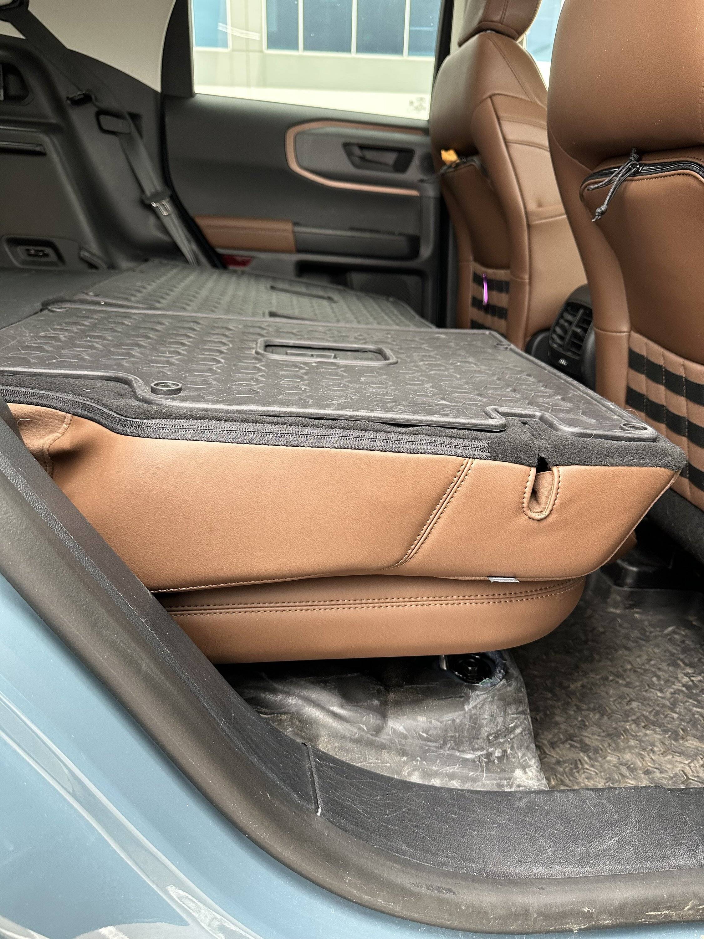

Figured I post a reply here rather than make my own post, but for those curious about removing the rear seat on the badlands/any model with the underseat storage, it works quite well! Follow the steps laid out the MountianMack. What ends up happening is that the top of the seat with the storage stays in place as opposed to the other side (where the whole cushion is removed). What’s nice about this is that the top allows the seat back to fold nearly level, as opposed to below level. Hopefully this and the pictures make sense.
