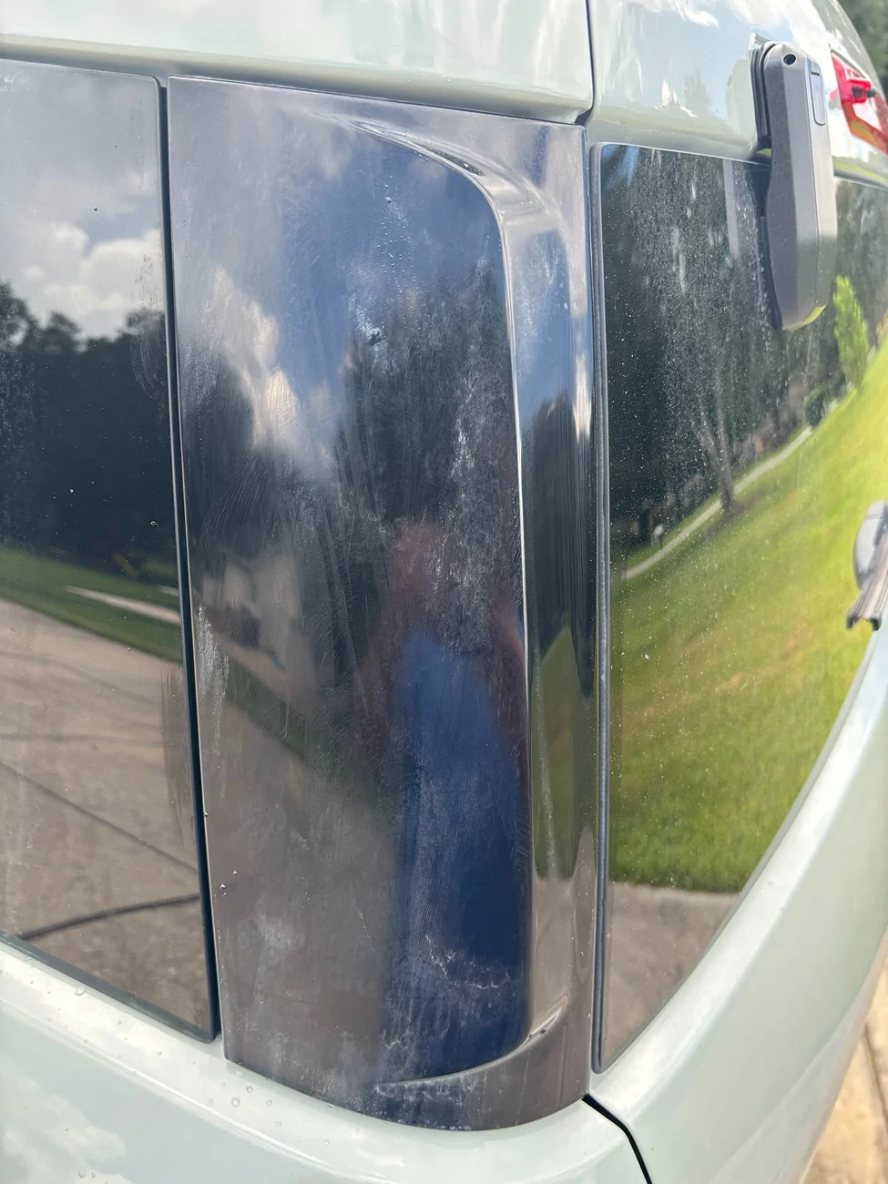

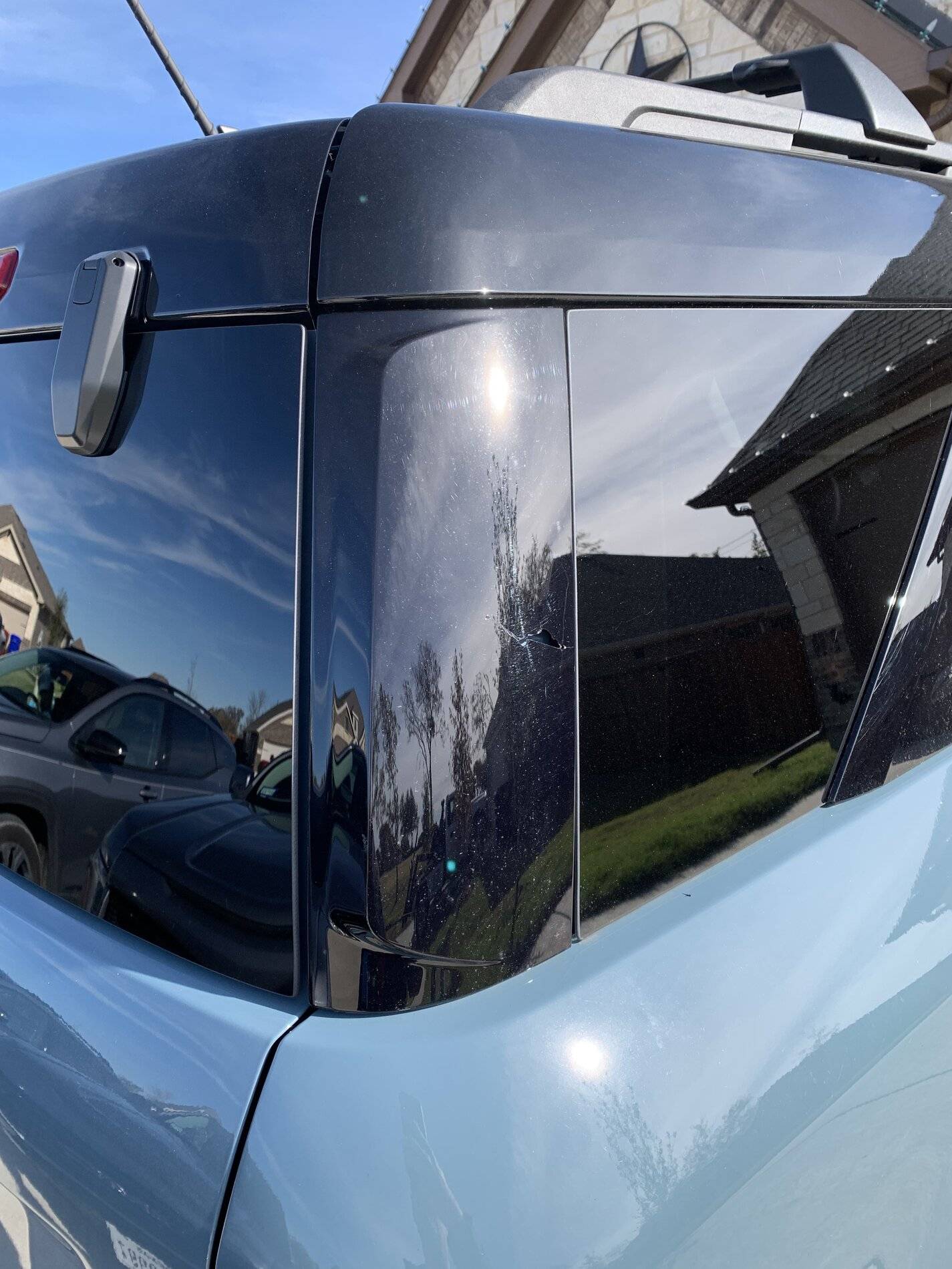

Any ideas on how to remove and replace the rear plastic mounding between the rear glass and side glass?

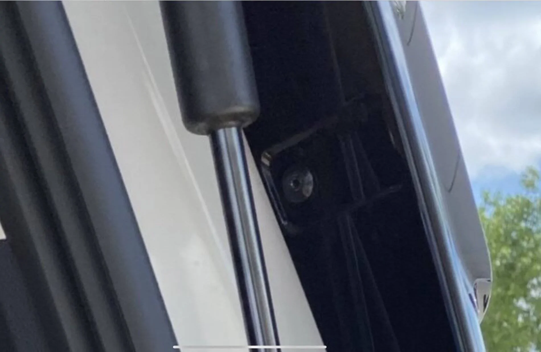

What happened? That would be the right side exterior D pillar finisher. In most cars there should be a clip or screws on the inside of the back gate that you unscrew or remove to take off the pillar trim/finisher. The below pic looks like there are screws. Removal on many cars is tricky because inside clips or attachments can crack during removal.

I believe that someone’s mower threw a rock and cracked it.
I honestly thought it would just be those 3 rivers but the other side there looks to be a place for a farther.

The replacement piece appears to have attachment locations that would be under the side window.

Hmmm, do you think you will need to remove additional interior trim?

From the replacement piece, it looks like the side window glass needs to be removed to access the other fasteners.
