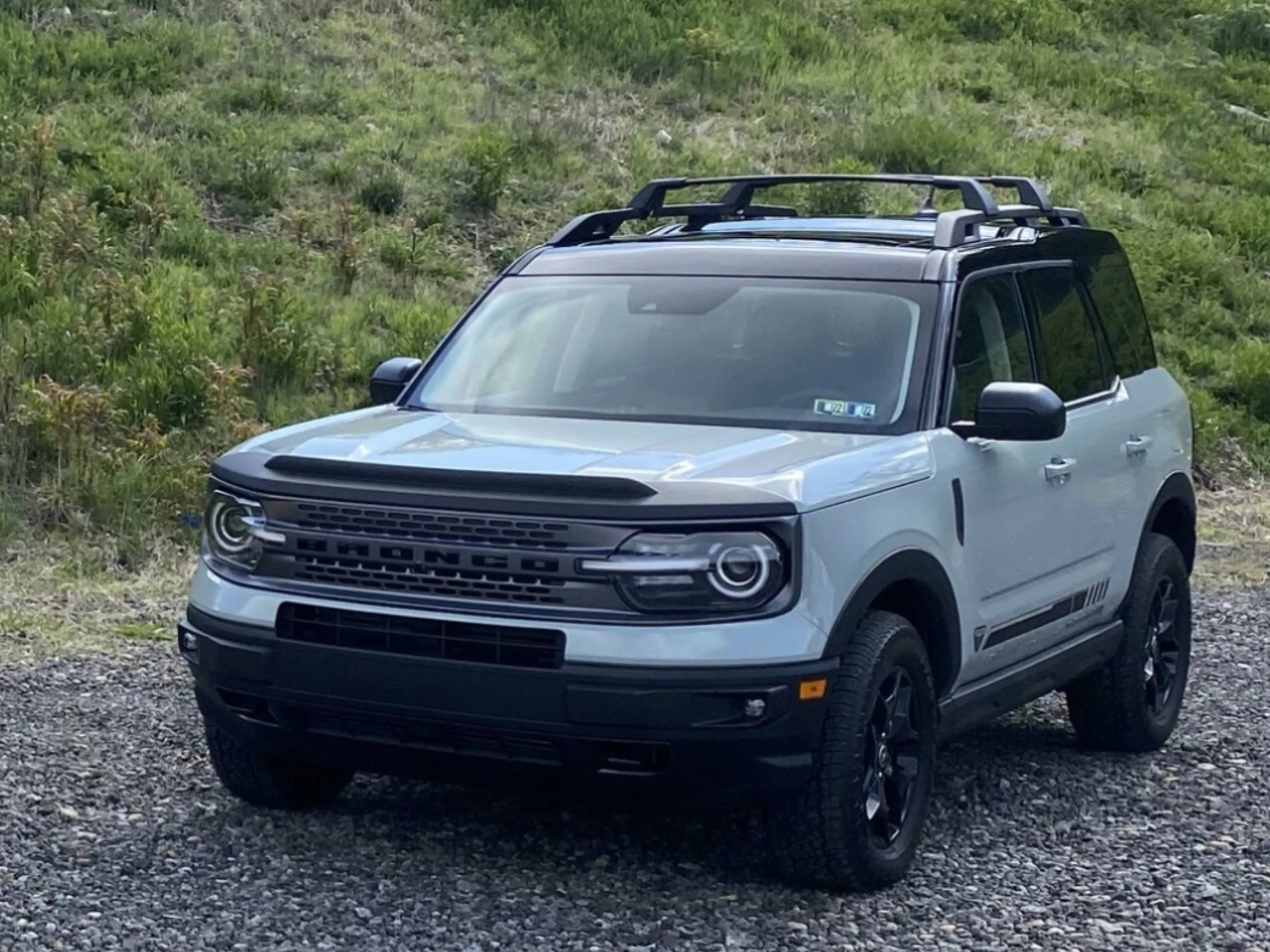

What would you all do? 3 or 4 lights?
I'm glad someone is working with a Badlands grill. Which light did you get?
I would either do 3 on the top row, center then skip 2, or 4 on the second row with 2 between each. I've been leaning toward 3.

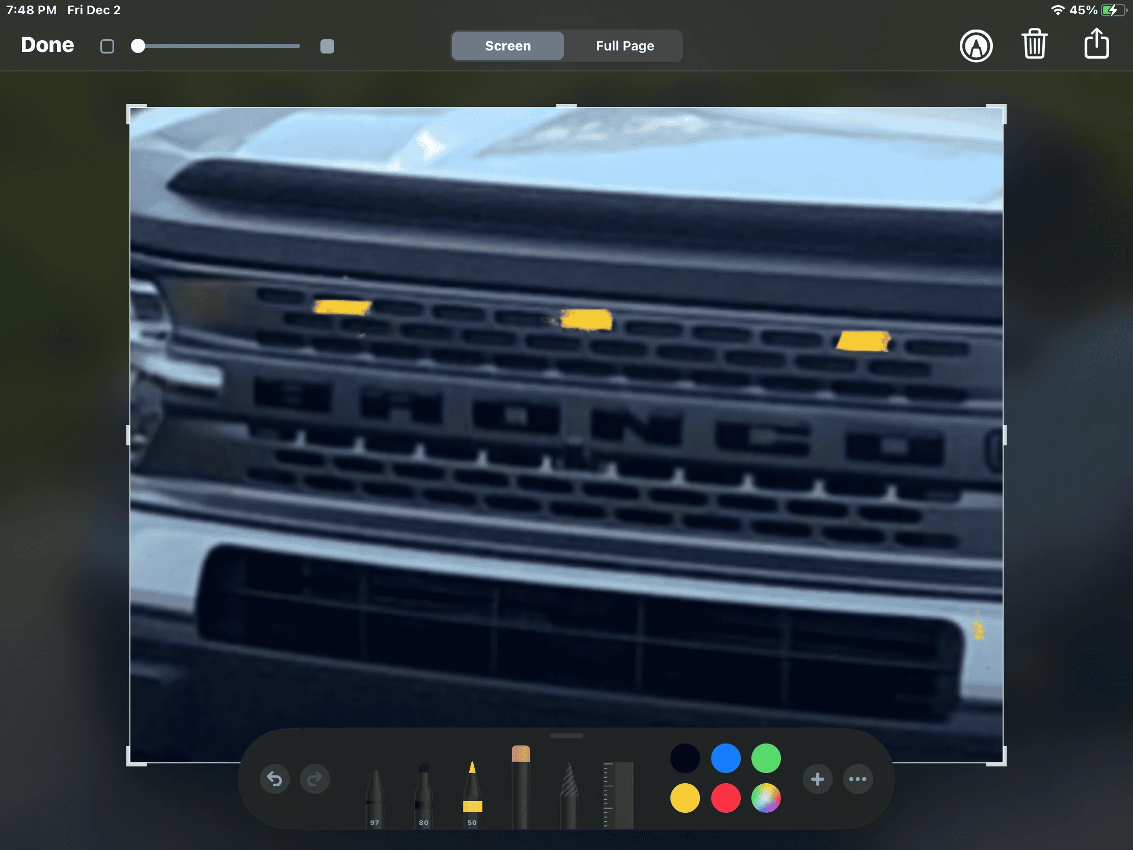

So I decided to go the custom route and buy some individual units that will fit almost perfectly into the openings on the Badlands grill. Now the question is do I install 3 or 4? If I do 3 I would put one dead center and then skip 2 or 3 spaces on either side and then put the others. If I do 4 I would start 1 away from center in each direction and then skip 2 or 3 spaces for the others.

I think four marker lights on the grille look more aesthetic. They also have out reg white light marker lights that aren't orange.
Where I would put them, if I had the skills.

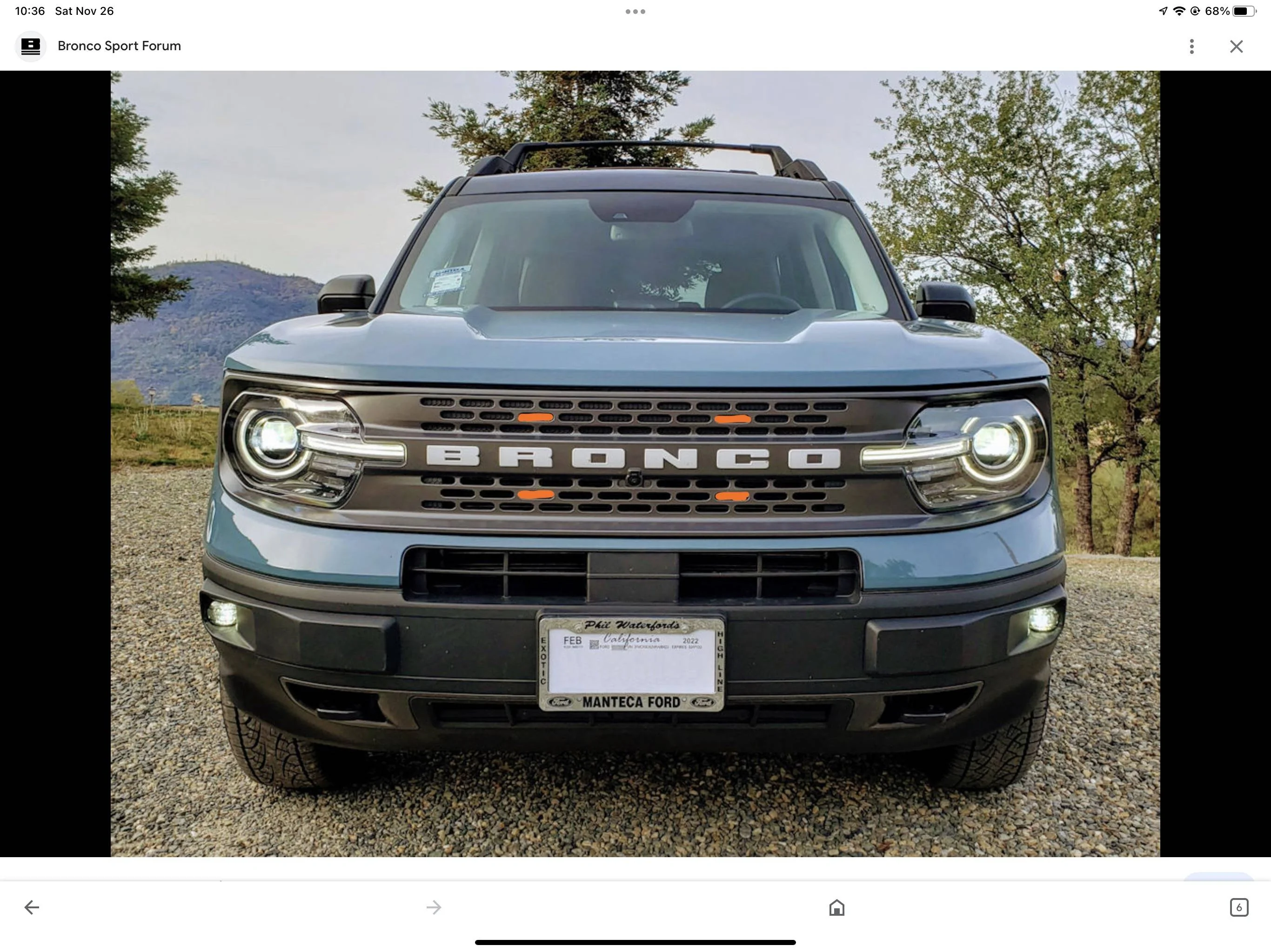

Ford Bronco Sport Raptor grill accent lights FA145C2A-5693-4947-9738-D698D181E9DF

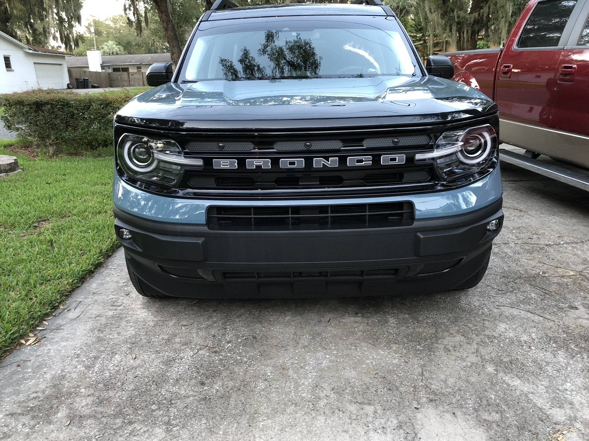

I vote for 3. I feel mine are to far apart. They look ok when off and spaced evenly. If I had a do over, I would bring the outside ones in closer.
Do what makes you happy.

That looks perfect , and would be my choice if I could figure out how to wire them . Does anyone have a wiring diagram ? What about this look ?…

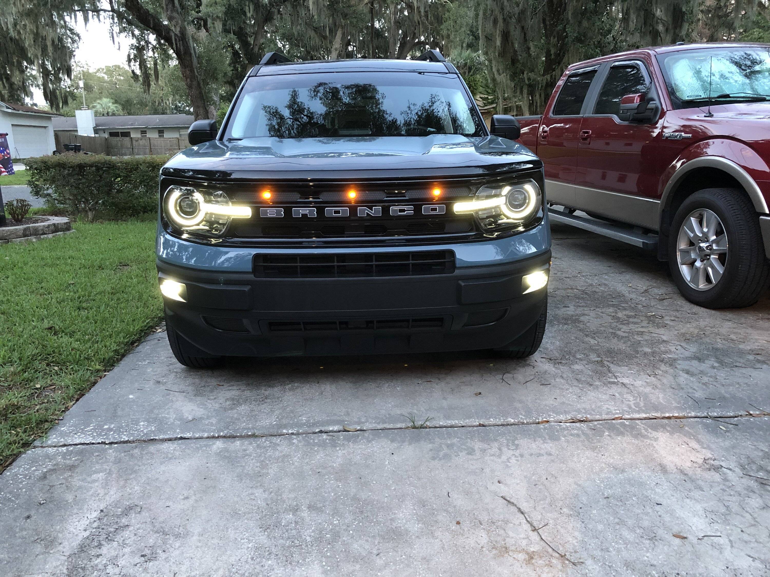

Got lights from Amazon. Smoked lens so don’t stand out in daytime. Drilled 3/4” hole. Grommet that comes with light holds it firmly.
I had to lengthen each lights pigtail (solder & heatshrink) connected the grounds to a short wire with a 1/4” eye crimped/soldered. There was a nut/bolt on the pax side of a radiator brace that had room for the ground wire eye & additional nut, so attached ground there. Only about 6-8” from right light.
Fished a piece if wire down front side of pax side fender well, attached with several zip ties. Removed 4-6 push pins & pulled inner fender out. Used a wire tap & attached to par wire if right front marker light. This way “Raptor” lights are on with parking and headlights. Attaching to side marker is a not fun. Very tight. If you can find a wiring diagram and can find the wire in engine bay, it would be much easier.
Good luck. Below is how they look in daytime.
Ford Bronco Sport Raptor grill accent lights 20C03372-501A-4162-8379-C77A420033F7

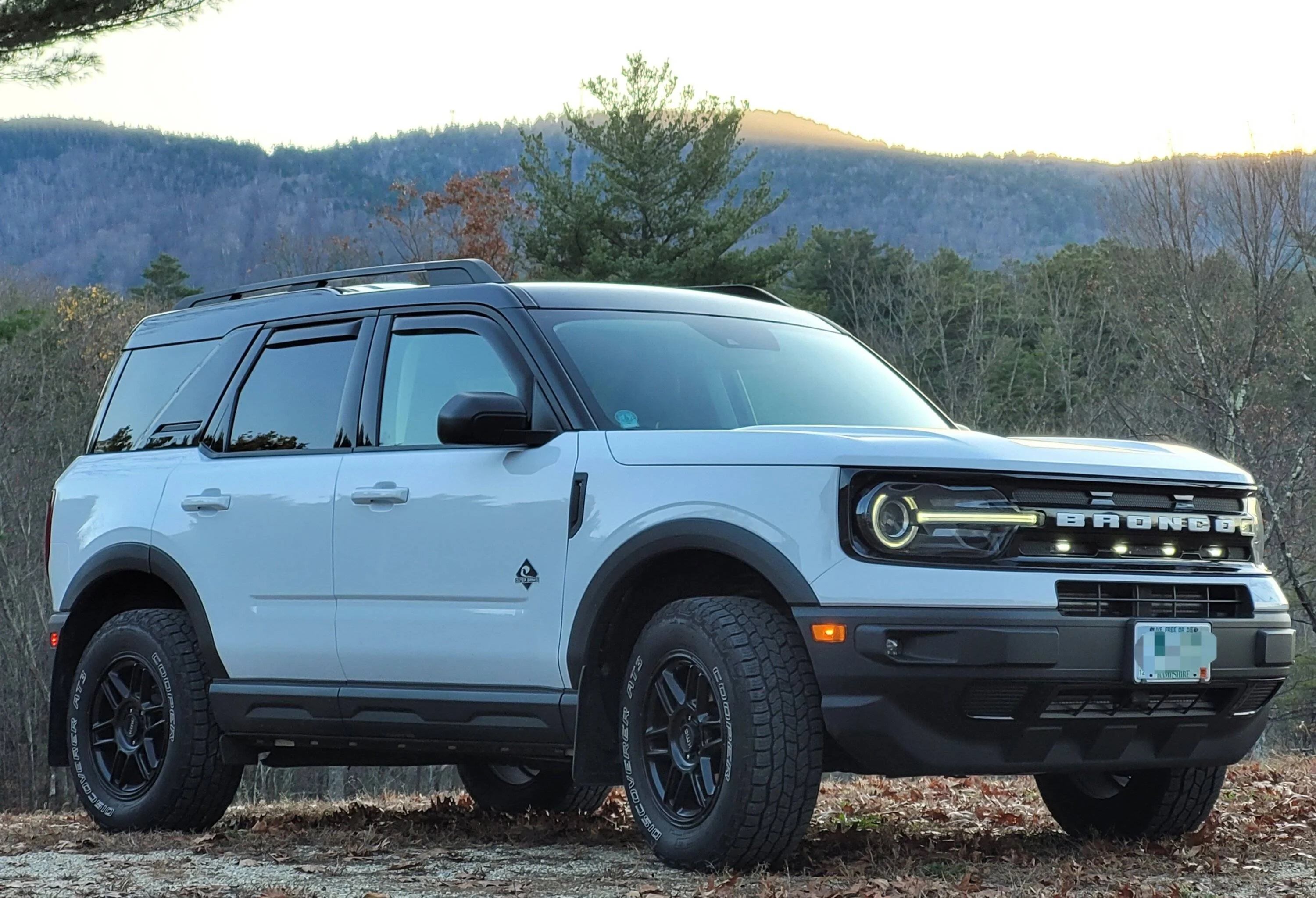

I wired mine into the cabin fuse block #3 with a switch under the steering column. That way they are on when the engine is, with the daytime running lights. And I can turn them off if I want to. Really glad I did it that way.
Ford Bronco Sport Raptor grill accent lights 20221103_170010
Thanks, red wire to the fuse then black wire to ground ?
