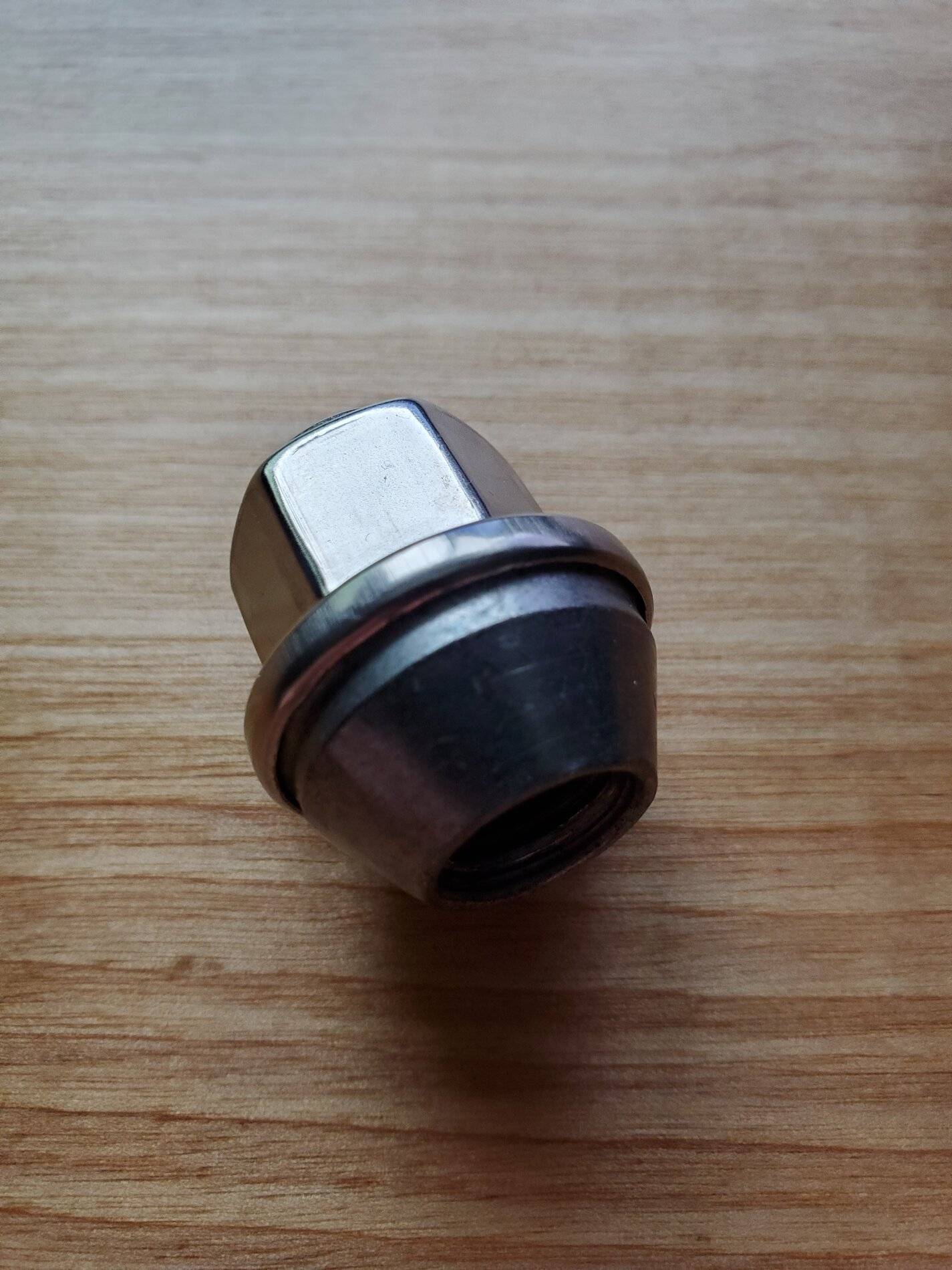

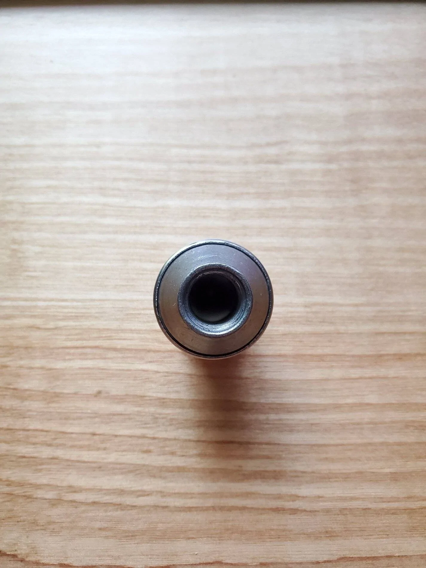

  1. Improved design - this replacement lug nut changes the original two-piece design to one piece for greater reliability Unlike the steel cap lug nuts, our one-piece design doesn’t swell nor delaminate after exposure to moisture. Giving you peace of mind.
  2. Thoroughly tested - part has undergone proof load, salt spray, hardness, and thread check testing to meet strict standards
Amazon purchase For those looking for a reasonable alternative. Hard to beat $21 for a set of 20. Fit no issues. I handspun them on so they all grabbed and threaded perfectly. Used a torque wrench to 100FT/LB Now I feel like I need to use black touchup on the McGuard lock nuts. Not buying matching lugs, already paid $40 through the dealer for those when I bought the Bronco.
For those searching, the Lincoln MKZ premier trim 2018 uses the same fit, not a lot of places carry the Bronco Sport lugs specifically...but it's the same thing.
