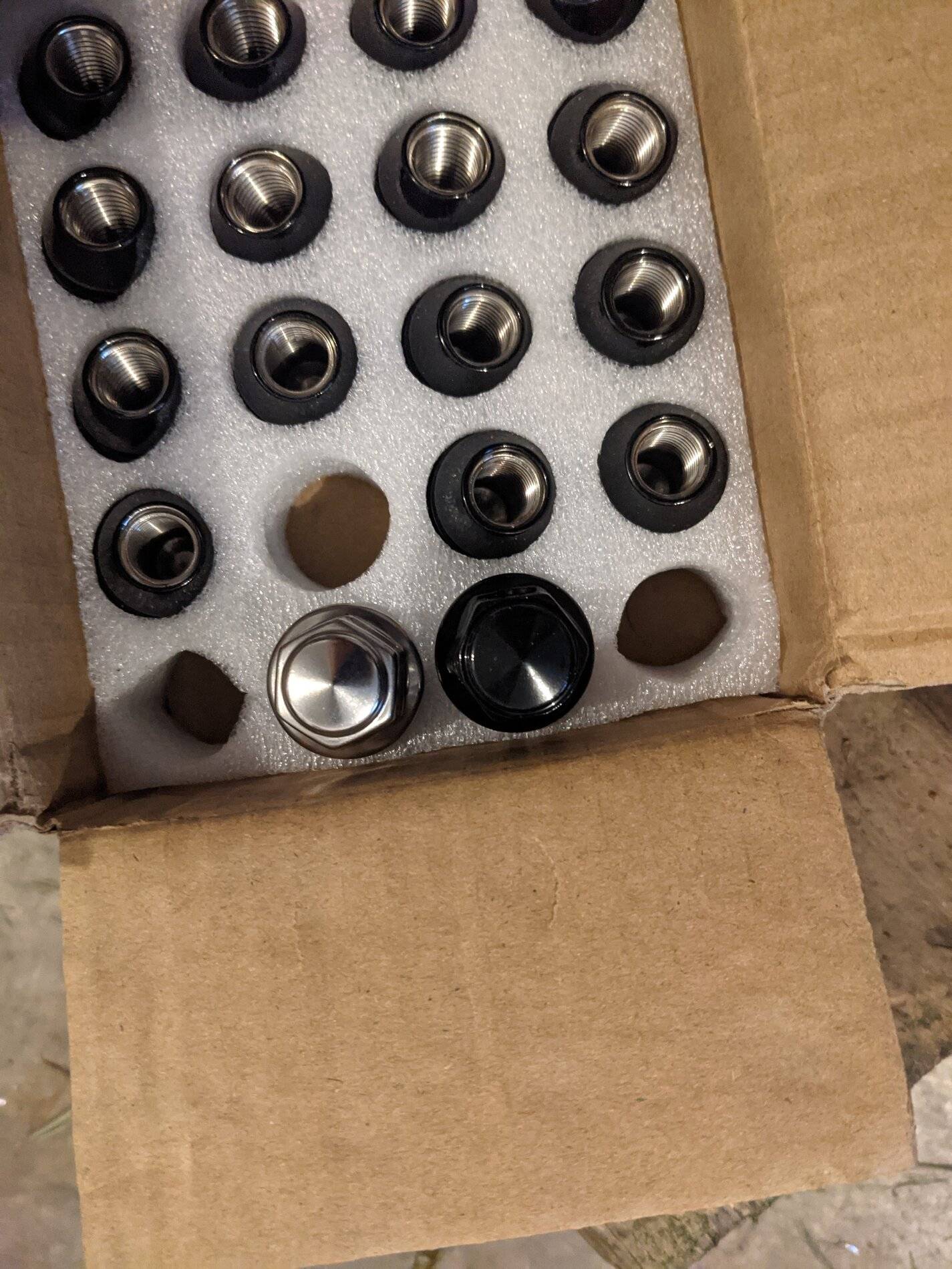

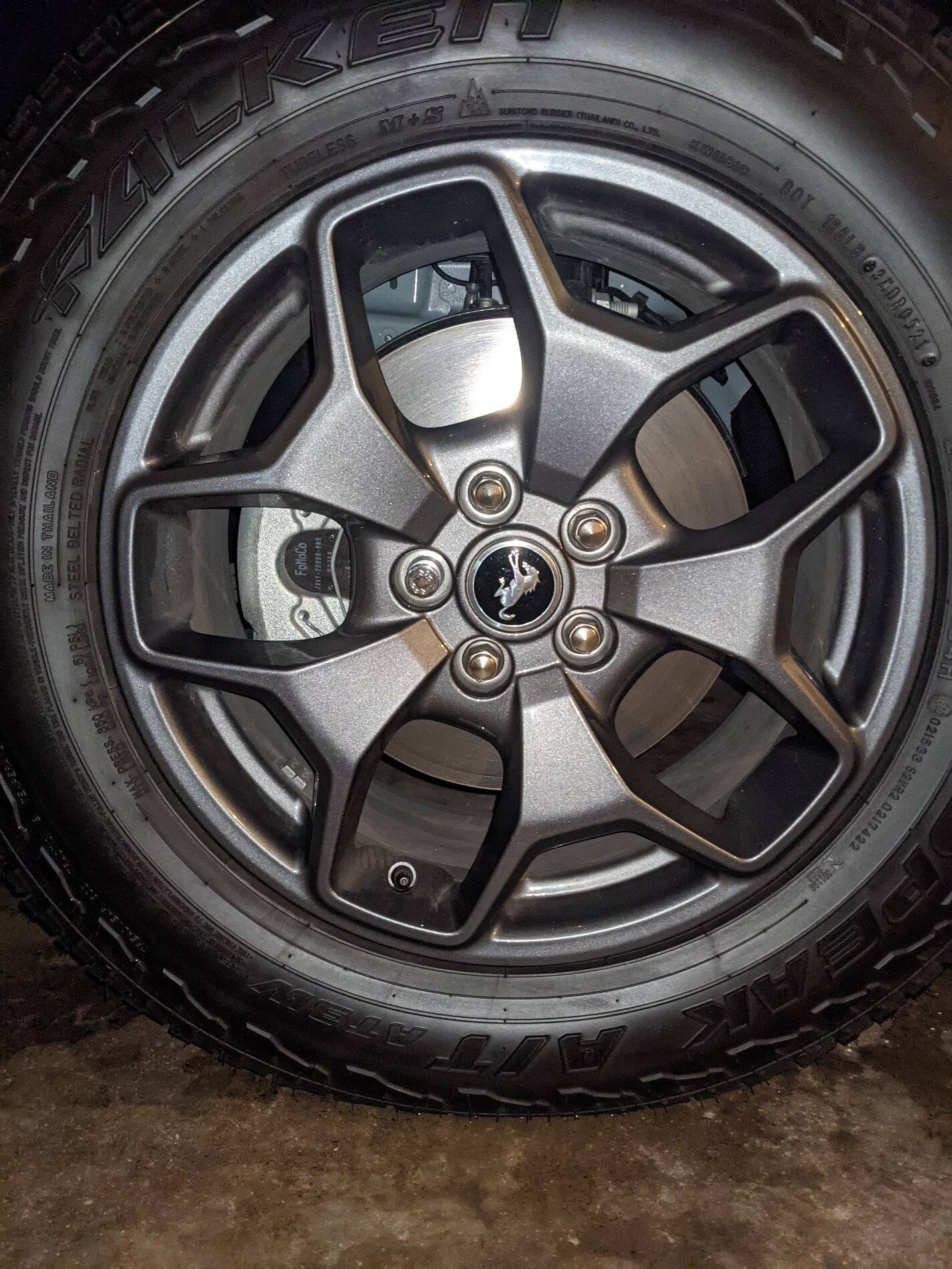

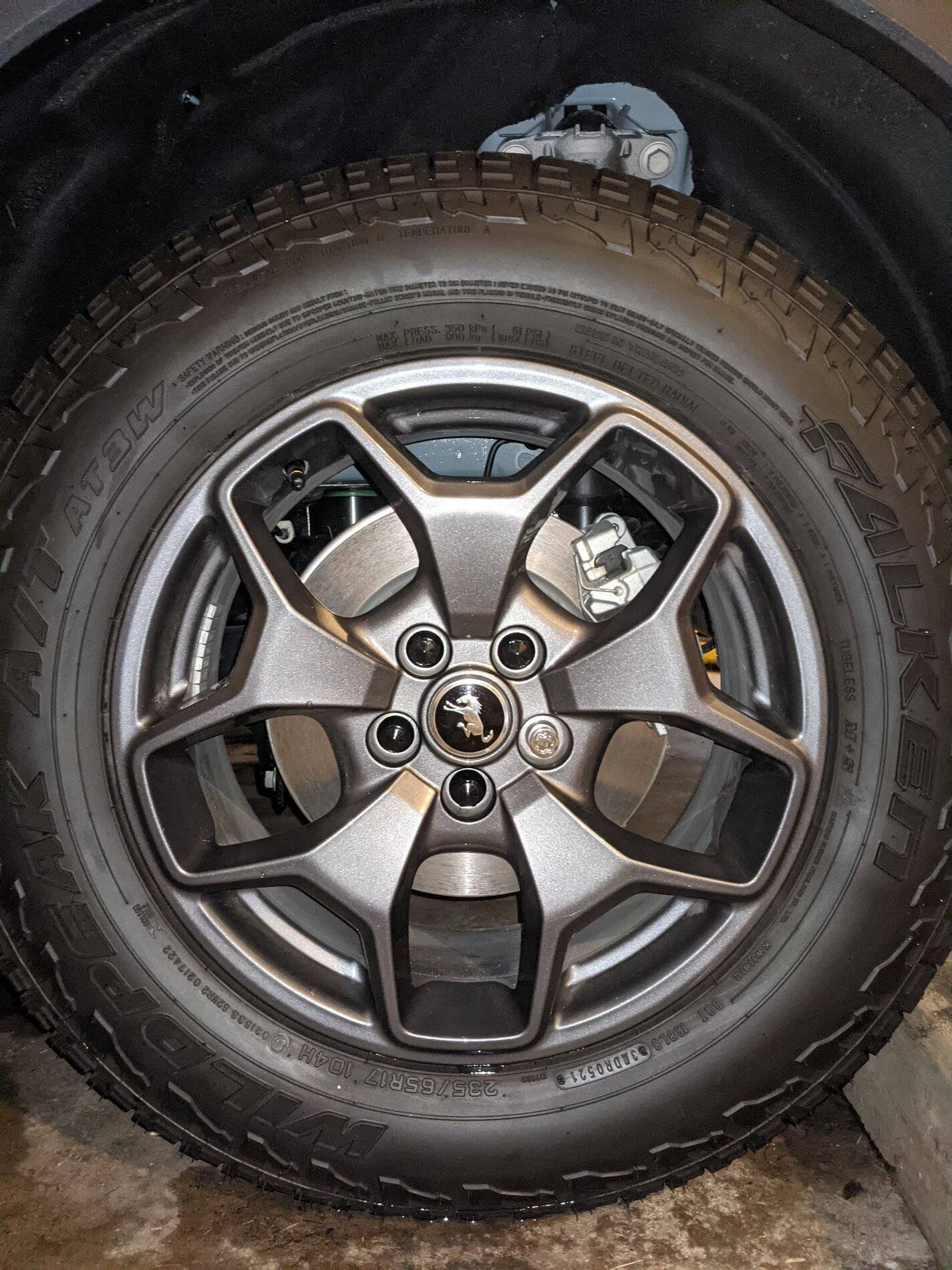

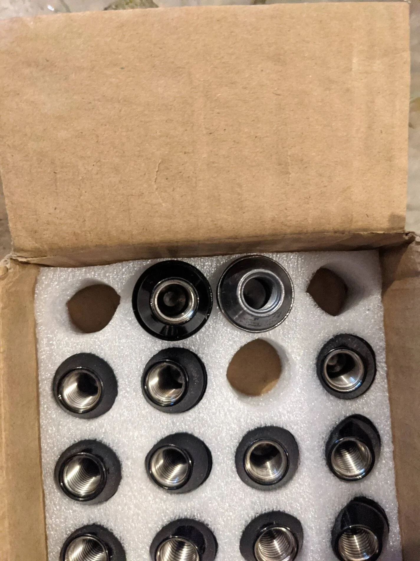

  1. Improved design - this replacement lug nut changes the original two-piece design to one piece for greater reliability Unlike the steel cap lug nuts, our one-piece design doesn’t swell nor delaminate after exposure to moisture. Giving you peace of mind.
  2. Thoroughly tested - part has undergone proof load, salt spray, hardness, and thread check testing to meet strict standards
Amazon purchase For those looking for a reasonable alternative. Hard to beat $21 for a set of 20. Fit no issues. I handspun them on so they all grabbed and threaded perfectly. Used a torque wrench to 100FT/LB Now I feel like I need to use black touchup on the McGuard lock nuts. Not buying matching lugs, already paid $40 through the dealer for those when I bought the Bronco.
For those searching, the Lincoln MKZ premier trim 2018 uses the same fit, not a lot of places carry the Bronco Sport lugs specifically...but it's the same thing.
Aren't the MKZ M14 instead of M12?
2,766
4,508
Based on the McGuards I bought at the dealership, they cross-reference to 2015-18 MKZ. Some showed as M14 oddly, but I knew the sport was 12M-1.5 and bulge style. Amazon showed fit for the MKZ and after they arrived as you can see it's the same lug as the OEM on my badlands

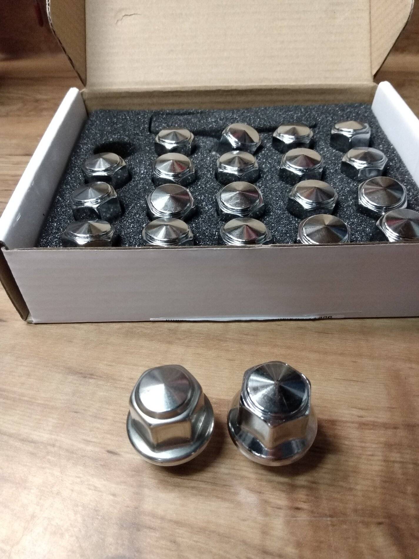

Read through this thread a while ago and I eventually ordered some "Eisen" brand 12 x 1.5 lugs from Big Rainforest. I put them on today. I'd say they are functionally identical. I have to say, I do prefer the satin finish of the stock lugs to the pure chrome. But interestingly the stock lugs are like 18.5mm. Well, they're not a real 19mm anyhow, every 19mm I own is really sloppy on the two piece lug. So is 3/4 equipment, and 11/16 is too small. The replacement ones fit 19mm with no slop. If you look close, you can pick out the original with the different finish.
Ford Bronco Sport Lug Nuts IMG_20210620_205240446
I'm thinking in the Pacific northwest this was a wise move.looks great. Honestly I doubt you can see a difference on the wheel.
