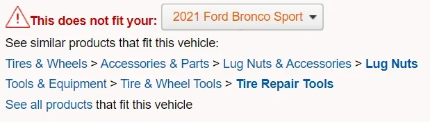

Using the check fit , it reads they don't fit the 2021 BS.
Mine said the same, but it's the size from the manual and my BS is running down the road just fine with them installed. The BS is new enough that I don't think amazon the right sizes yet.

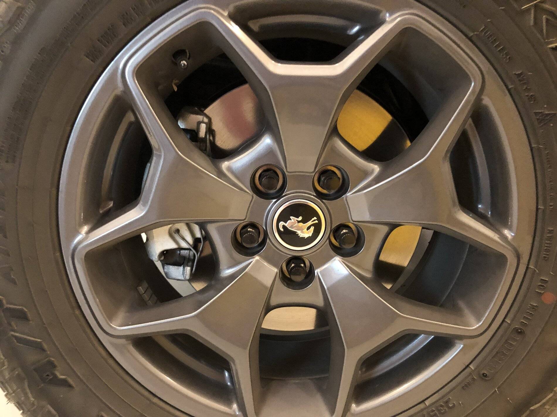

Nice, they seem like quality lugs from what i'm reading online. Looking at the McGard website it lists them for the 2020 escape so I'm not shocked that they fit perfectly here given what the BS is built on.
Only thing I see noted on the McGard site is it states this:
"Notes for: 2020 Ford Escape
Lug nuts will not fit OEM lug wrench.; Not for use on steel wheels."
Is it referring the wrench with the spare? Also I tend to put winter tires on steel rims so I assume I'd need a separate set of lug nuts?

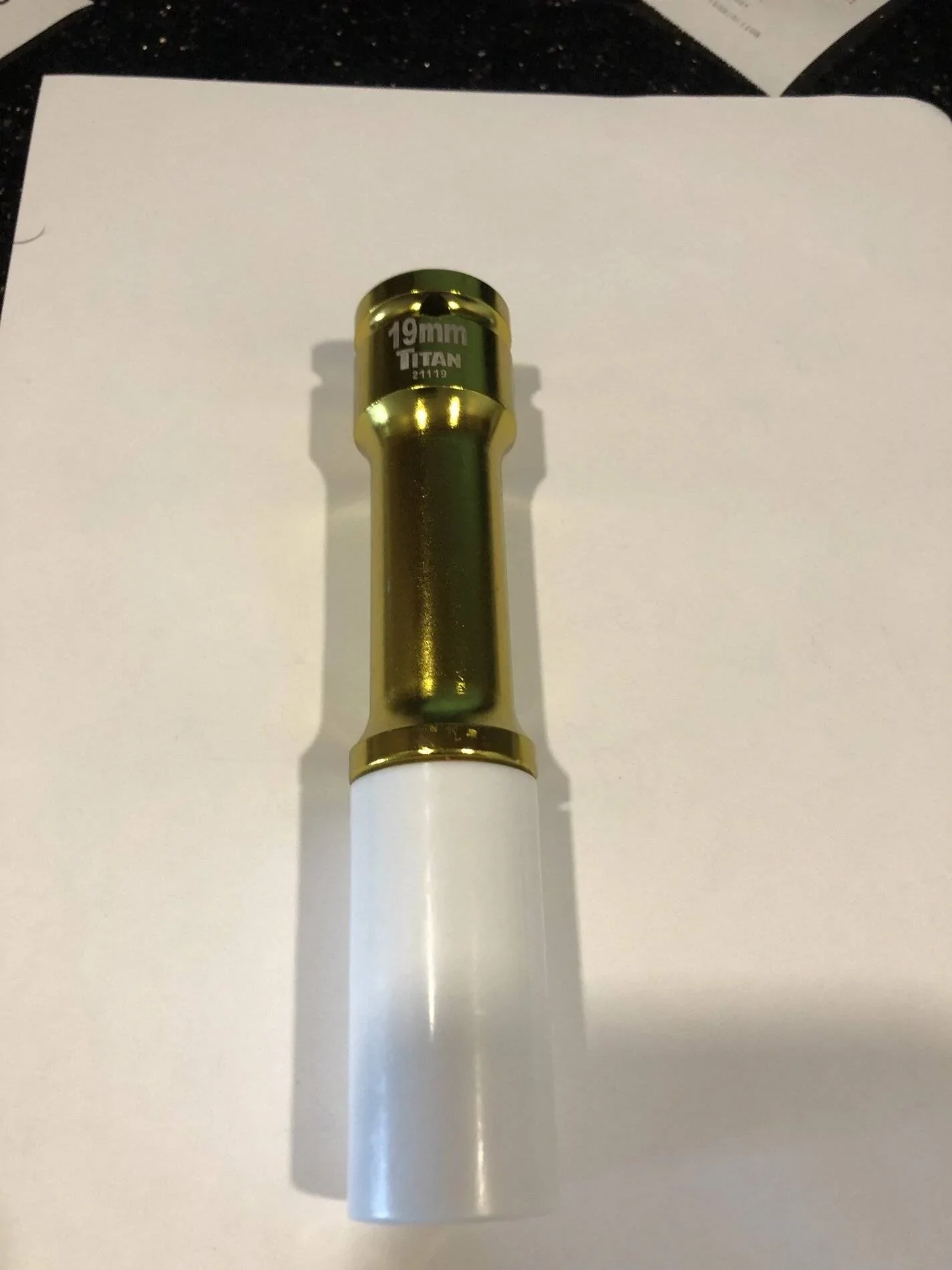

19mm vs 3/4" McGard covering their butt on the wrenches. 3/4" = 19.05mm
I personally have never trusted spare tire kits. I carry a 18" x 1/2" breaker and a 19mm long socket for the tire wrench.
The lug nuts are made of black chrome, not steel so another cover their butt, for that big guy that doesn't have a sense of strength.

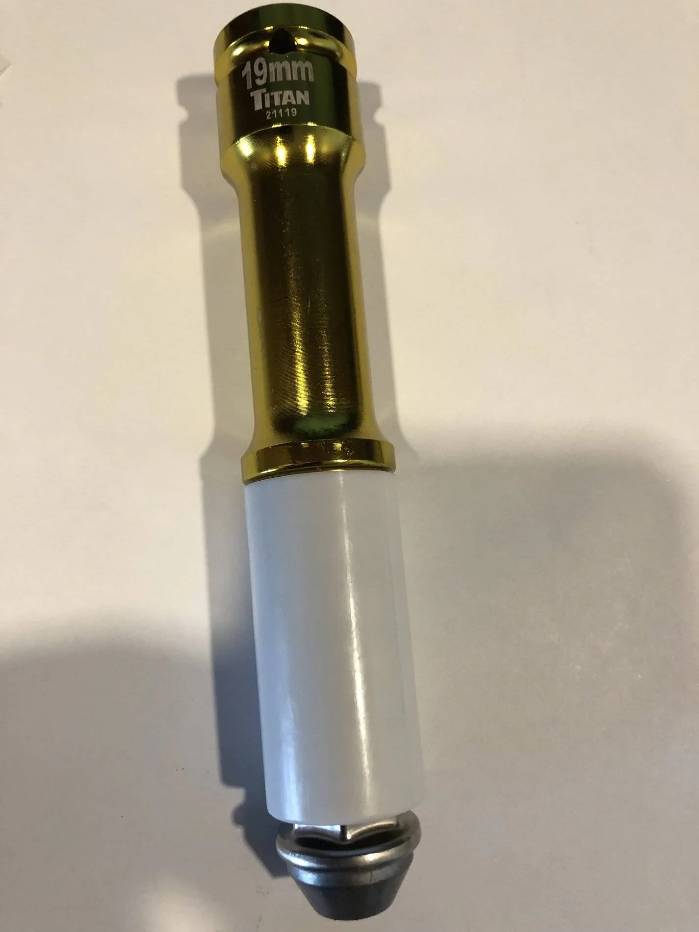

The factory lug nut shown is a bit sloppy in the socket, but it would work unless the cap is damaged.
