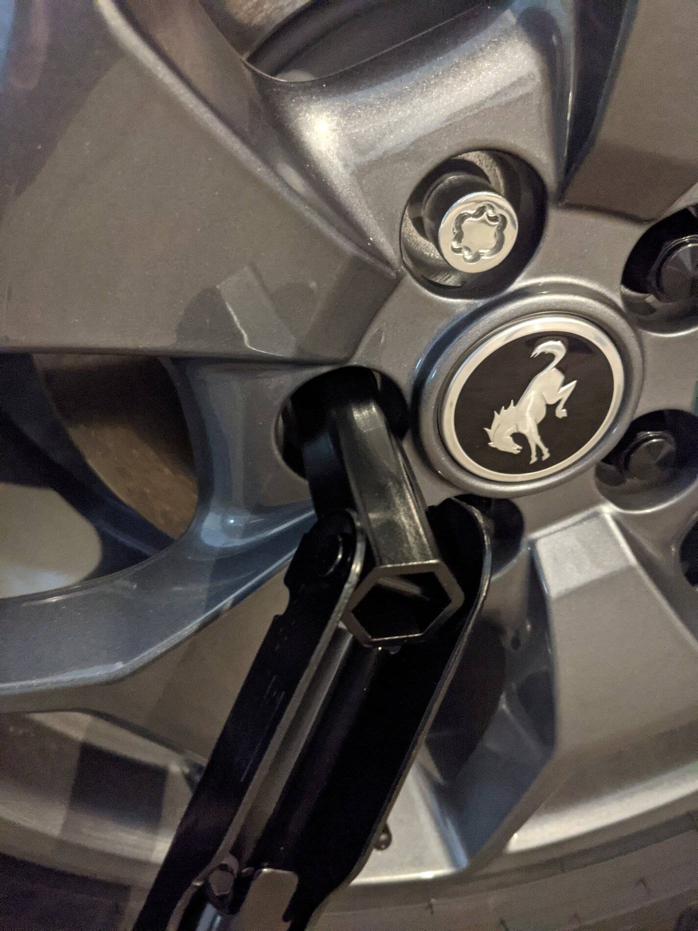

We get rain when it isn't a drought, but only a bit of snow in the valley that quickly becomes an ice rink. They use glycol but are very sparing with the salt, only recently they use it on a few hilly stretches of road in the state. I'd rather stay home on the ice days, 4x4, AWD or not. I don't expect a lot of exposure but I like that the nuts are an actual 19mm if only so the guy rotating the tires doesn't round them off.
I've heard some people say the included lug wrench doesn't fit some aftermarket stuff so next time I am in the tire area I am going to see if it is a real 19 or not. Maybe Ford did it for a reason but I couldn't guess why. I could guess money, but what could be saved on a multipiece assembled, nonstandard part like that!

I ended up with 19mm 3/4" and the included wrench fit. I also put a 19mm with breaker bar in the tire area just incase.
