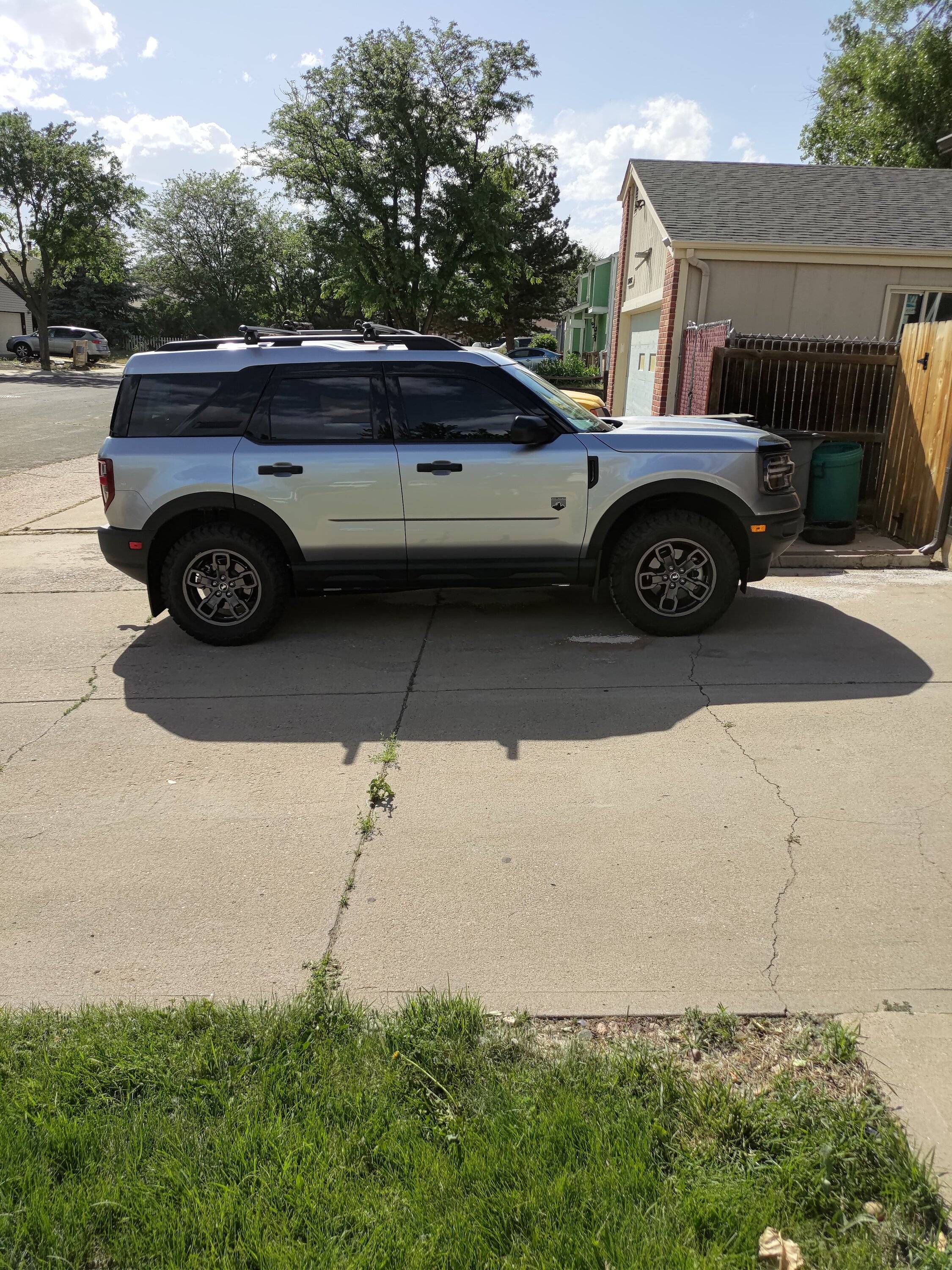

Daystar lift installed. Front poly spacers are not relieved enough. They will make noise in front unless modded. I do not recommend this kit.
