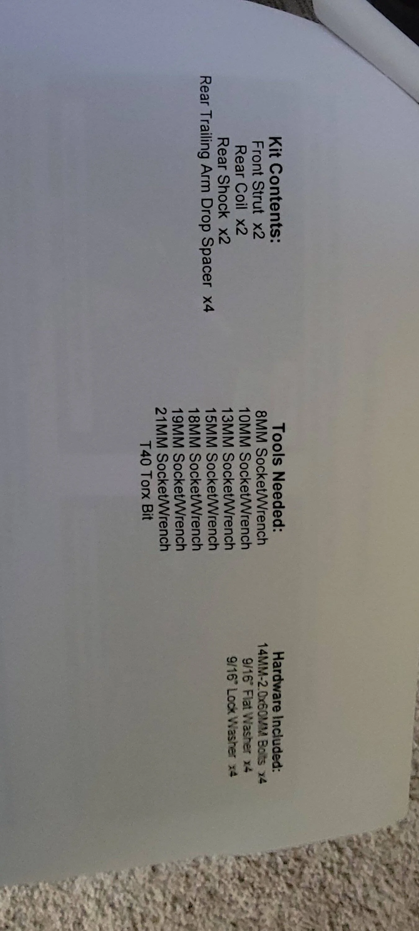

Not the same. The fordrangerlifts kit is using strut spacers, where this Rough Country kit is using new longer struts, new longer rear coils and new longer shocks. not spacers and/or brackets.

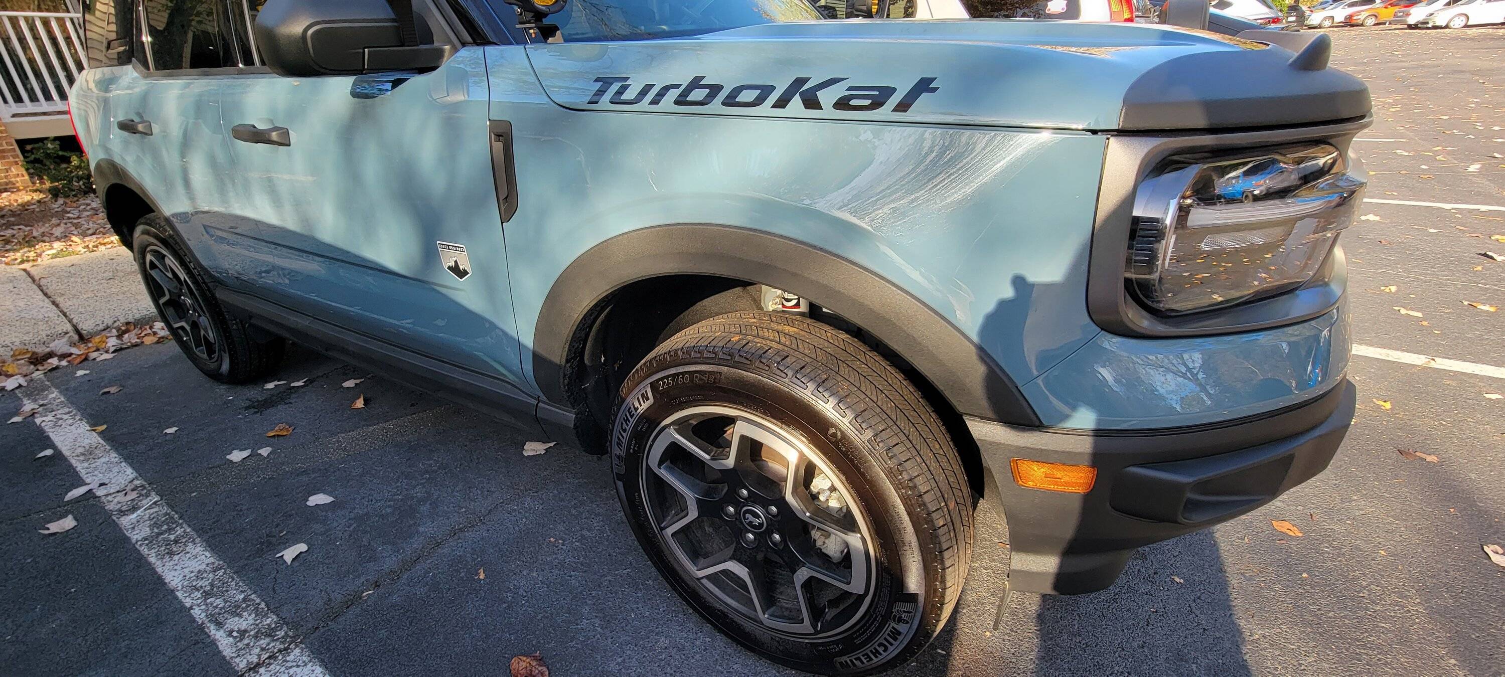

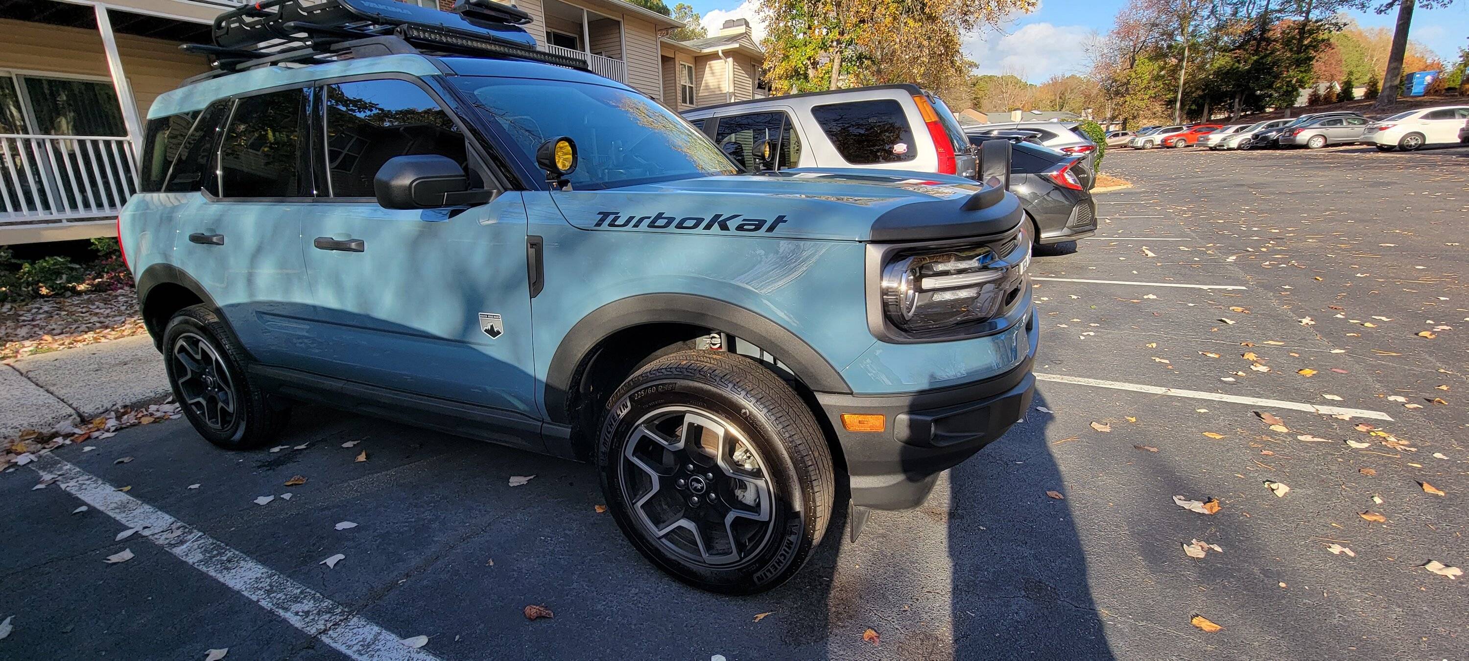

I did a light off road trail a few months ago and did it good, I'm still on stock tires, but the suspension feels good, like the OEM, I can pass bumpers better but, on the road pr highway feels good. I'm planning to test the lift on the sand late this month.

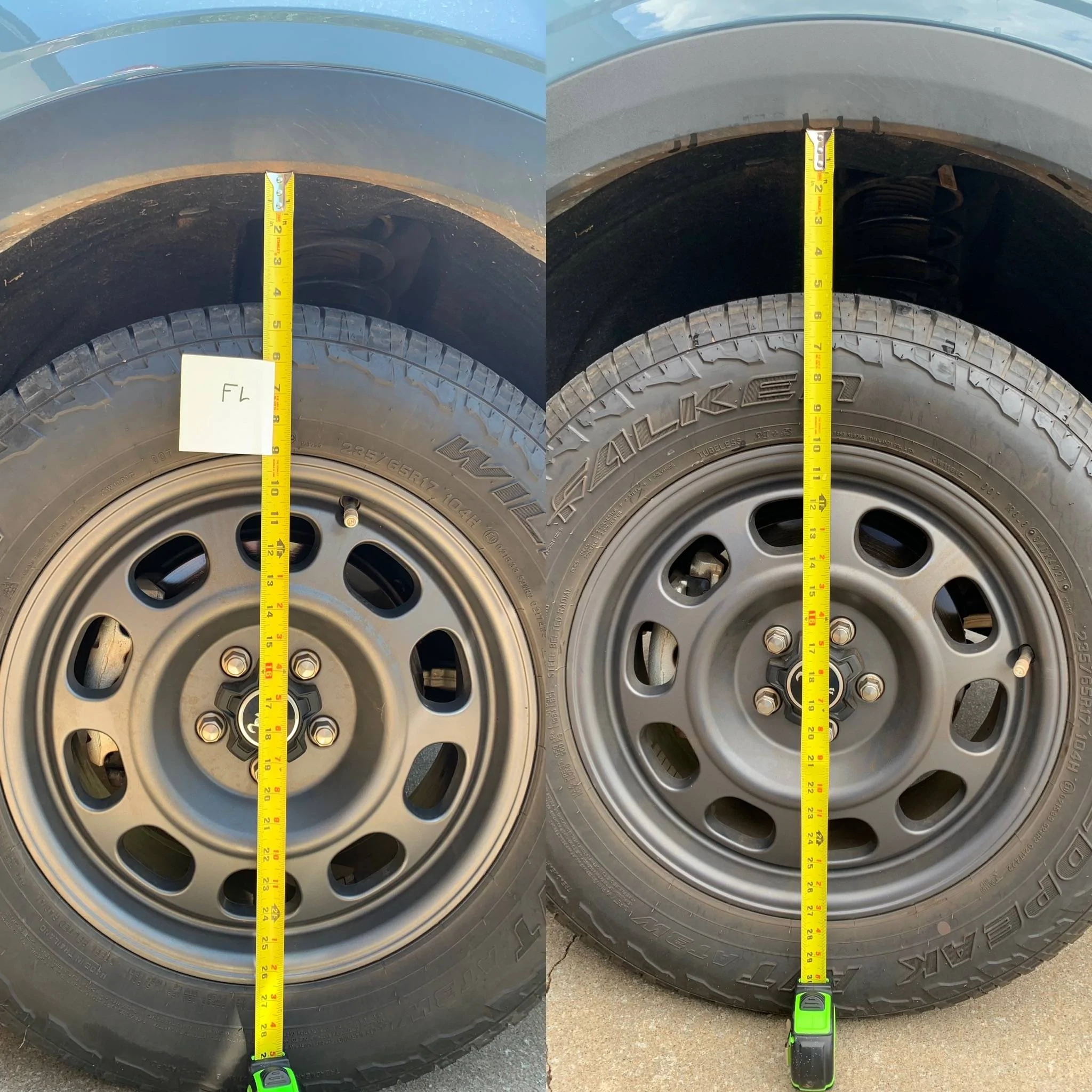

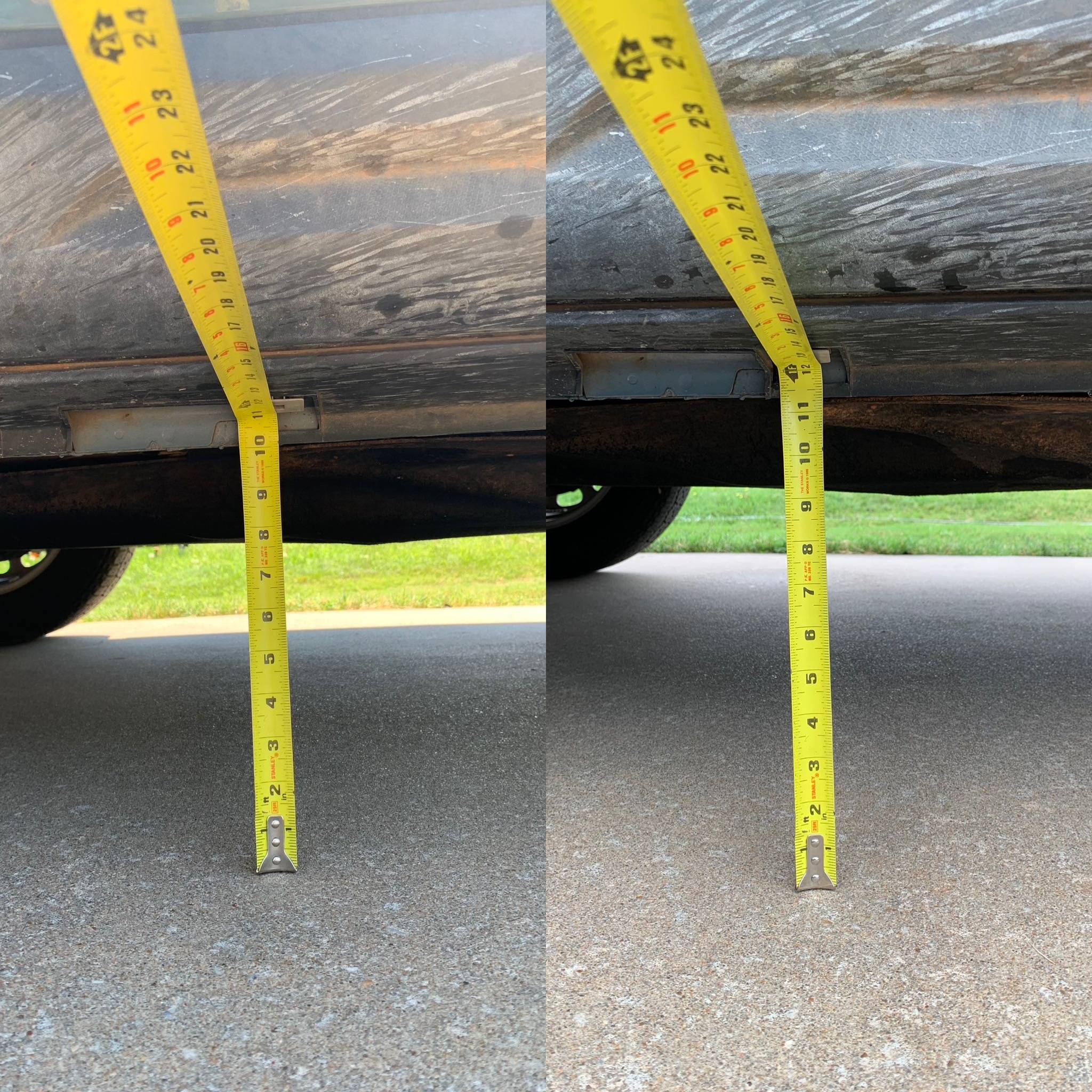

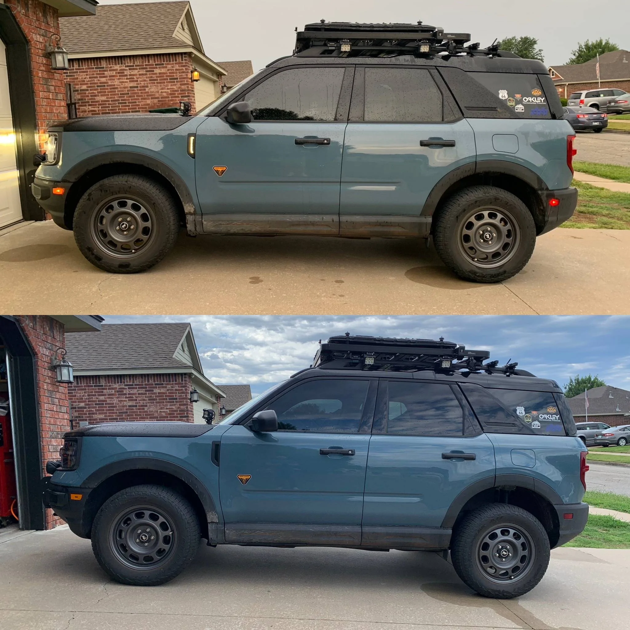

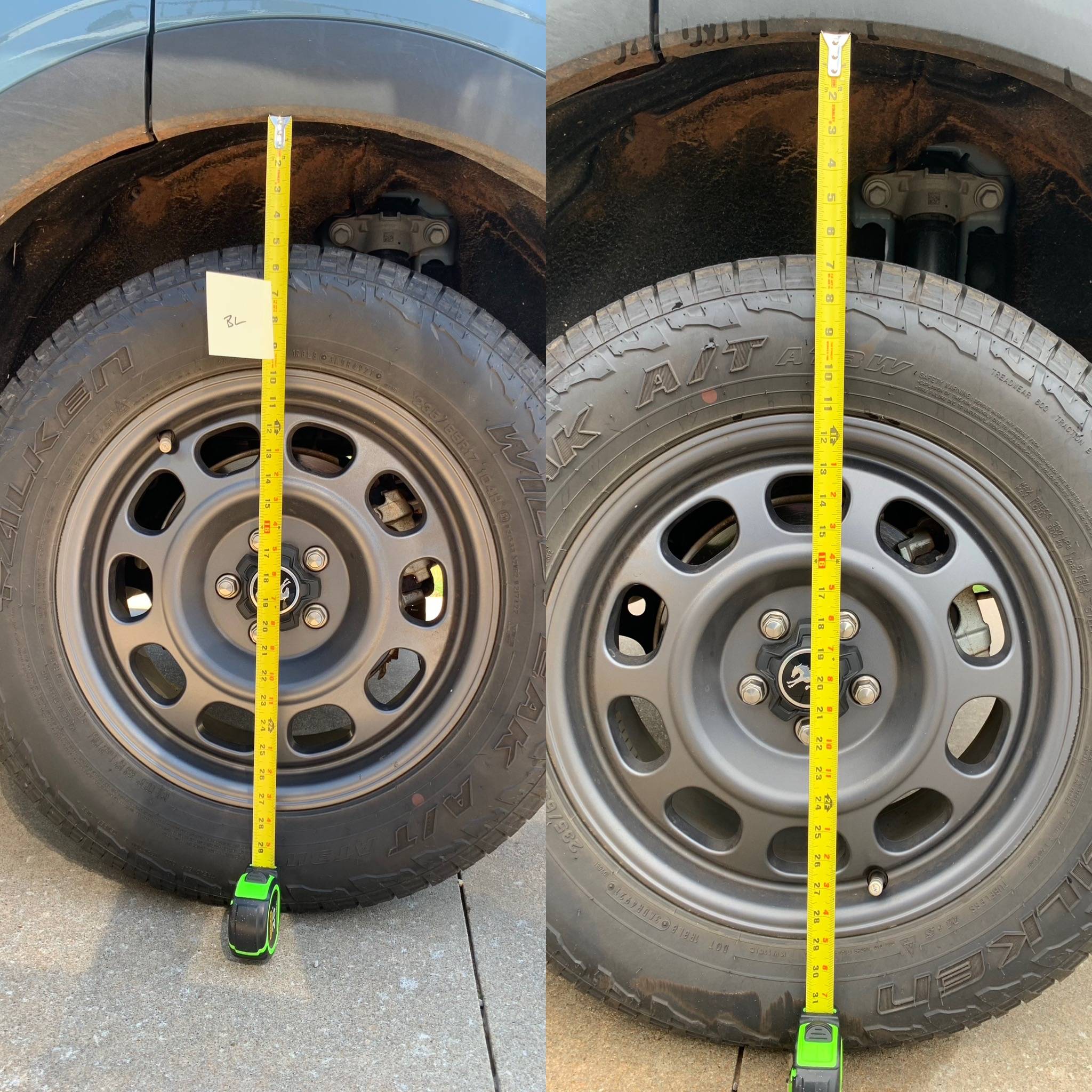

HRG 1.5” lift Badlands before and after pics. Currently 235/65 17’s and went from just over 8.5” to 10” clearance under the gas tank bash plate and the drivers side felt (lowest spots). Pleased with the results, and after about 200 mile (25-80mph), doesn’t seem to handle too much differently.

More people need to create posts of this quality!! Excellent job on the pics and measurements!!

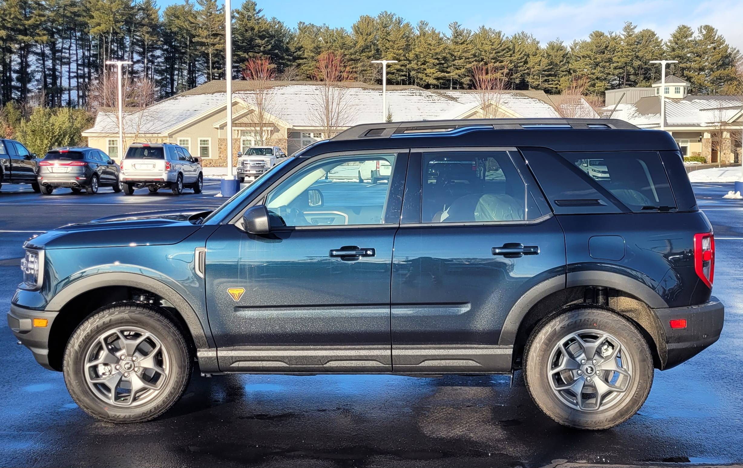

Awesome. I did the same lift on my BL. The gain in the rear was way over what I thought it was going to be for only 1.25"
I think the handling is almost better!
