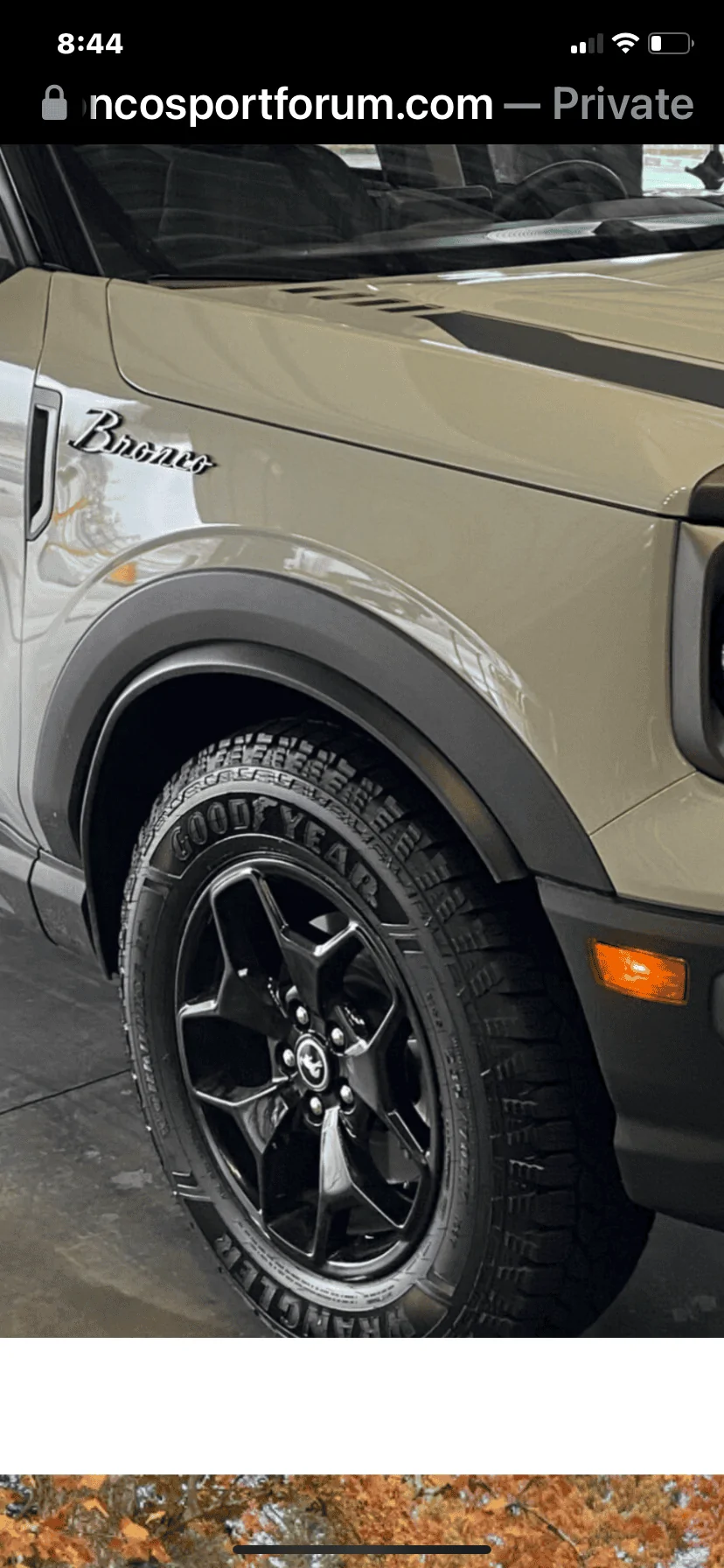

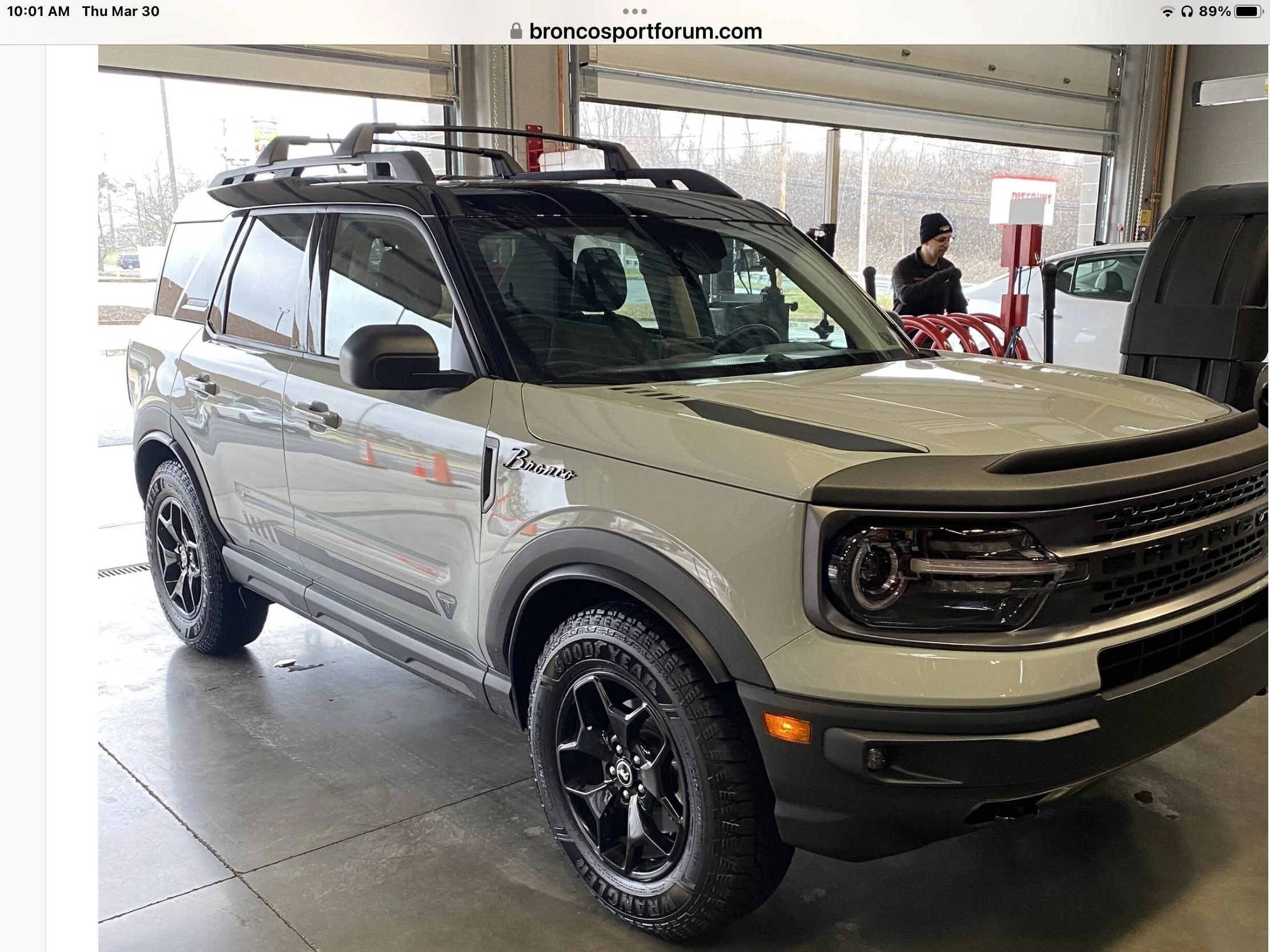

Actually 235/70/17 Goodyear wrangler at 30.2 inch fit my first edition no rub at all .

And you got EZ Flares. I'm back and fourth on that. Don't want to pay $400 for the full set.

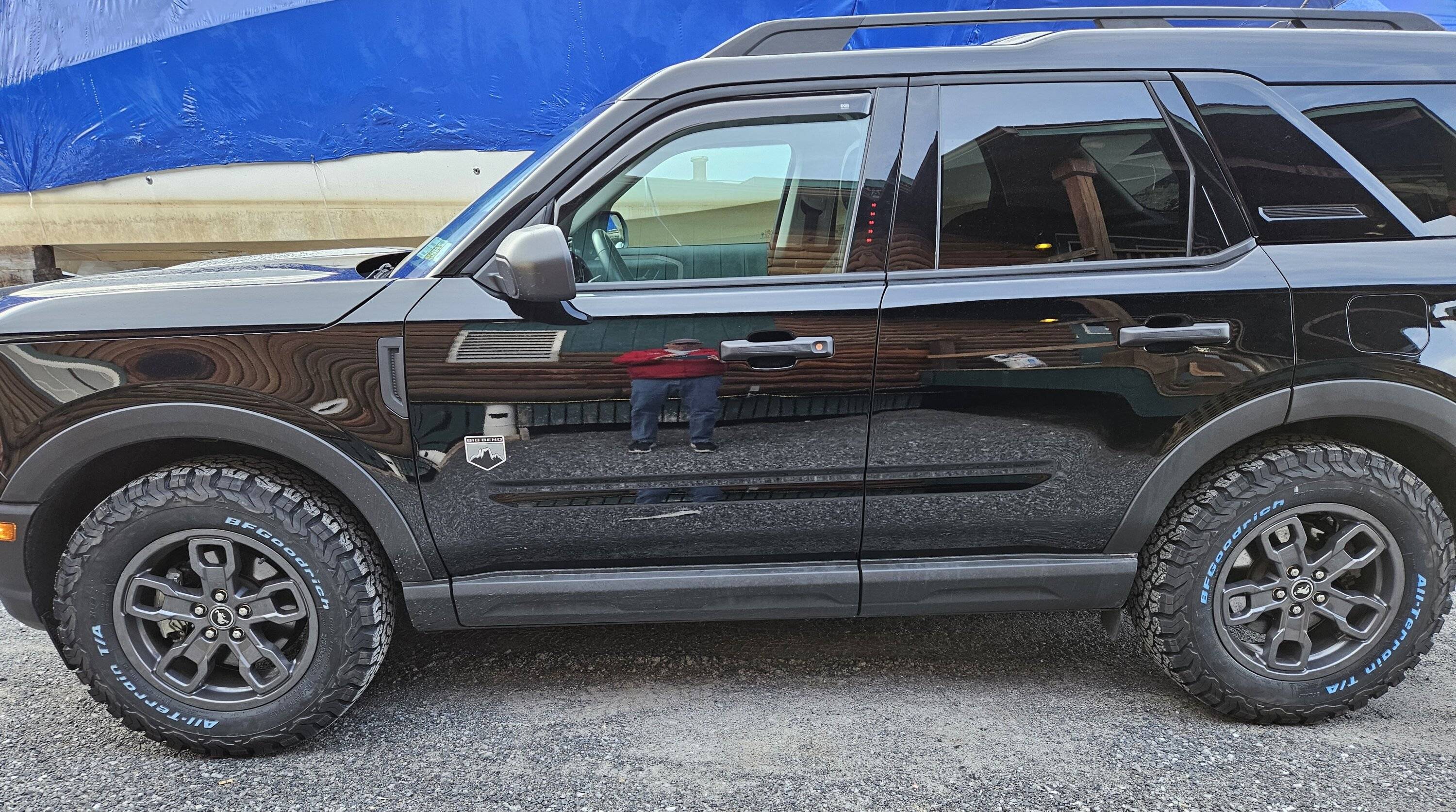

245/65/17 KO2's on my Big Bend. No issues. Speedo averages 2mph difference at highway speeds. No issues with the 1.5l turning them either. I wouldn't take it to a drag strip, but I wouldn't have done that with the stock tires anyway.
