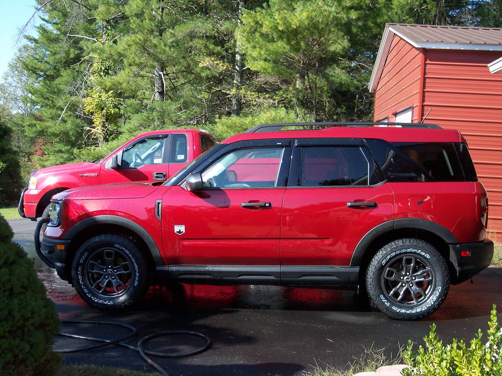

We just put new shoes on our 21 BB/BS, went with 235/65R-17 BFG Trail Terrain T/A's.

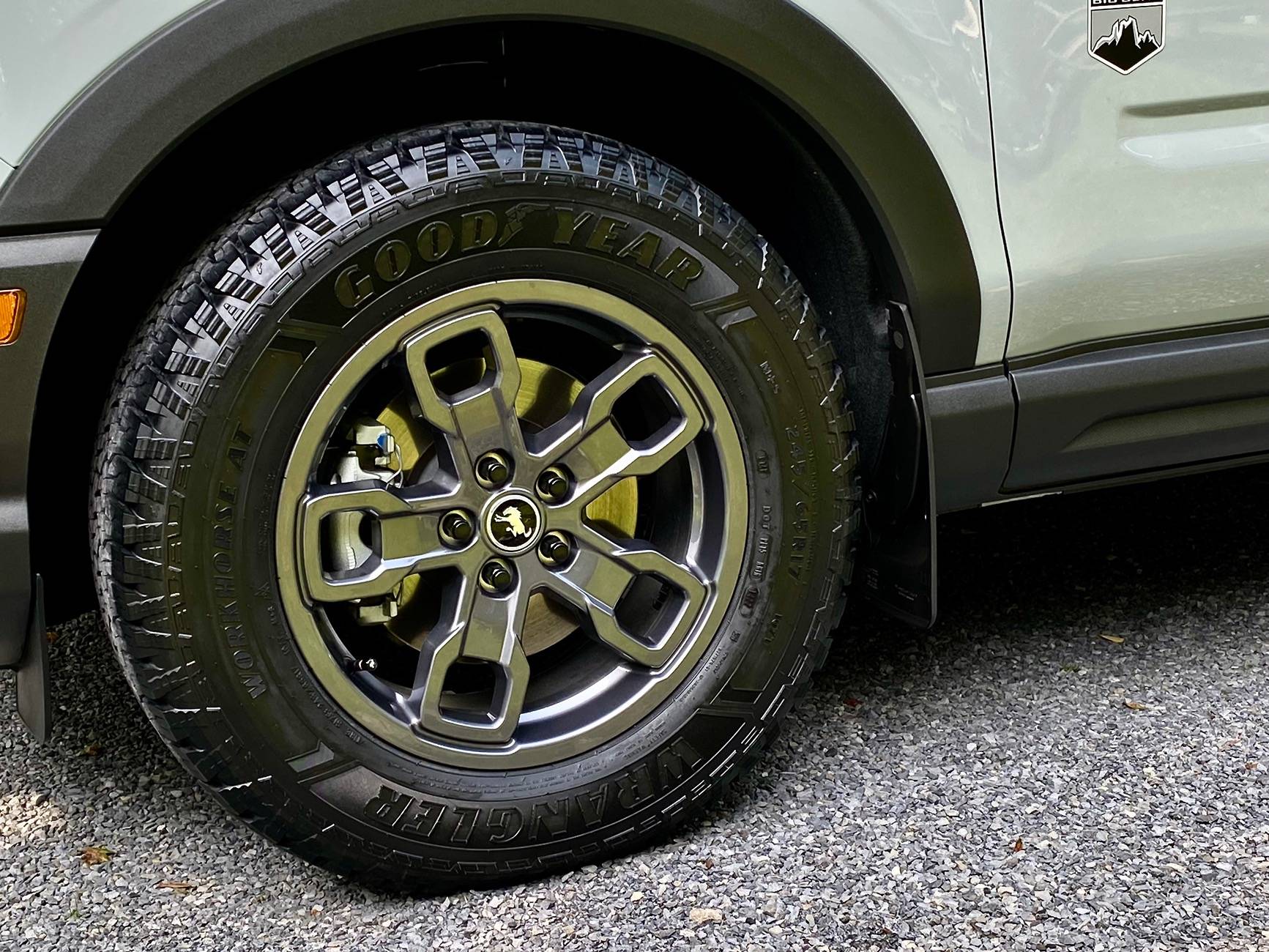

Got you beat by a bit. I have Goodyear Wrangler Workhorse 245/65/17's @ 31 lbs. each. They're the lightest.
