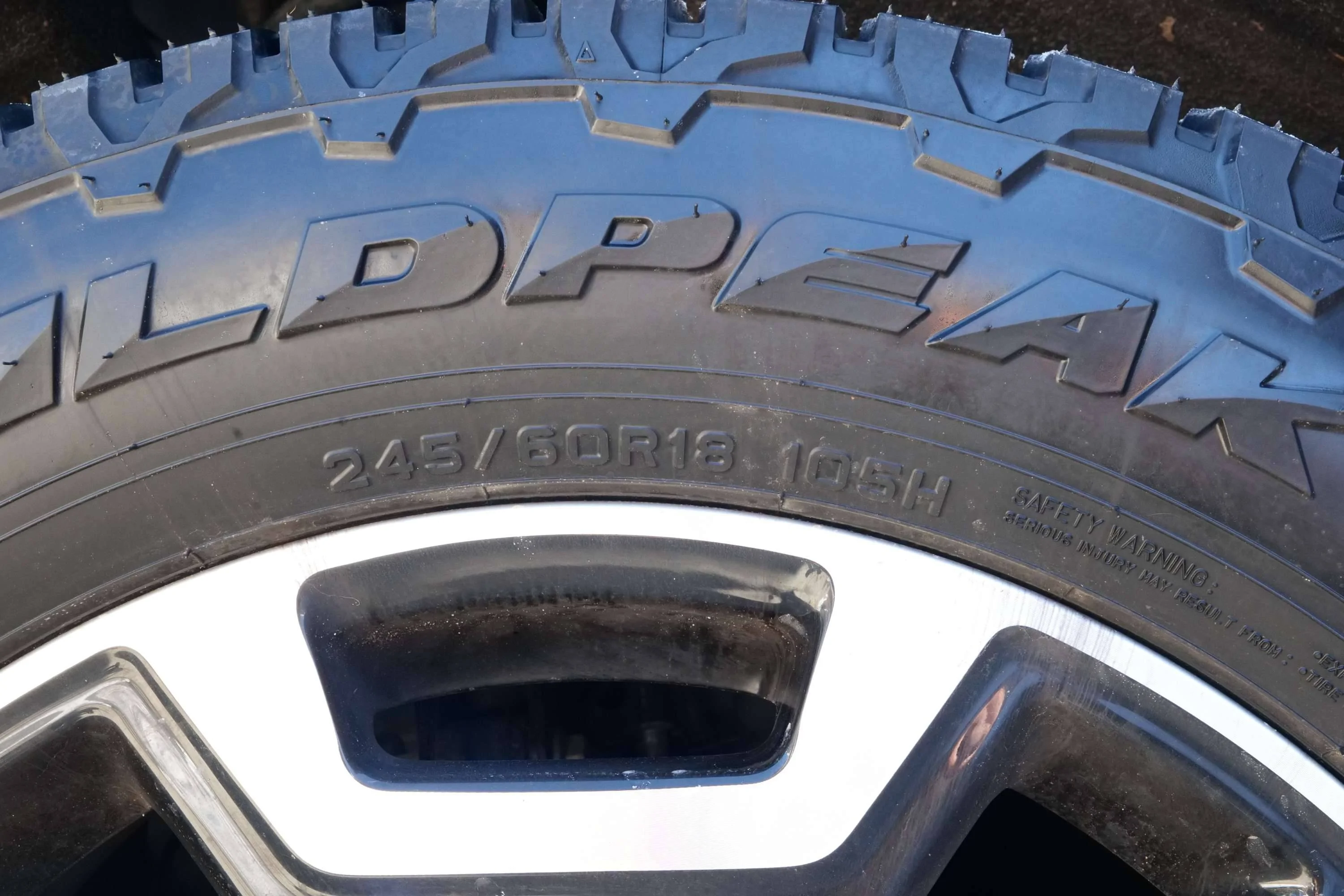

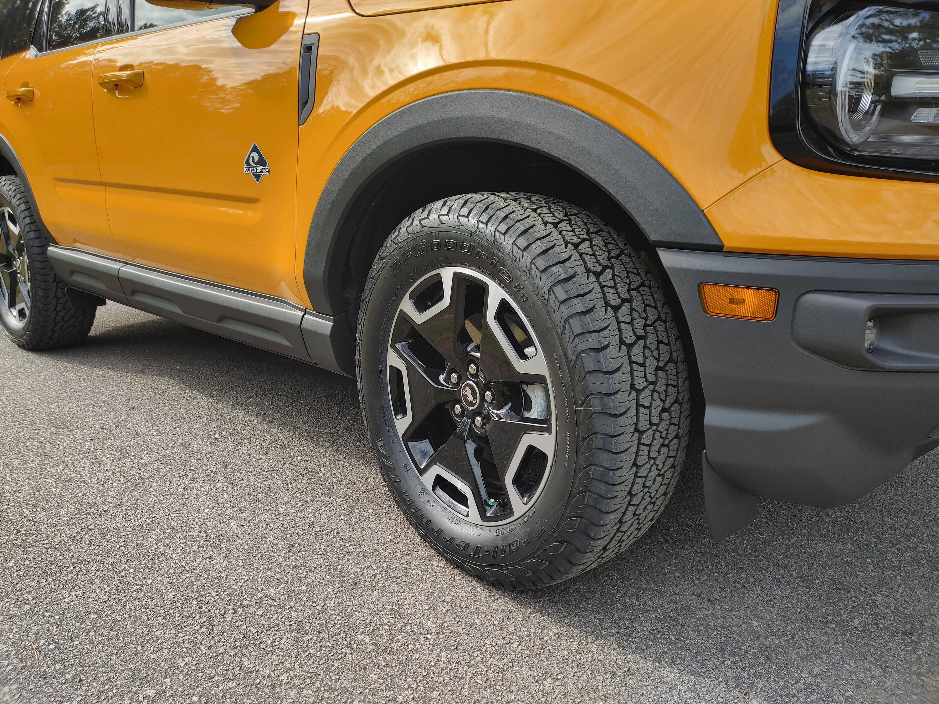

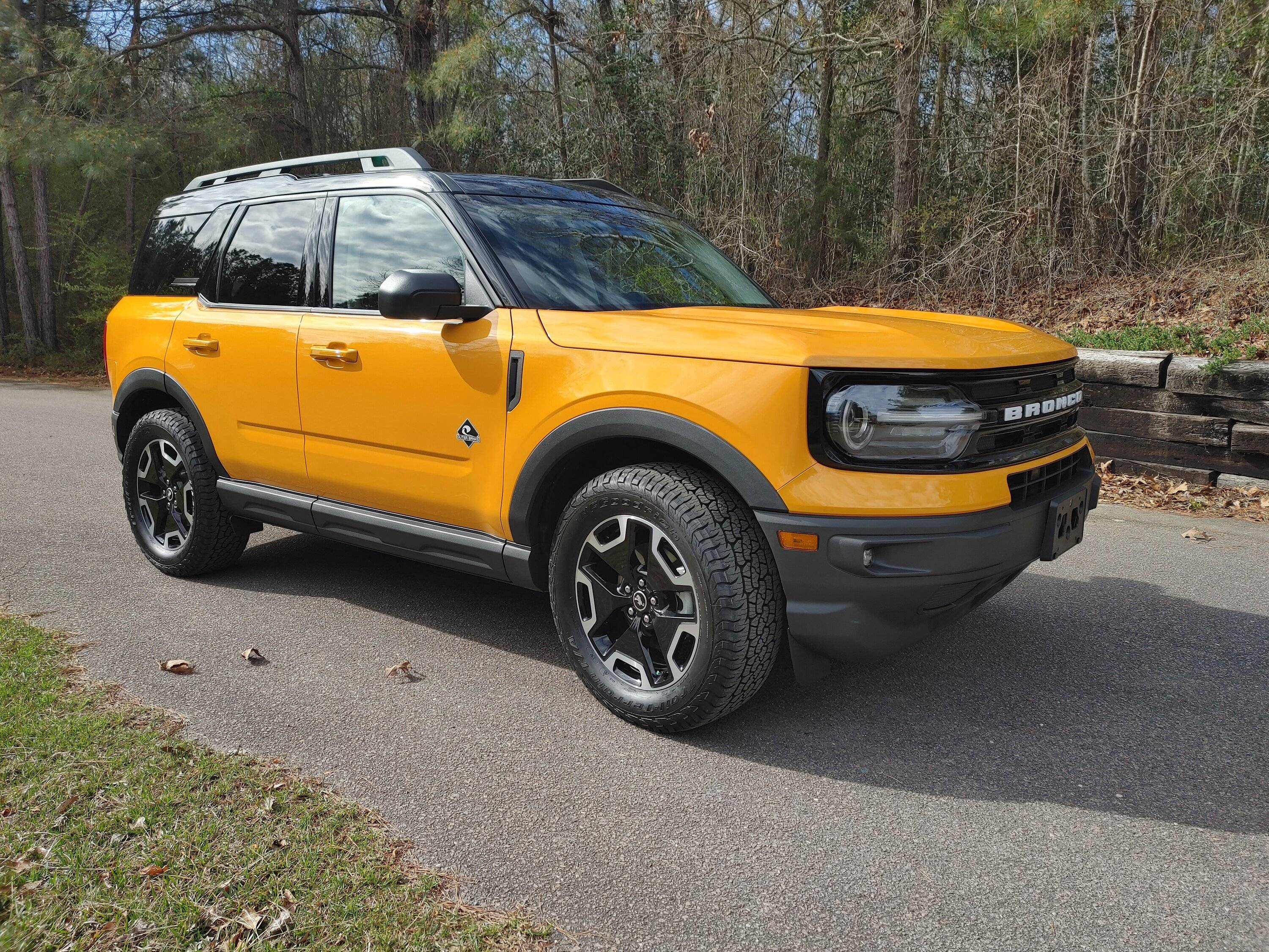

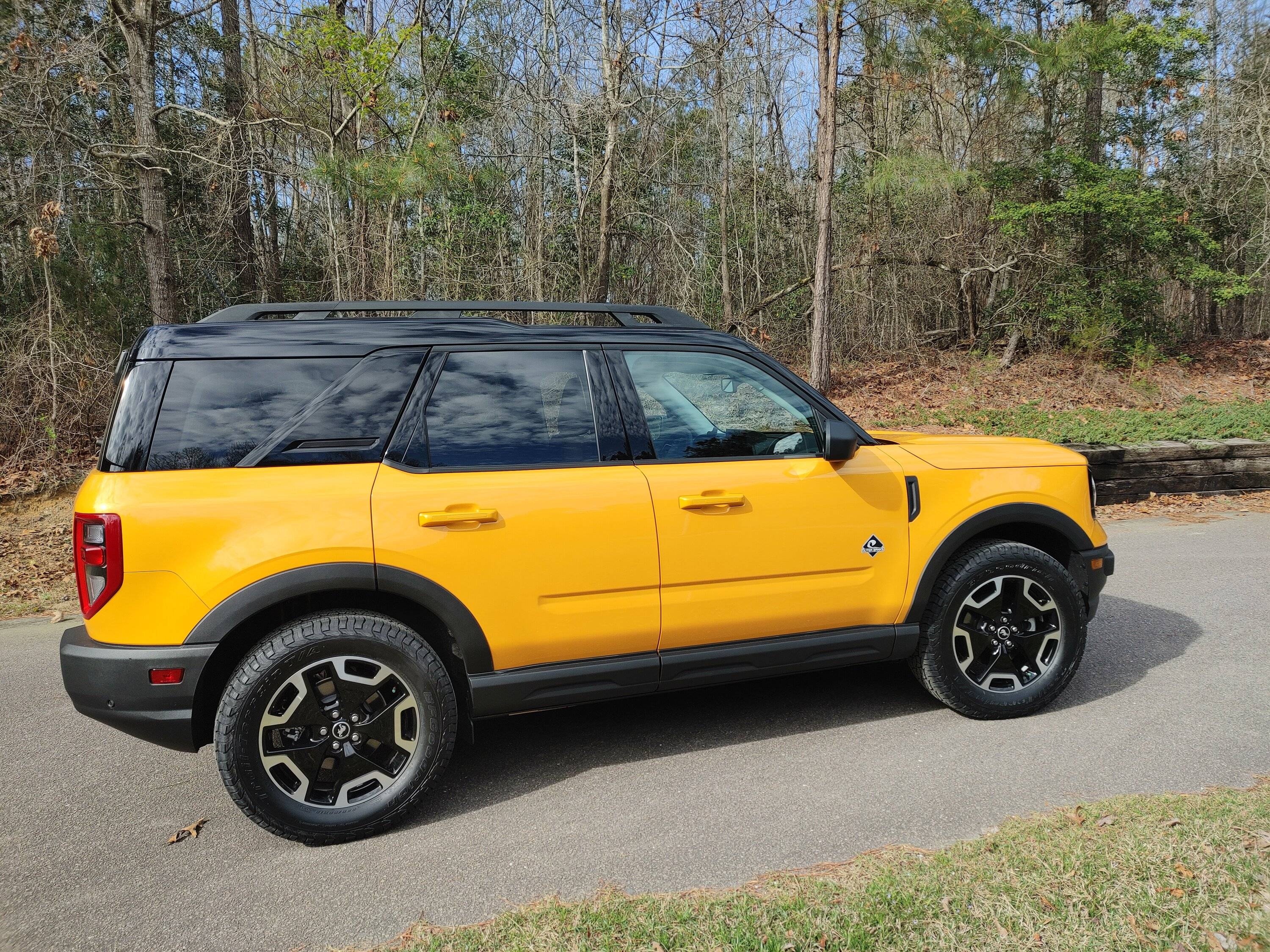

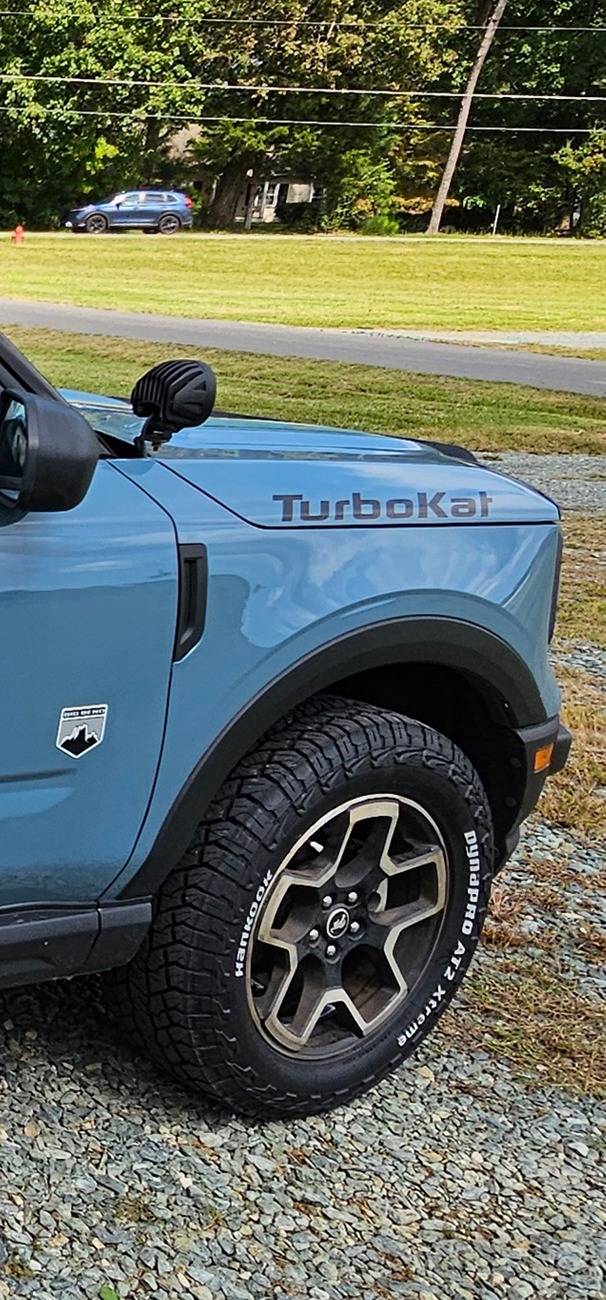

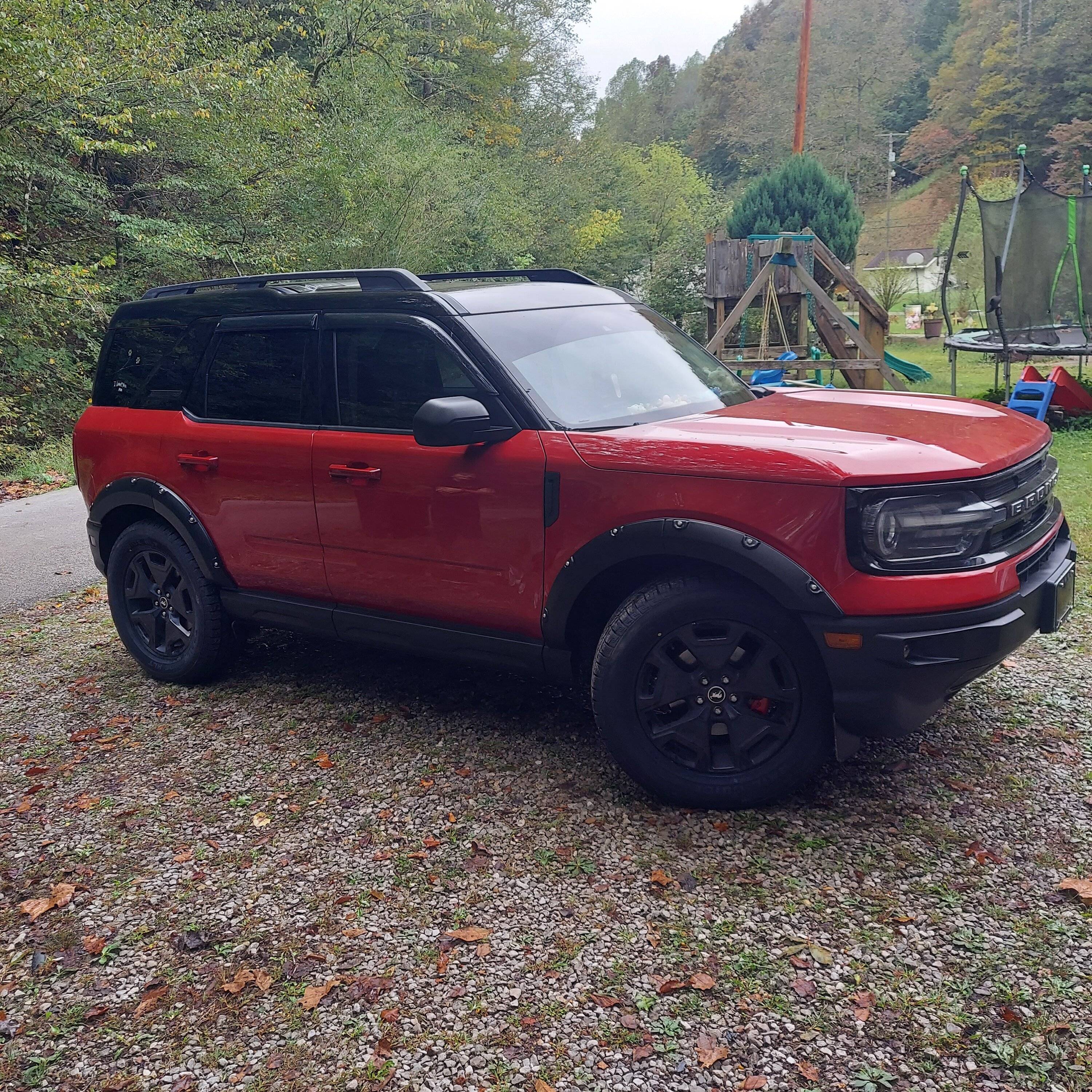

Idk about the big bend.but I put 265/60r18 on my girlfriends outer banks with no rubbing,stock rims
Ford Bronco Sport Largest tire size on 2021 BS Big Bend -- with and without lift kit? 20241002_102355

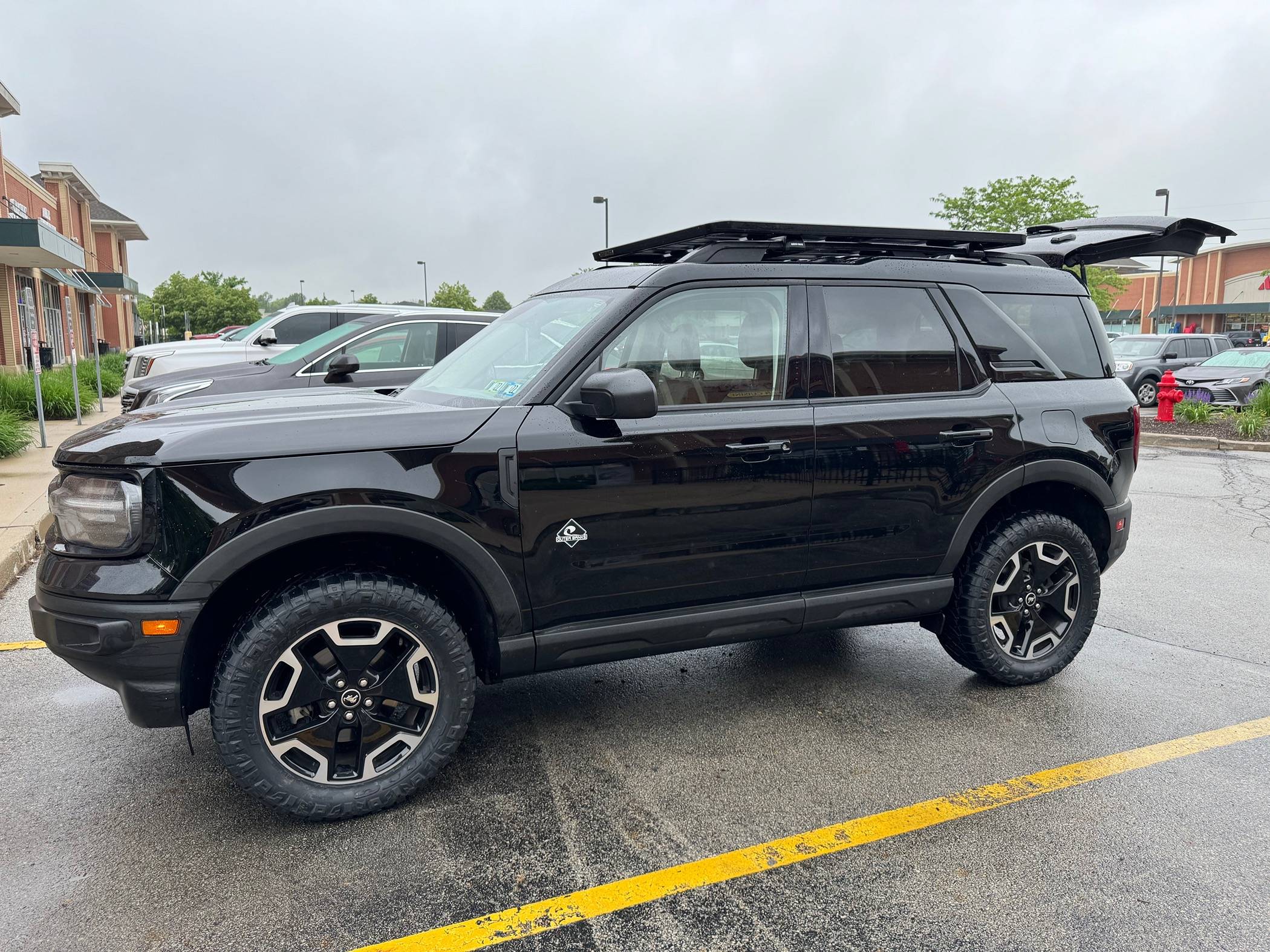

I’ve got Toyo open country at3 265/65R17 on mine with a 1.5” lift and minor trimming. They look great and ride great too, both on and off-road.
Can I ask what trimming you had to do? I just put 255/70R17 and there is some rubbing.

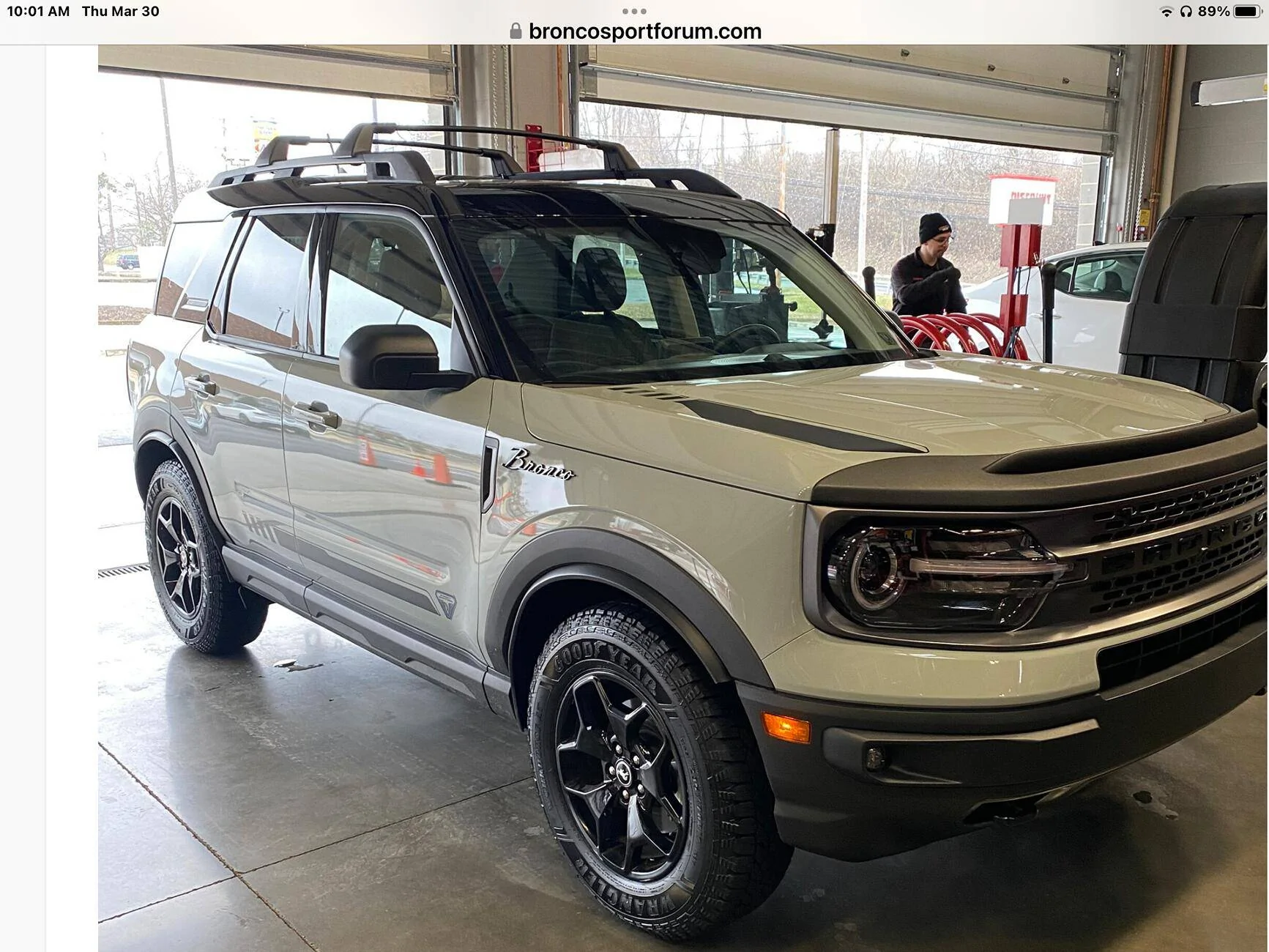

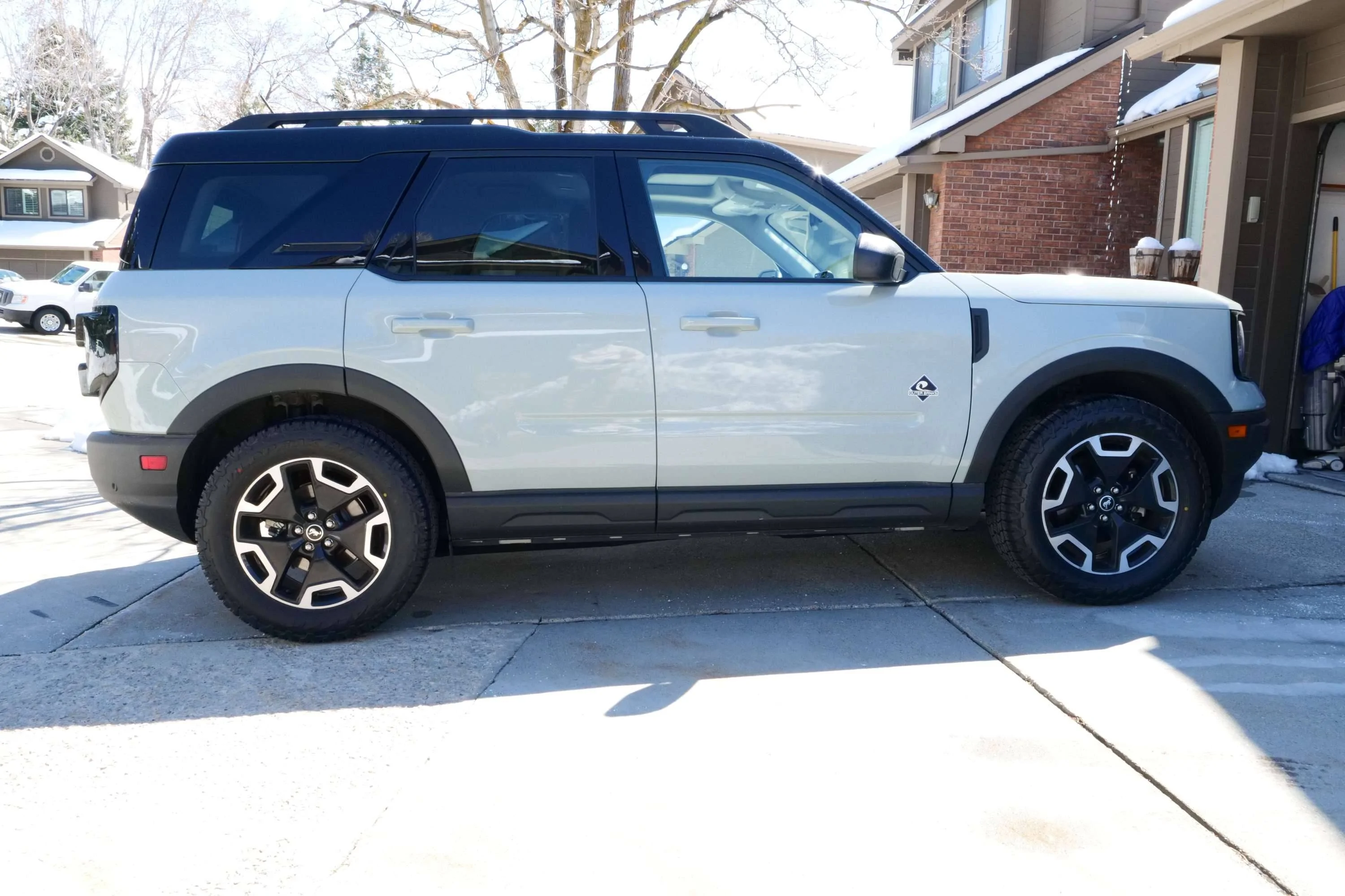

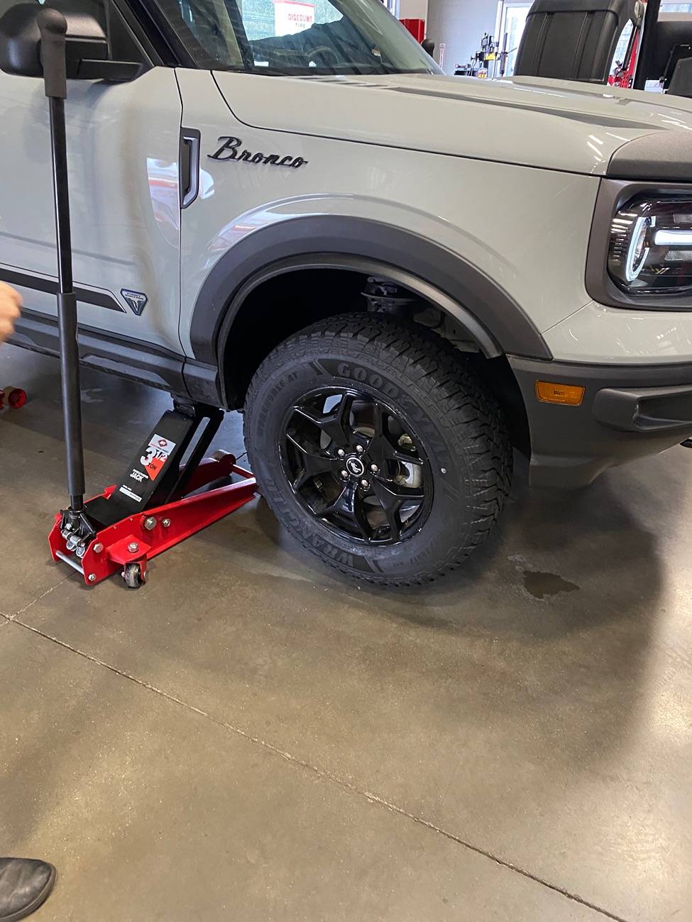

235/70/17 on for 2 years no rubbing Goodyear workhorse at . No lift stock 2021 First Edition , no trimming needed if you stay with a 235.
Ford Bronco Sport Largest tire size on 2021 BS Big Bend -- with and without lift kit? IMG_1048
Ford Bronco Sport Largest tire size on 2021 BS Big Bend -- with and without lift kit? IMG_0813
Ford Bronco Sport Largest tire size on 2021 BS Big Bend -- with and without lift kit? IMG_0796
